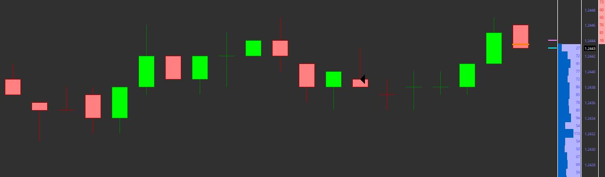

One last question. Is it possible to display the Number Bars study as shown in the attached image ? (Candle in the center, and numbers on the side) It just looks near and tidy.
Thanks in advance.
imageScreen Shot 2018-09-19 at 10.19.26 AM.png / V - Attached On 2018-09-19 19:40:12 UTC - Size: 168.52 KB - 1418 views
[2018-09-20 21:42:41]
No, not exactly. The options that are available are defined here: Numbers Bars: Open and Close Marker Style

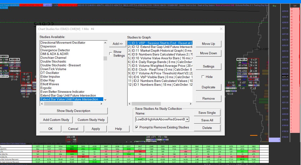

[2023-05-20 09:21:34]
User904434 - Posts: 75
It is not working after adding + / changing the name
imagestudy not w.JPG / V - Attached On 2023-05-20 09:20:32 UTC - Size: 188.79 KB - 520 views
[2023-05-22 14:20:44]
We see the option for "Prompt to Remove Existing Studies" is enabled in the image you provided, which implies that the Study Collection has the correct name. When you select "Analysis >> [StudyCollectionName]" you should be getting a prompt as to whether you want to remove existing studies or not. Refer to the following for how to apply a Study Collection:
