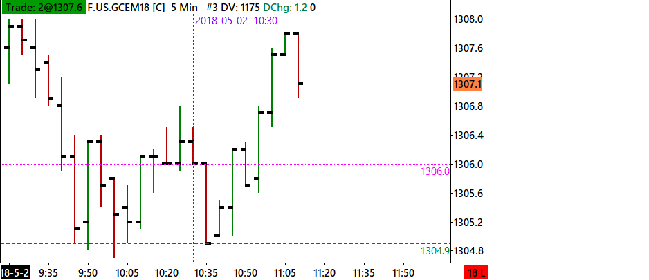

I know this is not your favorite topic lately, but I have an issue with the close price of a 5 min candle on the GC this morning. I also had the issue yesterday, but do not recall the symbol or timestamp, but it was with the close price as well. I trade with some friends that use different platforms and brokers and when we discuss the close of the 5 min candles, our charts didn't agree. I didn't think much of it yesterday, but when it happened again today, I figured there is something wrong.
The close price of the 10:30am ET candle on GC is 1306.0 on my chart, but everywhere else, it is 1306.1. See screenshot. If I look at the 10:34am 1 min candle, it also shows the 1306.0 close. I didn't think it would be a platform issue, but when I used the CQG web trader, they have the correct price, so I'm wondering where the issue is. I have tried reloading the data, disconnecting the data feed, even shutting down and deleting the .scid data file (I know not recommended). Every time, it shows up with the close of 1306.0.
http://www.sierrachart.com/image.php?Image=152530006962.png

[2018-05-03 18:41:25]
Yes, we do see 1360.0 for that time for that GC symbol from CQG data. We have now corrected the data by loading the data from our own historical data service. You can re-download the data for the correct prices.
We are aware that CQG is either not sending data or perhaps there is something unusual going on with the protocol buffer decoding and the data is just not getting decoded or processed an unknown reason. This last case though would seem to be extremely unlikely but we have to consider all possibilities.
We intend at some point to go over this with CQG. We also wish CQG would support the current protocol definition file for Google protocol buffers version 3 which they do not. This is really quite disappointing they do not do this.

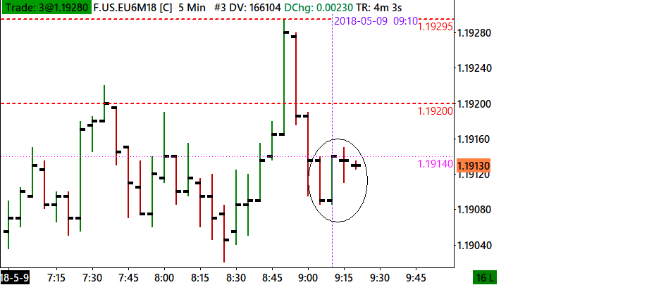

I had another instance of a candle not showing accurate close information. This time on the EC/6E. When the candle initially closed, it closed with a price of 1.19135, equal to the previous open. I then performed a "delete and download data" and it changed the candle close to 1.19140. Both are wrong. CQG web shows the close should be 1.19125. This candle is the 9:10am ET 5 min candle. See screenshot.
If the issue is with CQG not supporting the latest protocol standard, is there anything else that can be done? I asked my broker to talk to CQG on their side about supporting it, but haven't heard anything back yet. It is likely this is probably happening more than I notice. Do you have an idea of when you will be able to work with CQG on this? If it will be awhile, which I understand, I will have to switch to the SC data feed until things get worked out. I just need the best, most accurate data feed, but need to keep CQG for the server-side bracket OCO support.
http://www.sierrachart.com/image.php?Image=1525872059693.png

[2018-05-09 18:21:08]
We do not have hope that talking to CQG is going to make any difference and that is why we do not do it because generally it is going to be unproductive. We have much higher priorities.
Date Time Of Last Edit: 2018-05-09 18:27:03
This is actually an indication that the issue is on the CQG side and the server is delivering inconsistent data per connection. So this is indeed helpful information to us. It confirms what we have suspected. When did you notice this, was it today (2018 05-09)?
Make sure this option is disabled: Global Settings >> Data/Trade Service Settings >> Allow Server to Drop Data.
Reconnect to the data feed if you change that setting:
Date Time Of Last Edit: 2018-05-09 18:45:51

[2018-05-09 22:19:08]
User75002 - Posts: 117
Thank you for the update.
In response to post #5, the delete and download was performed today 5/9/2018 during the next 5 min candle at 9:15am ET immediately after noticing the problem. The Allow Server to Drop Data setting is set to False for the Web and FIX connections.
In response to post #7, hopefully CQG helps you out. The response my broker received was basically "we didn't change anything, talk to Sierra..", which doesn't surprise me. With your email to them, it explains what is needed so I hope they can implement the support for version 3. If you do not receive any helpful response back from CQG by the weekend, I will proceed with the 2 week trial of the Sierra feed.

At this point it appears that the difference you sometimes see with the close value of a chart bar when using CQG data, would not be solvable because it has to do with CQG timestamps.
