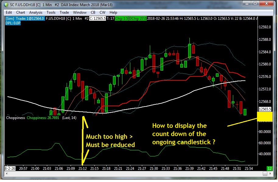

2/Subchart study : I have installed chopness indicator > It takes too much place in height > (see attached snapshot) > how can I reduce height of subchart study ?
3/Count down on each ongoing candlestick for each chart > how to display it (see attached snapshot)

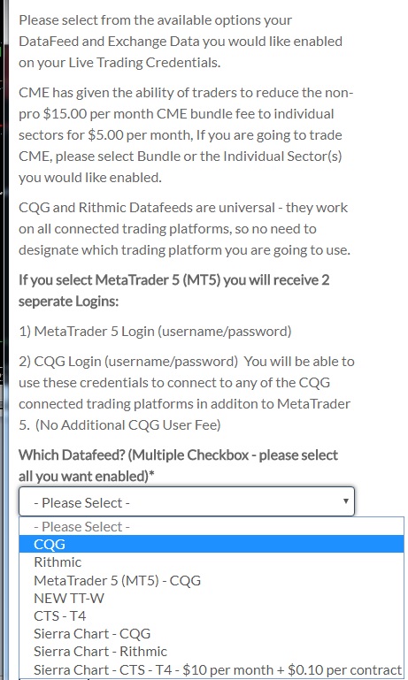

I need to open an account > which data feed should I use ? see attached snapshot)
Tx. Best

2. Refer to:
Working With Charts: Chart Window and Regions
3. Use this particular study on the chart:
Countdown Timer
For the data feed choose Sierra Chart-CQG. And once your broker sets you up with that, here are the set up instructions on the Sierra Chart side:
CQG Trading Platform Service: Setup Instructions
Date Time Of Last Edit: 2018-02-27 19:11:11

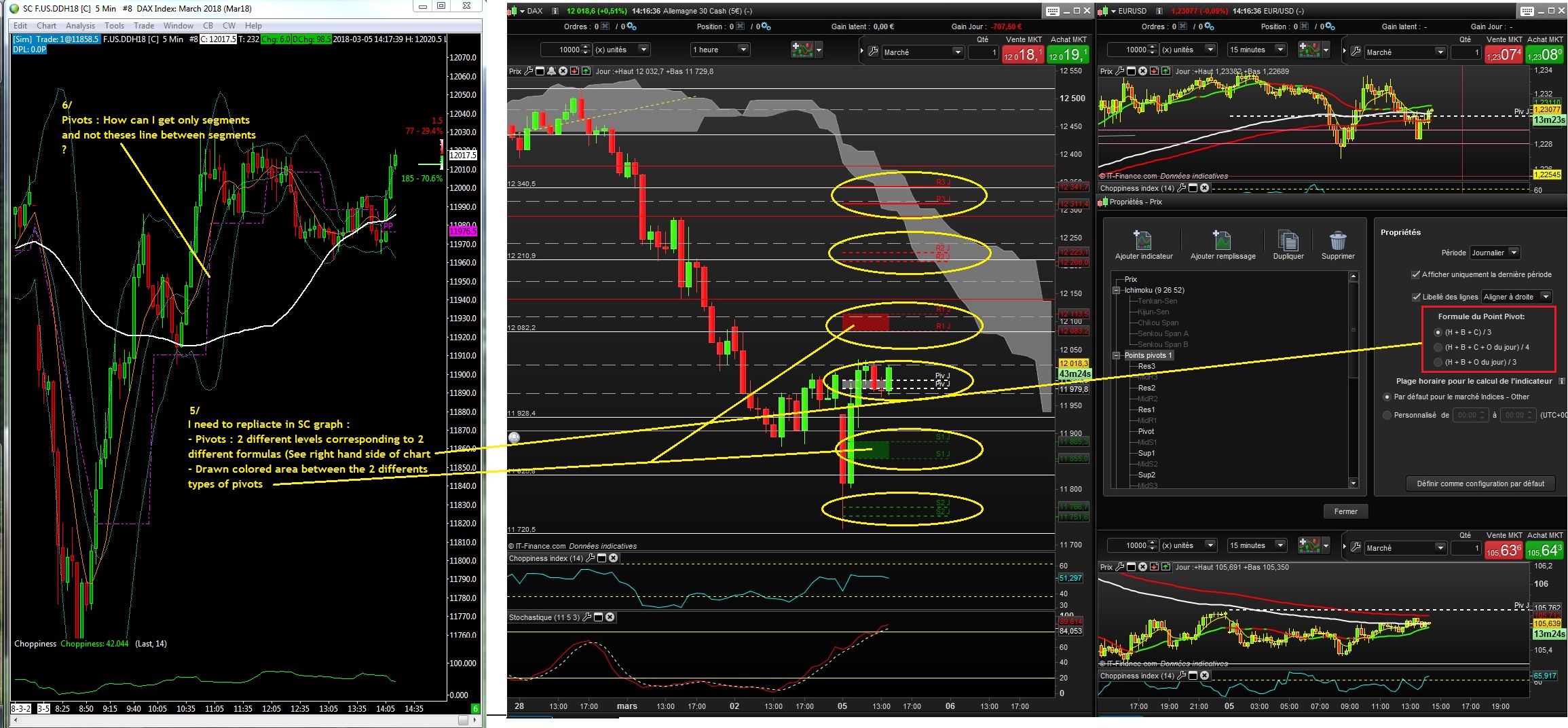

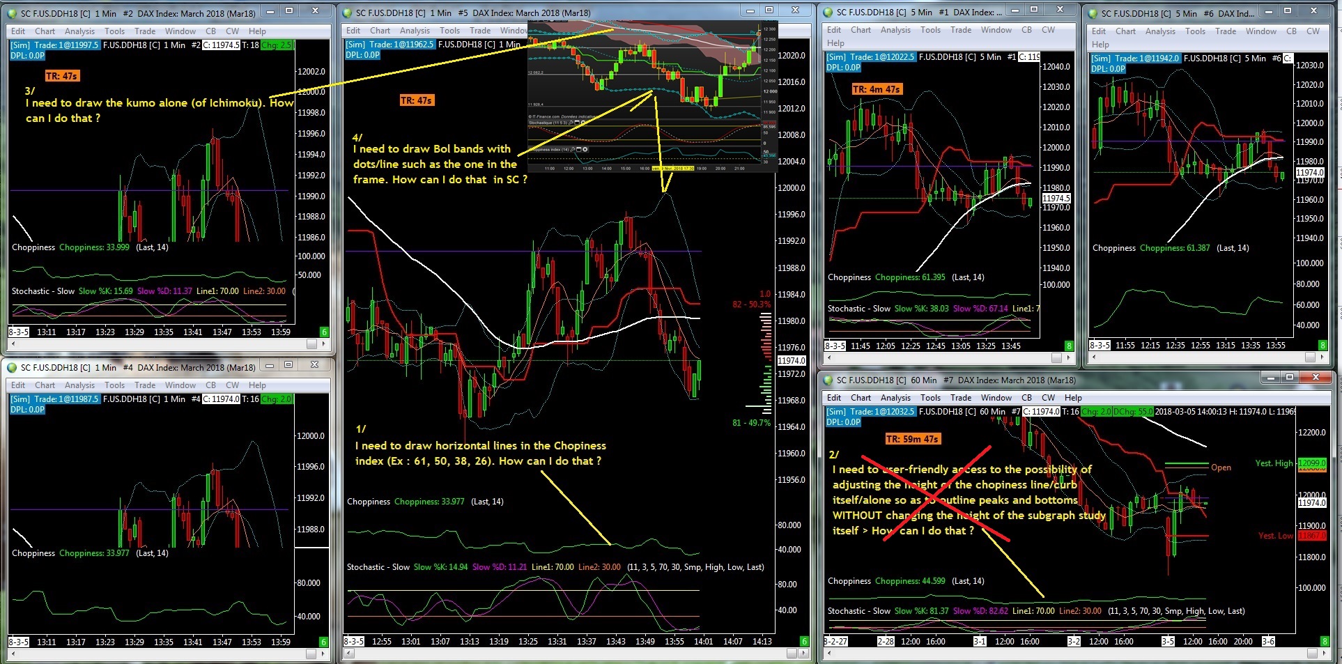

Ok. Thanks. I understand for a limited number of questions but Id like to set up my workspace so that I can try testing SC. Anyway, please find hereafter a few questions (Higher resolution attached snapshots) :
1/Chopiness Indicator : I need to draw horizontal lines > How can I do that ?
3/ Ichimoku : I need to draw the kumo alone but am unable to find Ichimoku study in the list provided. I went to http://www.sierrachart.com/index.php?page=doc/AdditionalFiles.php where Ichimoku is listed but I cant find it in "Add custom study" in chart > Right-click > studies, etc. How can I do that ?

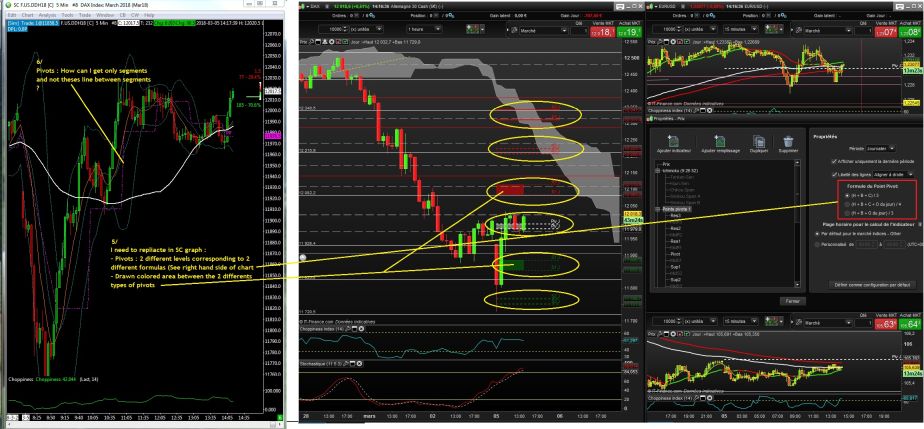

5/ Pivots : I need to draw daily pivots using 2 different types of formulas ( Either : (H + L + C) / 3 or (H + L + C + O of the day ) / 4 or (H + L + O of the day) / 3 ) and then get colored area in between theses levels. Please see attached snasphot for better understanding.
Thx. Best Gilles

1. Choppiness Indicator Horizontal Lines: You can draw Horizontal Lines using either the Chart Drawing Tools - documented here:
Chart Drawing Tools: Horizontal Line | Horizontal Ray | Horizonal Line Non-Extended | Vertical Line
Or by using the Horizontal Lines study documented here:
Horizontal Lines
Or by using the Line study documented here:
Line
3. The Ichimoku Study is a collection of studies that can be found on this page.
Additional Files (Study Collections, Spreadsheets, Chartbooks)
You will need to determine which particular study/studies you need from within this collection to accomplish your task.
5. Refer to the documentation here for the Pivot Points:
https://www.sierrachart.com/index.php?page=doc/PivotPoints.html#s87

1. Here is the relevant documentation:
Chart Studies: Adding a Horizontal Line to an Existing Study
Also refer to prior response above.

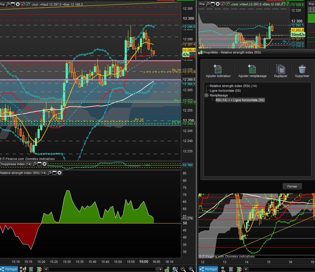

Thank you. (I activated my account with AMP Futures > I guess you received from them the confirmation so that I can use Sierra Chart platform and benefit from your assistance. Please confirm. Tx). I need to replicate the RSI on basis of attached parameters : Period 14; Line 50 ; Green filling between RSI and Line 50 when RSI is above 50 ; Red filling between Line 50 and RSI when RSI is below 50 > Q1 : What is the RSI to select (It seem "RSI" alone is not the one but "RSI-W" neither (they both include an average which I never saw before) > which one to choose ? / Q2 : After I chose the right one, how can I implement these fillings I need ? Tx
image180319 RSI SC.jpg / V - Attached On 2018-03-20 15:08:57 UTC - Size: 290.61 KB - 520 views
[2018-03-20 17:42:59]
The only way we can know you are using a paid Sierra Chart account is for you to select Help >> Support Board from within Sierra Chart and only post using that particular account.
This type of coloring is not supported. This fill coloring is only supported to the zero level. Not to some other random number.
You will want to use the RSI study.
