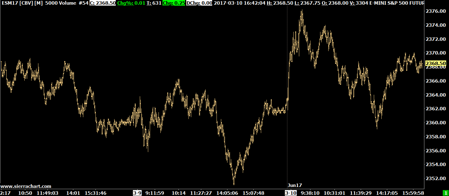

I have my ES futures chart set to [CBV]. There was more volume yesterday in March than June. Today we've traded more in June. My problem is that SC rolled my [CBV] charts when I opened the platform today, but did so starting YESTERDAY. Yesterday's price action should be a back-adjusted version of March trading, and it is not. It's the very low volume price action from the June contract trade.

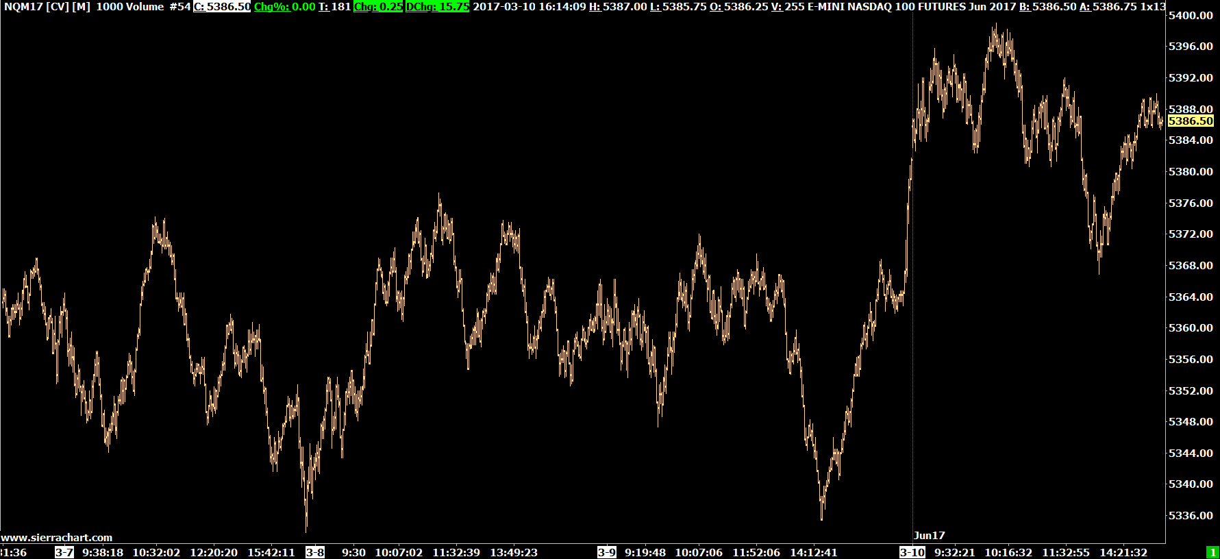

ElmStreetTrader - Posts: 48

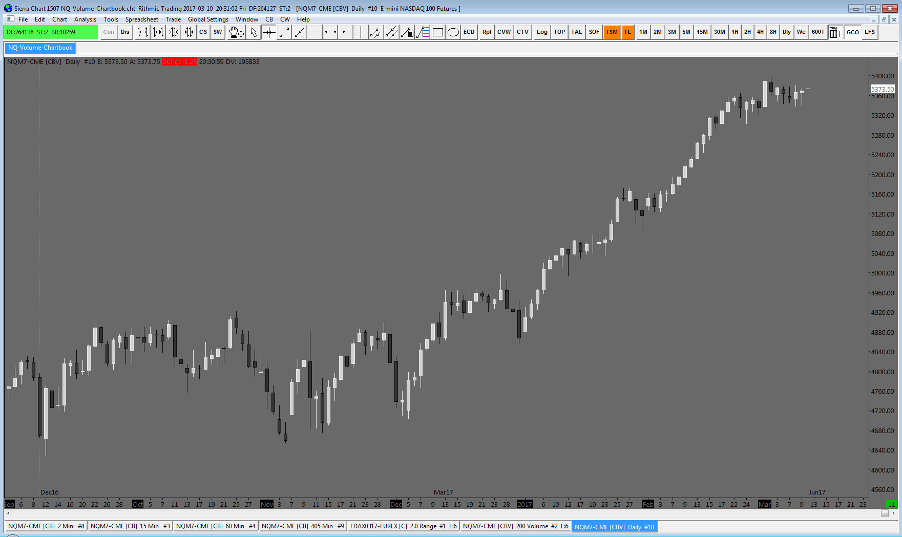

I had the same issue with the NQH7-CME to NQM7-CME yesterday.
(In the attached image the two contracts are not continuous, just used them for representative purposes.)
imageRollover.PNG / V - Attached On 2017-03-10 15:05:40 UTC - Size: 55.41 KB - 356 views

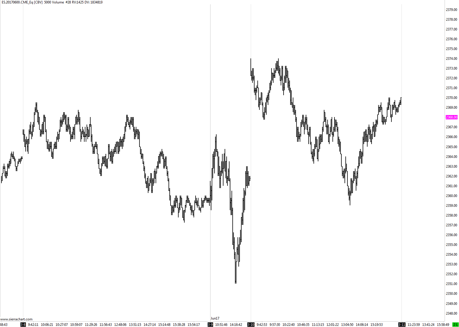

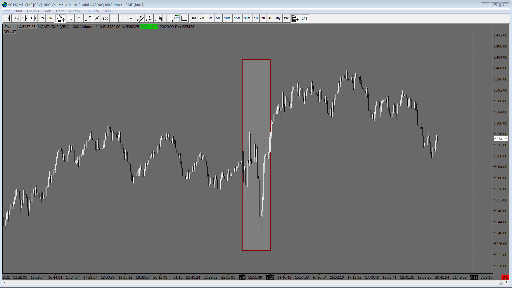

[2017-03-10 18:32:41]
Here you go:
(And I re-downloaded all the data this morning).
Date Time Of Last Edit: 2017-03-10 18:34:15
imageRollover2.PNG / V - Attached On 2017-03-10 18:32:04 UTC - Size: 72.1 KB - 407 views
[2017-03-10 18:53:42]
The rollover is occurring today (March 10) in that chart. No problem with that particular chart.

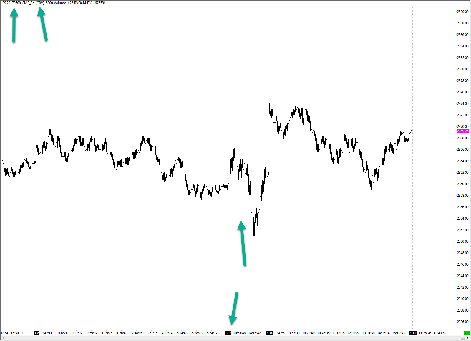

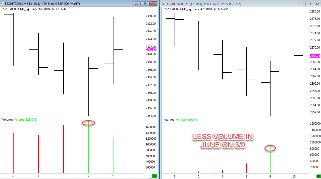

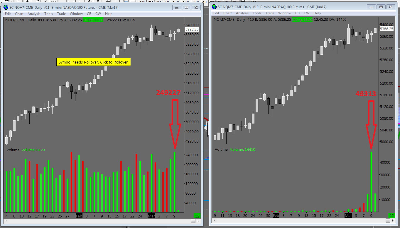

[2017-03-10 20:01:32]
The thing that is confusing according to what you're saying about rollover is that as you can see in the attached image the volume for March the 9th is the first day of the June contract when it should be the last day of the March contract.
imageRollover3.PNG / V - Attached On 2017-03-10 20:01:04 UTC - Size: 69.67 KB - 435 views
[2017-03-10 20:56:38]

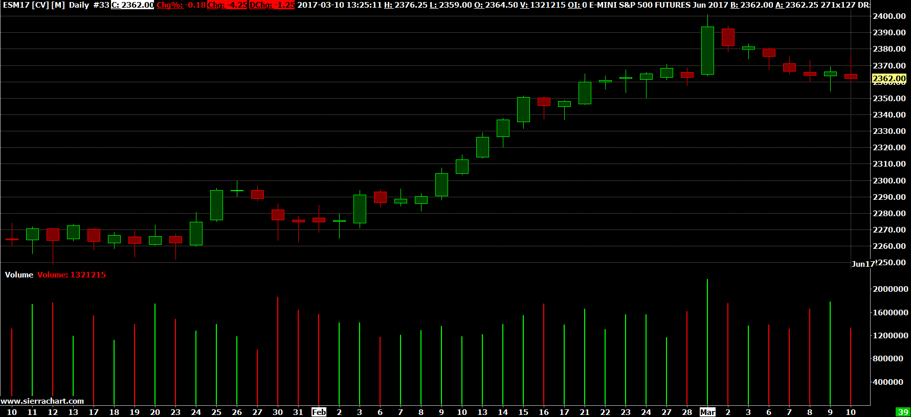

User57210 - Posts: 121
See images. 1) Volume is higher on 3/9 in March. 2) The intraday [CBV] is obviously wrong.
imageDAILY VOLUME.png / V - Attached On 2017-03-10 20:54:35 UTC - Size: 59.17 KB - 362 views
imageINTRADAY PROBLEM.png / V - Attached On 2017-03-10 20:54:43 UTC - Size: 64.41 KB - 339 views
[2017-03-10 21:17:42]
At this point, neither of you have followed our instructions. We asked for a chart image following these instructions:
Neither of you did that. We will not accept another image. In this particular case we do not need anything marked up on the chart.
We asked you to enable Chart >> Show Rollover Dates. Neither of you did that.
At this point there is no help we can provide because neither of you have provided proper evidence of a problem in the chart images you have posted.
That is not clear because our specifications were not followed. Initially it looked as though there was missing data on March 9. But we think we understand what you are trying to show but it is an indirect way of doing it.
The chart looks fine to us:
http://www.sierrachart.com/image.php?Image=1489180455801.png
In regards to post #9, we cannot help with those chart images because our specifications were not followed.
