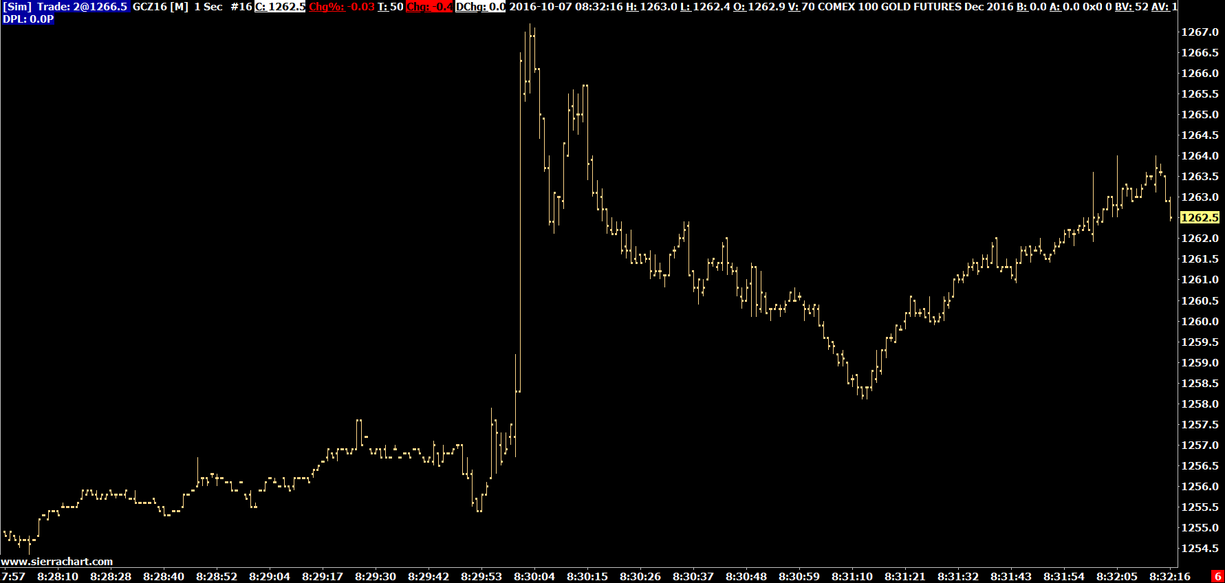

As you can see here:
Auto trail order modification (Move to breakeven). Trigger price: 1258.200019.
The trigger price is 1258.20 which is the last trade price which caused the move to break even.
However, the timestamps in your Trade Activity Log and the prices we see do not correspond with the market action assuming these are US Eastern times. December GC was not at 1265 at 08:29:45. Here is the second by second activity:
http://www.sierrachart.com/image.php?Image=1476000270806.png
It reached that price at 08:30:01
Anyway we do see why this happened and that is the move to breakeven was using market data slightly before the fill. In order to not miss any prices, Sierra Chart does use all of the trading activity in between chart updates but we can see, that in this particular scenario, it only must be the activity after the fill and after the move to breakeven was allowed. We need to examine this more closely and see how best to handle that.

Sierra Chart is very reliable and high quality software as is clearly evidenced by our users experiences and the fact that we promptly take care of any issues that arise that are within our control. Just like we did here.
The basic cause of this problem is simply the circumstances and very fast-moving markets and lagging data. None of which we have any control over and the changes that have been made would not have avoided it anyway and would it still have happened.
There is no way that we can prevent something like this from happening but there are things we can do to minimize it but the more we do to minimize it, it then creates a problem where some price action is ignored.
It also is not reliable to use timestamps as a safeguard for this kind of potential issues because IB does not have a trustworthy highly accurate timestamp in our experience for order fills, which is in sync with market data which contains no timestamps. This is also especially a problem by the fact that your computer clock was off by 16 seconds which is indisputable. There is no way that any program built to work with Trader Workstation can handle move to break even stops perfectly. This can only be done on the backend using timestamps from the exchange itself.
Apparently we were mistaken when we said Interactive Brokers does not have move to breakeven stops. We thought they did not, and before we made that statement, we checked the TWS documentation and there was no mention of them. So apparently these are undocumented.
We apologize for adding a time credit to your account. It has been removed. With the low prices of Sierra Chart, and with the support cost you have put on us over time, and the way that we have been treated by you it was completely inappropriate for us to be adding a credit. The basis of the credit was the fact that something was brought to our attention, that we normally would not have been aware of and something that we thought at the time was of significance and should be changed. Our review of that has changed though.
It is totally and completely inappropriate to be requesting payment for consequential damages. Besides Sierra Chart has done nothing wrong here. Sierra Chart is very high quality and reliable software. It is silly to think with the low prices of Sierra Chart and based upon the well-established law of contracts that we will be paying for consequential damages. Under contract law, consequential damages simply are not claimable. Any lawyer will tell you that.
You need to understand we are not a broker and also as a general rule brokers will not compensate traders for losses when there are technical problems. There are certainly exceptions to this but in general this is simply not the case. This is a general statement not only applicable to Interactive Brokers but to all brokers.
Now what can you do to prevent a problem like this:
Certainly the changes that have been made will help minimize it. So update Sierra Chart to the current version.
However, we cannot guarantee that it will not happen again. Although we would expect that it is unlikely to occur but cannot promise that.
You also need to use the Sierra Chart Exchange Data Feed which is a low latency and complete data feed:
If you do not even want to spend the money on this data feed, then this is your issue.
Furthermore, if you understand law you will know that we are not responsible for consequential damages and we should never get involved in that. You do not want to do anything which is going to increase the price of Sierra Chart or create unnecessary burdens on us.
If you want to kick me out as a customer because I suffered from a Sierra Chart shortcoming and brought this up to your attention, then go ahead.
This statement makes no sense. We would never do such a thing we do not know why you are saying this. We gave the support request prompt attention and corrected what we thought was the problem, but that was not relevant to the issue after further analysis. Why we are being treated this way, we do not know. This statement reveals the true nature of who you are. You very often have been abusive towards us in words and have blamed for us for issues which are not even ours. Just like you are doing here. We acknowledge that there was a slight issue that potentially could have been a problem but it was not relevant to this case.
What you are trying to do is tempt us to cut off your account so you can get even more angry at us and then complain to every other person out there to somehow make us look bad in your opinion. Why you are doing this, we do not know.
It is very clear your following a strategy of bashing us and blaming us, when the root problem here is that is substandard Interactive Brokers data feed .
Here is the relevant documentation we have prepared in relation to this issue:
Order Types: Effect of Delayed Data on Trailing Stops
We have also patched the issue described previously in post #5, although it did not contribute to the problem in this particular case.
And another thing too, we have experience with the gold market ourselves. It is completely improper to blame us for any loss in the gold market and we will never accept that. The gold market is a known manipulated market which you should be very very well aware of. Stop orders are routinely touched off only for the market to reverse and go the opposite direction. Please do not blame us for this.
I will contact your management about this event.
You are already speaking to the top programmers and management here. There is no one else higher up. We are all involved in software development .
