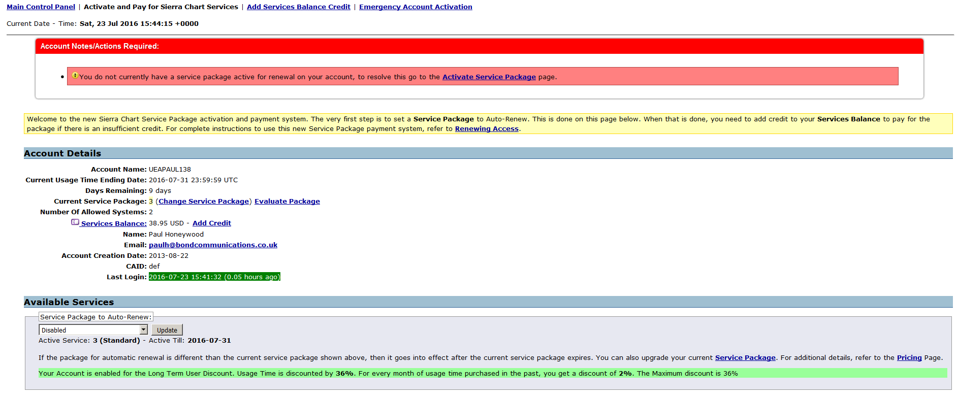

2) Account credit error. Although my renewal is no until the 31 JUly I have a red account warning message saying "You do not currently have a service package active."
Please confirm whether I can quickly obtain a non-destructive prior release.

imageSierra Chart Account image.png / V - Attached On 2016-07-23 16:13:35 UTC - Size: 66.95 KB - 391 views
