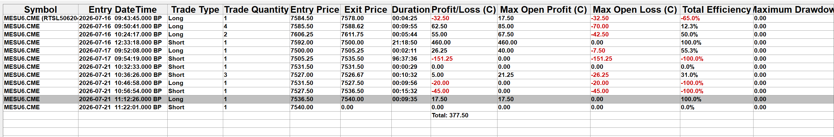

However, in the Trades tab, the same fills are summarized as:
Long 1 @ 7500.00 → 7505.25 (+26.25)
Short 1 @ 7505.25 (still open)
This does not match the underlying fills. Additionally, a previous trade from 2026-07-16 is shown as a single-contract short from 7592.00 to 7500.00 for +$460, which is not a trade I actually took.

Long 2 contracts → In the Trades tab, this was summarized as Long 1.
Long 2 contracts → Again, this was summarized as Long 1.
Short 2 contracts → This trade was summarized correctly as Short 2.
During all of these trades, Sierra Chart correctly showed my live position size and unrealized P/L while the trades were open. The issue only appears after the trades are completed, when they are summarized in the Trades tab and reflected in the Daily Profit/Loss calculations.
Since the short trade was recorded correctly as 2 contracts, but both long trades were summarized as only 1 contract, does this point to a trade matching or order fill reconstruction issue?

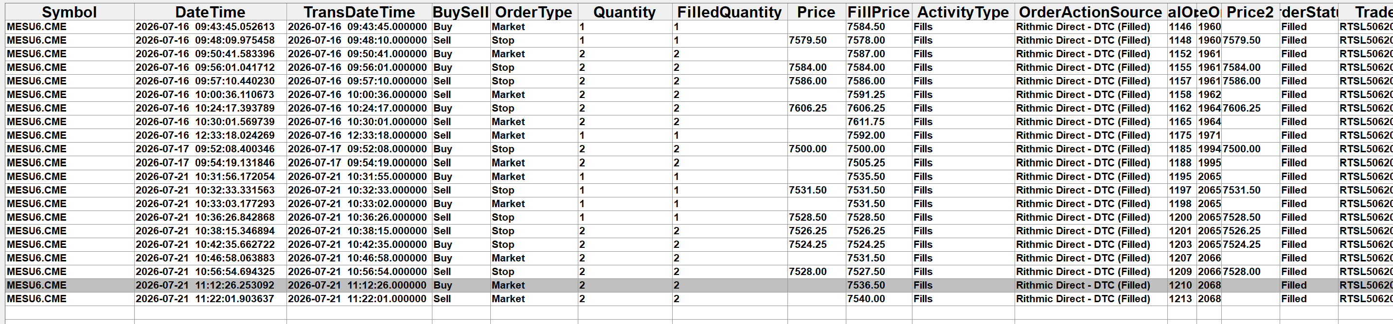

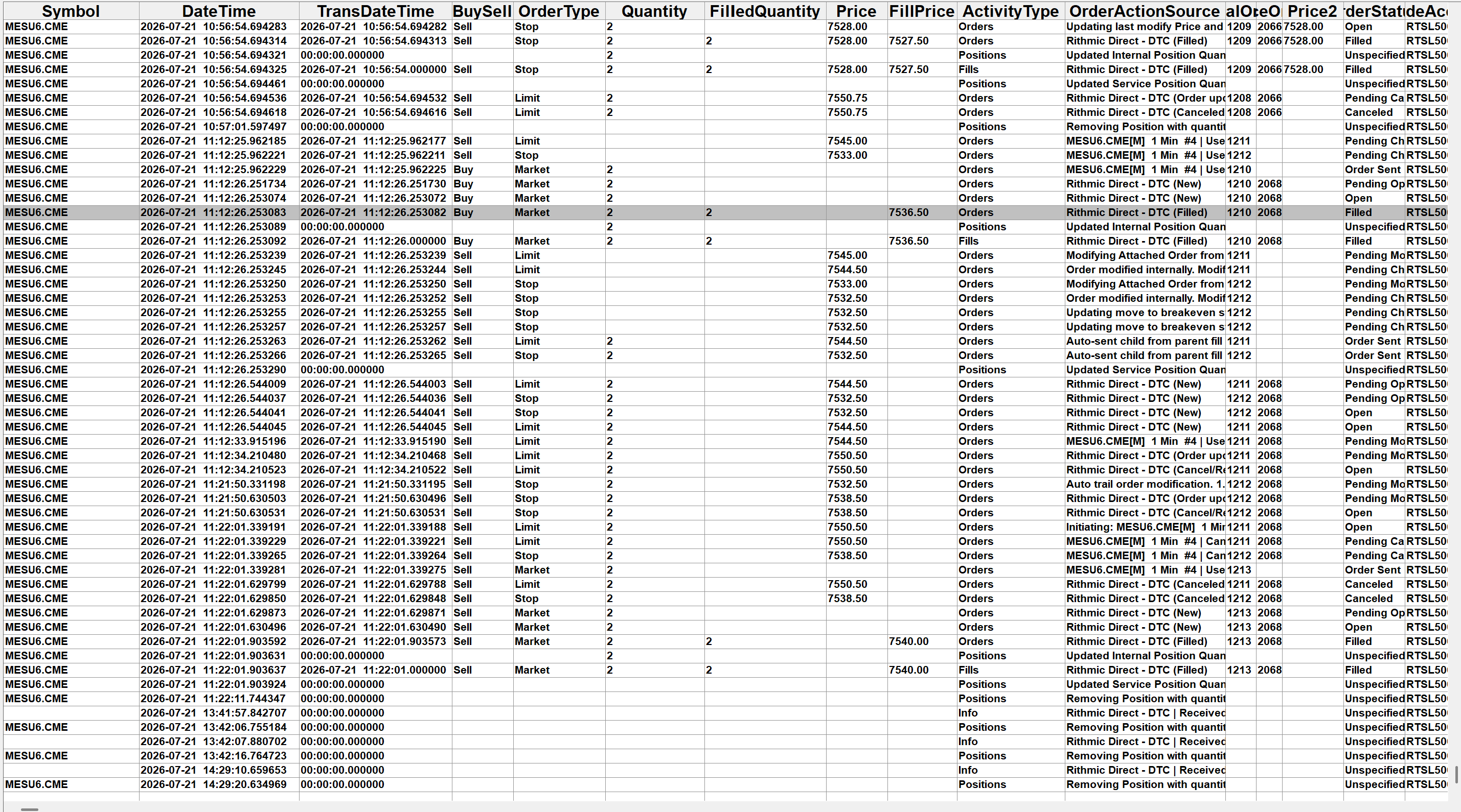

in my trading activity you can clearly see the qty of 2, but in my trades tab is showing only 1 with the second one being canceled with no exit price? my rithmic account is receiving the fills with no problem, everything is working fine. I do think this is somehow related to Sierra.
imageScreenshot 2026-07-21 140841.png / V - Attached On 2026-07-22 04:41:30 UTC - Size: 170.91 KB - 99 views
imageScreenshot 2026-07-21 140500.png / V - Attached On 2026-07-22 04:41:48 UTC - Size: 408 KB - 90 views
imageScreenshot 2026-07-21 140403.png / V - Attached On 2026-07-22 04:42:17 UTC - Size: 88.49 KB - 96 views

If you look at the Order Fills that you have listed and add/subtract the quantities based on whether it is a Buy or Sell, you end up with a quantity of -1. Meaning that based on just those order fills, you are not flat in the market, but rather have an open position for -1.
If you are flat, which we assume you are, then either you are not loading order fills for the Trade Activity Log going back far enough, meaning that the first order fill from 2026-07-16 09:43:45 was not actually the beginning of a position, but rather the end of one, so you are off by an order fill.
Or, you are missing an order fill somewhere along the way in this. You need to look at the Order Fills and see how they align with what you actually did and find the missing fill.

Regarding, all of the screenshots at post #8, there is a large number of fills there and it is fully outside the scope of our support, totally outside the scope of our support to be manually going through that and seeing how all of that is matched up. Completely impossible for us to do anyway. So we cannot even begin to answer your questions.
The Trades tab is going to match those order fills based upon what is explained here:
Trade Activity Log: Order Fill Matching and Flat to Flat Definition
Change the starting date and time in the Trade Activity Log, to the current date and time just before you start a position. Otherwise, there is a lot of work to analyze those order fills.
