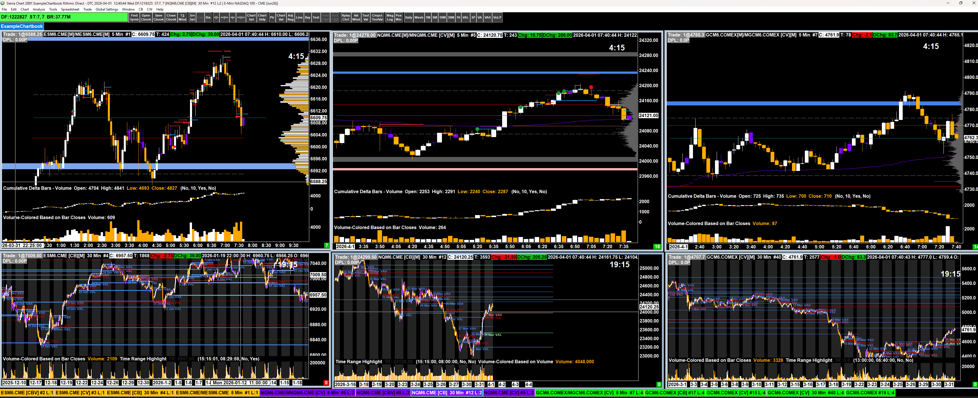

Thank you. I set up a new instance and it seems that Denali is used as data feed. Unfortunately, I still have issue with the lookback time for tickers.
On my other instance (Amp+Denali/Teton) the look-back time is more than 6 month. On the Apex+Denali Instance I cannot make it work. Like ES 30min Bar graph has much further look back time than the NQ 30min bar chart (only 2 weeks, not earlier than March 16), despite they have exactly the same settings. Same randomness occurs for my daily volume profiles in terms of look back time as well (like the look back time for daily ES volume profiles is more limited as well not as specified as in the chart setting - 120 days). Not sure what else to do!
Deleted the the tick data and tried to reload, but with the same result. Also strange that I need to translate the symbols after each start of Sierra Charts again.
imageMainScreen.png / V - Attached On 2026-04-01 12:41:54 UTC - Size: 444.46 KB - 210 views
[2026-04-01 16:35:41]
The first thing we want to point out is that the ESM6.CME/MESM6.CME chart in the upper left corner (Chart #1) is NOT setup to be a Continuous Contract chart like the others.
Also, we see different Continous Contract options being used for different charts. We just want to make sure that this is on purpose.
As to the data in the NQM6.CME chart (Chart #12) we do not know offhand. It is set to be a Continuous Contract chart, so you should have data going back as far as you have set the "Data Limiting". For that chart, what is the "Days to Load for Intraday Chart Data Type" or the "Date Range From/To" (depending on which one you are using) set to in "Chart >> Chart Settings >> Data Limiting"?
Also, make sure you have scrolled the chart back to ensure that you are viewing the data going back further in time. We see that you do not have the scrollbar displayed, so we can not tell if there is data further back or not.
