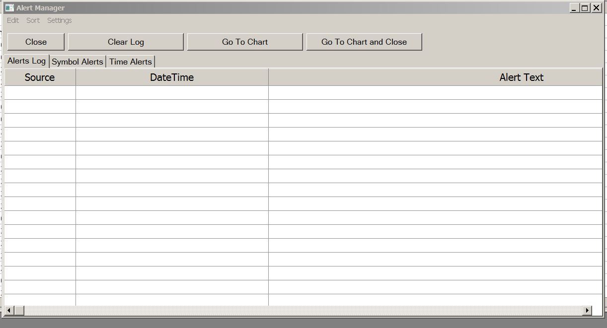

4646ed - Posts: 231
So, once again, if I download the latest version from the what's new page, then I am getting the "new" spreadsheets?
Second of all, I did your test, same result: no sound, no alerts in alert manager. I've attached snaps of the alert manager, the chart, the settings, and the spreadsheet.
Is there something I'm missing?
Date Time Of Last Edit: 2014-10-23 08:45:54

4646ed - Posts: 231
Update: the only time I get the audible alerts and the alert manager log entries is when I replay one of the charts on standard - and this just started happening. But still nothing except the drawings during live. Attached is a snap of the alert manager with the replay alerts logged.
Date Time Of Last Edit: 2014-10-23 13:37:35
