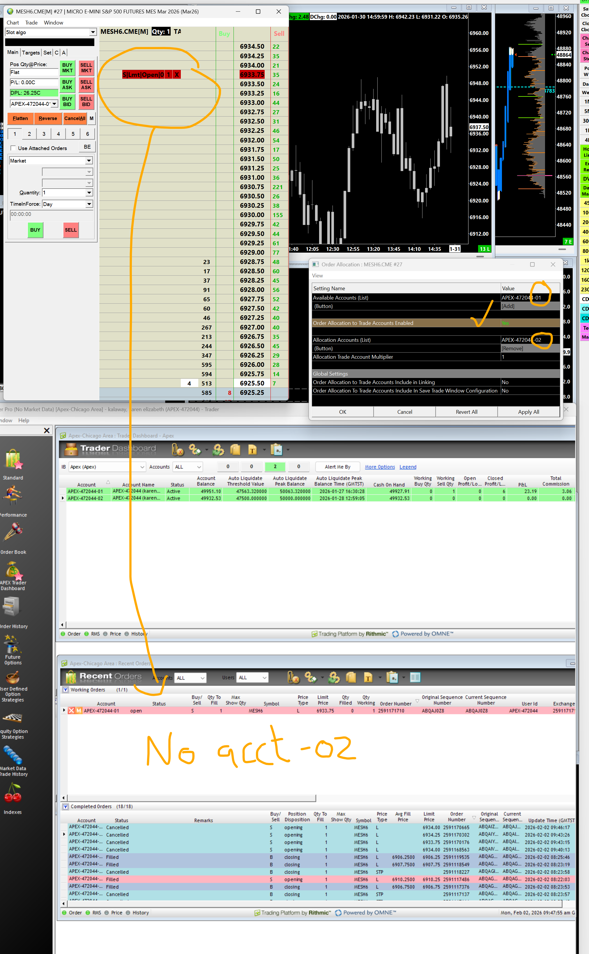

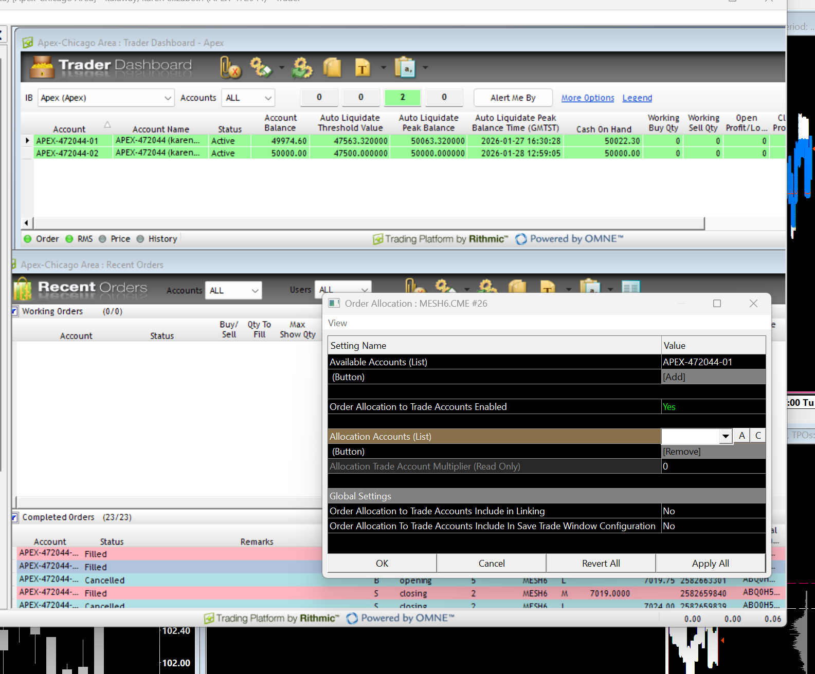

[2026-01-28 13:27:04]
User849502 - Posts: 485
John,
Sorry to be a pain in the ass, but I bought a second Apex acct and followed the instructions in ou support. But the new acct isn't showing up in the list of 'allocation accts' How do I get the new acct in there. See attached.
thank you so much xx
imagewhereis2ndacct.png / V - Attached On 2026-01-28 13:26:02 UTC - Size: 457.4 KB - 237 views
[2026-01-28 13:48:39]
User135243 - Posts: 337
Available Account (List)
click the 02 account and click ADD and it will move down and 01 will stay the leader
[2026-01-28 14:15:25]
Mate,
I am sorry I did figure that out. Now look. I have done everything I THINK right yet only one order is showing at Apex.
1-I have 1 as the master
2- allocation enabled
3- I have 2 in the allocation
on the dom I have 1 in the main drop down
But at apex only 1 order shows
I am soooo sorry to buy you, and I have the entire discord room trying to help too...
imageonlyoneshowing.png / V - Attached On 2026-01-28 14:14:57 UTC - Size: 997.37 KB - 249 views
On the DOM click M (menu) go to Settings and there click Enable Order Allocation to Trade Accounts and also Enable Order Allocation to Trade Accounts

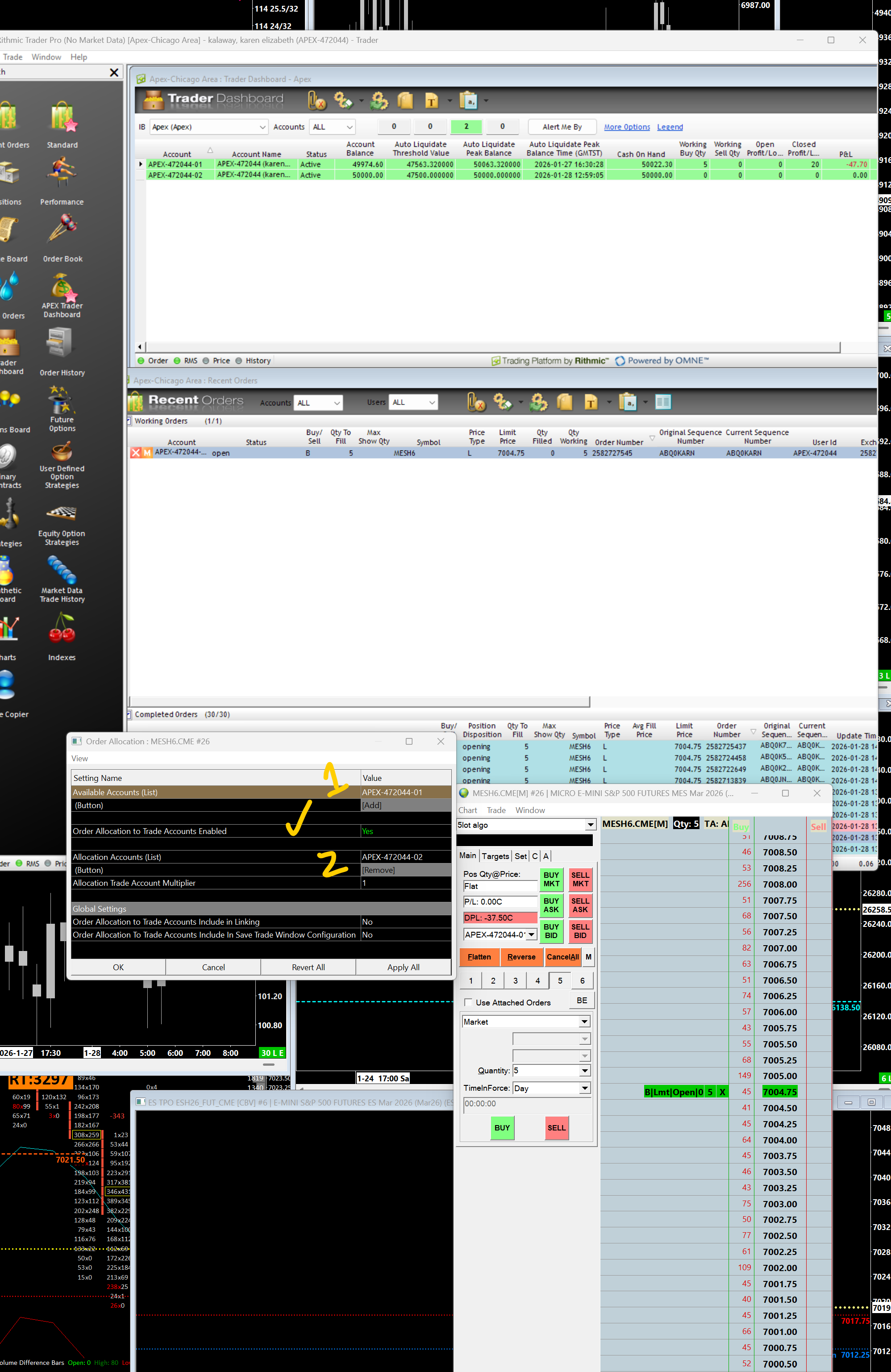

[2026-01-28 15:31:58]
This is deffo NOT working. I have everything correct.
1- the correct -1 is the master
2- the study is ENABLED
3- the allocated acct is -2
4- trade entered on acct -1
5- trade shows in Apex for -1 only
what could possible be wrong???
imageeverything perfect.png / V - Attached On 2026-01-28 15:31:45 UTC - Size: 999.56 KB - 192 views

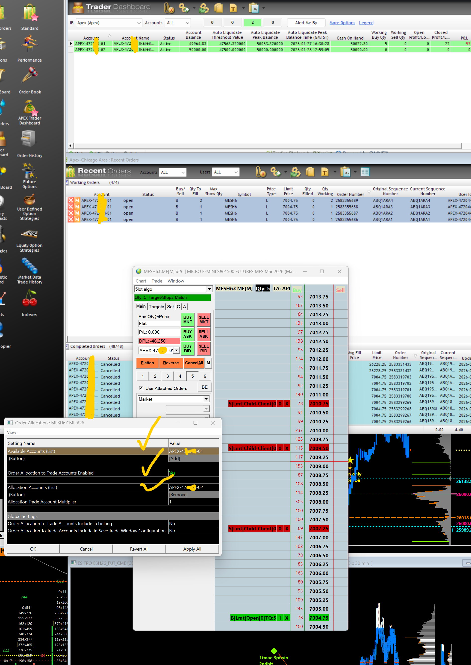

[2026-01-28 15:45:24]
Keep in mind that the "Order Allocation to Trade Accounts" is setup per chart, as it is associated with the Trade Window, which is per chart. So if you set this up on a chart, but then submit a trade from another chart, the Order Allocation may not be what you think (as it will depend on how it is setup on that other chart).
Also, keep in mind that the information on the "Order Allocation to Trade Accounts" does not specify a "Master" account. The "Master" account is whatever account is setup to be traded on that chart per the Trade Window. And any accounts that are setup to be copied to will have the orders copied to them. This means that if you have account "02" in the list to be copied to and you change from account "01" to "03", the copies of the orders will still be done to "02".
This also means that if you select "02" the orders will not be duplicated. You will just get one set of orders sent as you would expect.
Given the above, make sure everything is setup correctly and you are using the correct chart. If you still have a problem, then check your Trade Activity Log and see if it is showing trades for the "02" account. If not, then check the "Trade >> Trade Service Log" and see if there is anything in there as to why orders to the "02" account are not going through.

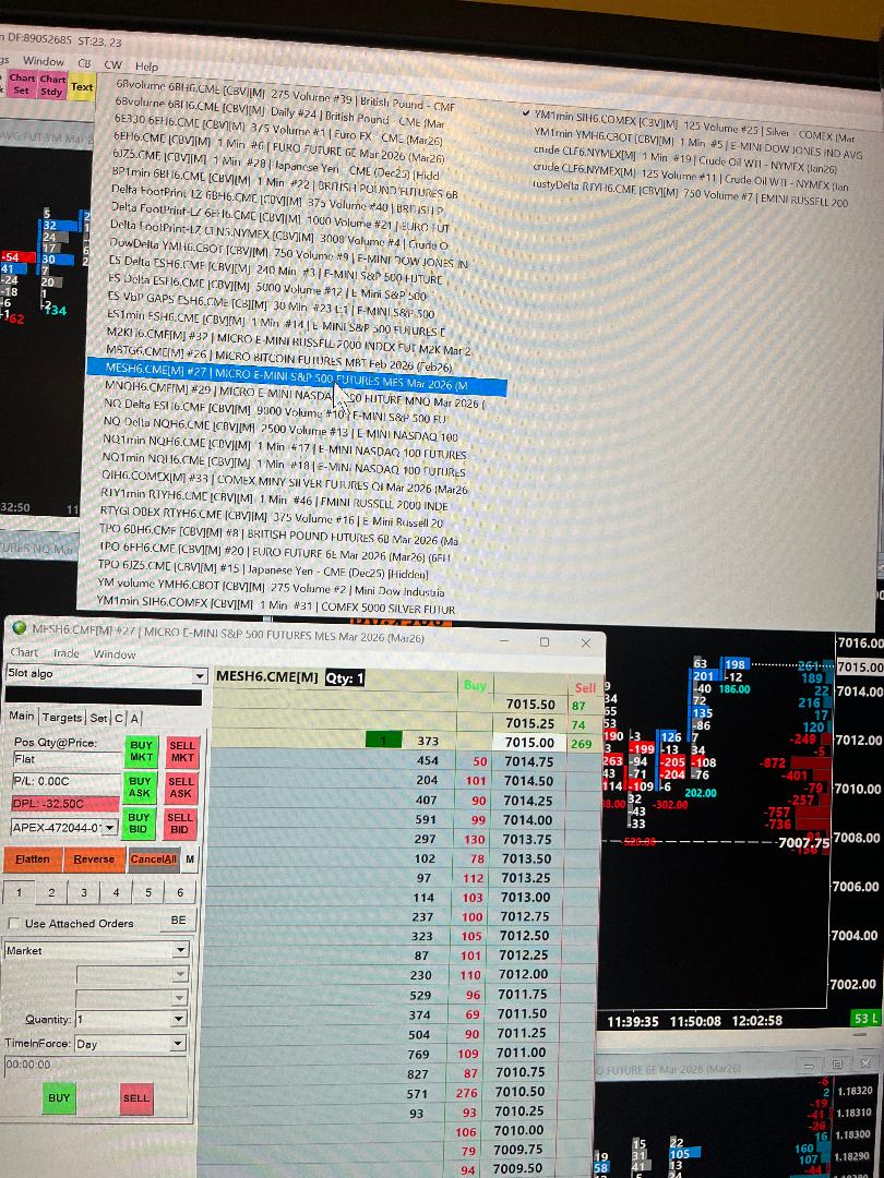

[2026-01-28 15:57:12]
Actually, I didn't make the doms from a chart. I went into file>find symbol>...so a chart was never involved, I created doms stand alone. There are no MES charts in this chartbook...hmmm rats now I am really confused

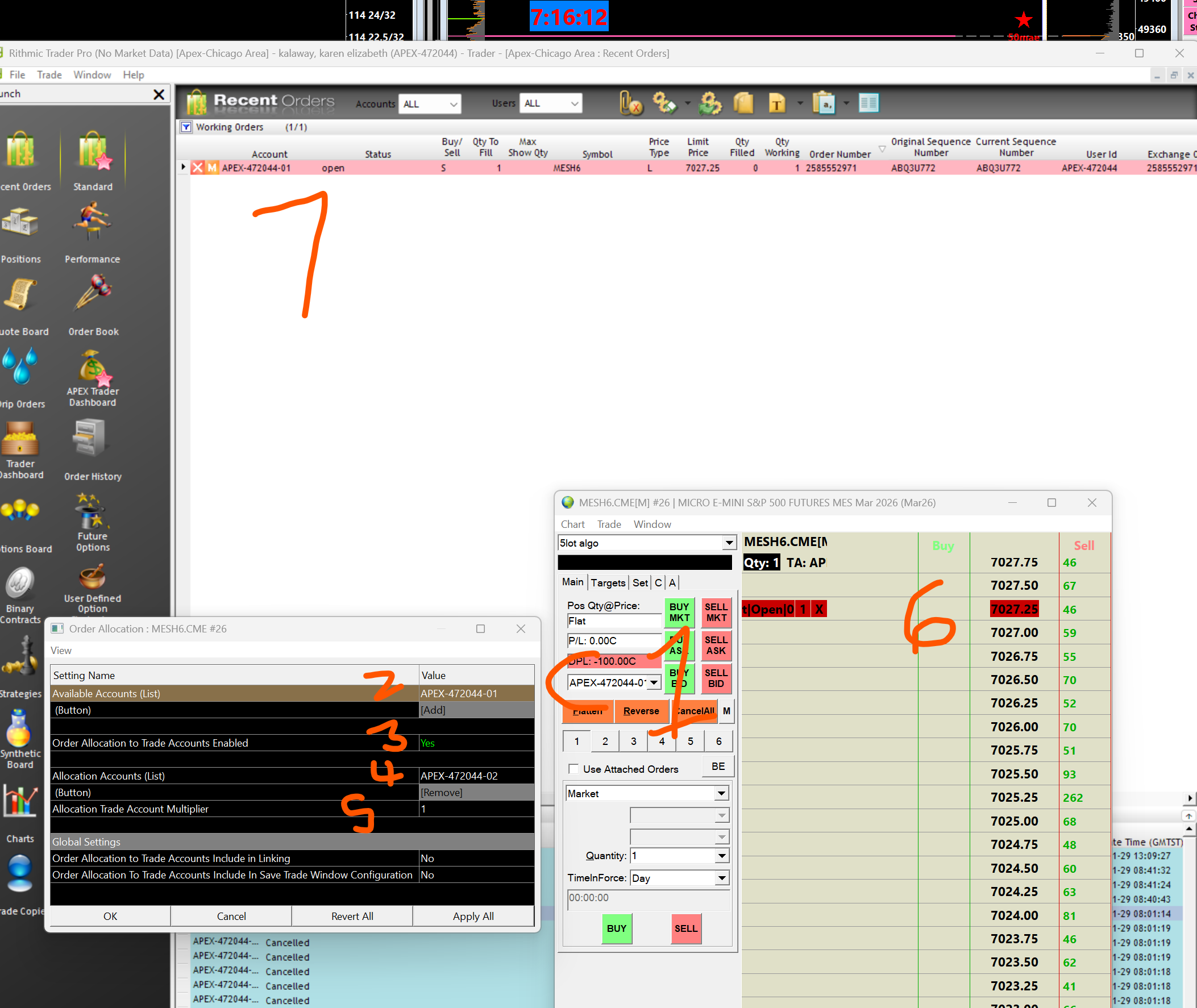

[2026-01-28 21:15:28]
Trading DOMs are just a specialized chart as far as the underlying Sierra Chart is concerned. So it doesn't matter if it is a Trading DOM or a Chart that you are trading from, the concepts are all the same. Specifically, the Order Allocation to Trade Accounts setup only applies to that individual "Chart". So if you set it up on one "chart", it will not be the same as another "chart" unless you have specifically set them up, or used the options for including in Trade Configurations and/or Linking.
[2026-01-29 13:21:42]
Mate,
I have gone over this again and again, and I can't see what is wrong. The only 'chart/dom' open in this chartbook for MESH6 is what you see in the screenshot of #26 dom.
1- I have the 01 acct selected on main dom page, you see it circled
2- I have the 01 acct as the top line 'available accts'
3- I have the 'enabled' to YES
4- I have the 02 acct as the 'allocation'
5- I have multiplier at 1.
6- I have a 1 lot entered in the chart/dom, which correctly shows as live in Apex open orderbook
7- There is NO second allocated order being created for acct 02
I am trying so hard, but I don't see what is wrong...I hate taking up your time, but I have to get this to work. Karen
imageeverysteplooksperfect.png / V - Attached On 2026-01-29 13:20:21 UTC - Size: 588.81 KB - 220 views

[2026-02-02 17:44:47]
The first thing we want to point out is that you keep referencing that "01 is the available acct, enabled is YES, and allocation is 02". What is shown in the field for "Available Accounts" has no impact on what occurs. That is just where you select the accounts to be added to the list to be copied to. There is no "Controlling" account.
The one thing you need to ensure is that the selected account on the "Trade Window" is a different account from the ones that are being copied to. Otherwise, you will not get a copy made. In other words, if you have the "02" account set to be copied to, and the Trade Window has the "02" account selected, then there is nothing to copy to, as that account is already being traded. So make sure you have the "01" account selected in the Trade Window.
But, everything you show states that the above is not the issue. We just want to make sure you understand it.
Given that everything looks correct and there is nothing in the Trade Service Log showing any issues, we have to assume that you are not trading from the Chart for which the Trade Window was setup. Each chart has its own Trade Window and the settings for the "Order Allocation to Trade Accounts" is only set for the specific Chart/Trade Window on which you set it up.
In the image, the Order Allocation to Trade Accounts is setup for Chart #27, which is the Trading DOM on which you show the position line. Is this also the chart where you create the order? How are you entering the order?

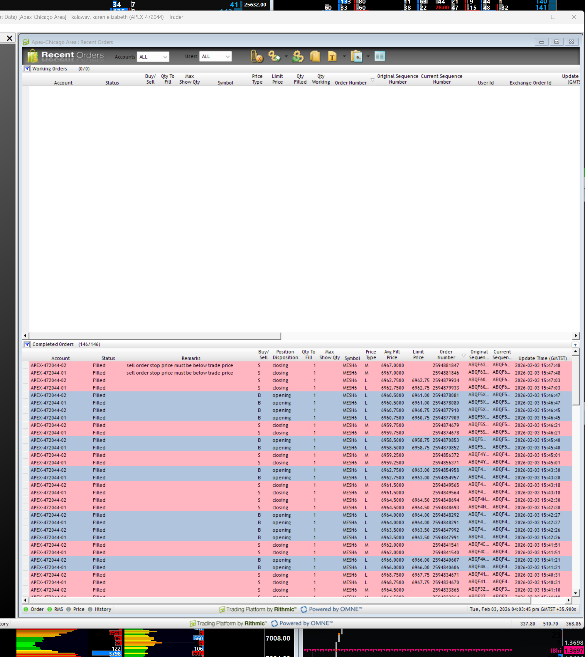

[2026-02-02 17:58:46]
John,
There is only one chart in this chartbook that is MES, and this is chart #27, which is the trading dom you see in the screenshots. To create #27 I went to find symbol>blah blah blah, and created the MES dom/chart. I just took a photo w phone so you can see the dropdown box for the chartbook, and that #27 is the only MES chart in the book.
thanks mate
imageonlyoneMESchart.jpg / V - Attached On 2026-02-02 17:58:39 UTC - Size: 205.47 KB - 209 views
