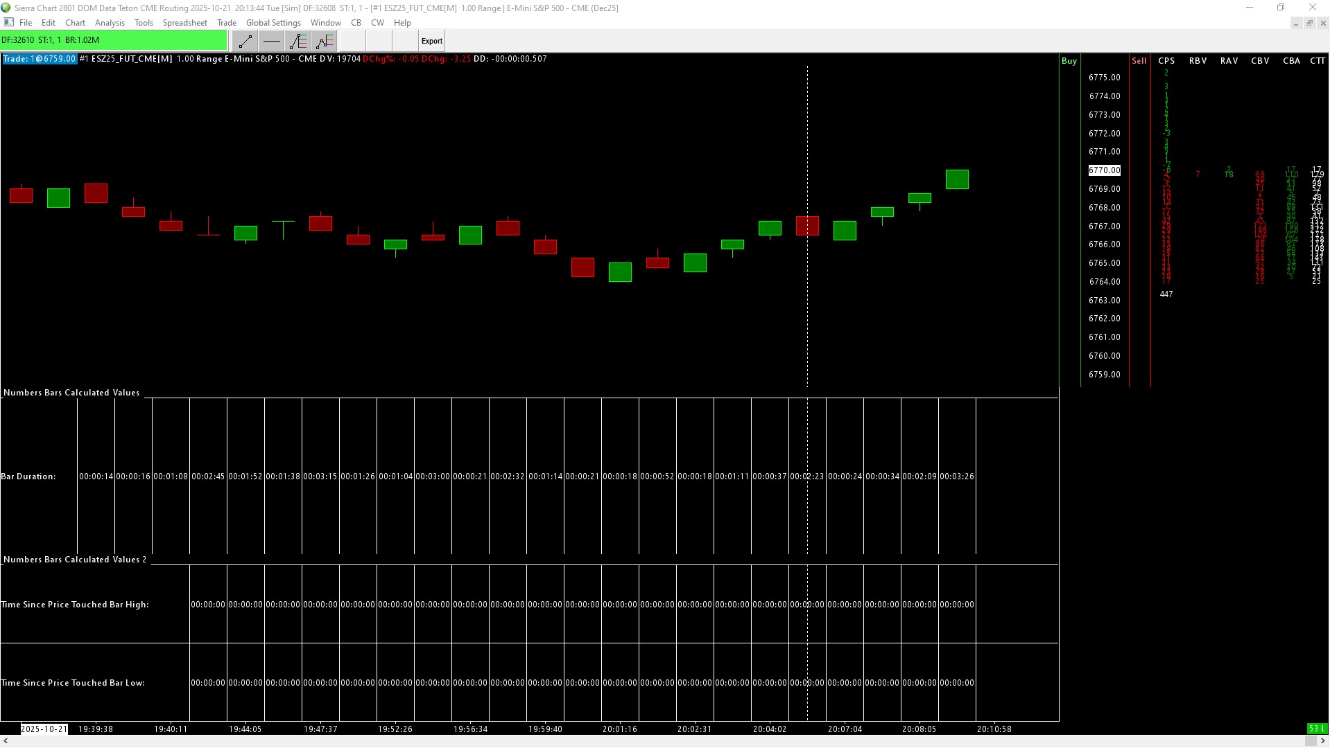

I am not getting any data in the NBCV2 Time Since Price Last Touched Bar High and Time Since Price Last Touched Bar Low subgraphs. A screen shot is attached. The vertical white line is the first new bar the subgraph should start being populated if I'm understanding correctly. I'm using a 4 Tick Range Bar (True). Please advise. Thanks! Mike

We are not seeing any issue with this functionality. We want to point out that the information will only be present for the bars that are added to the chart from when the Numbers Bars Calculated Values 2 study has been added to the chart. In other words, there is no historical information for this.
Are you not seeing the information update for the current bar?

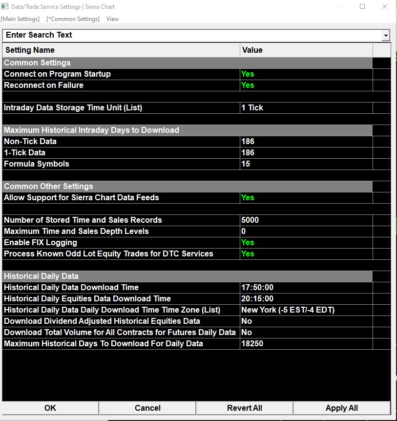

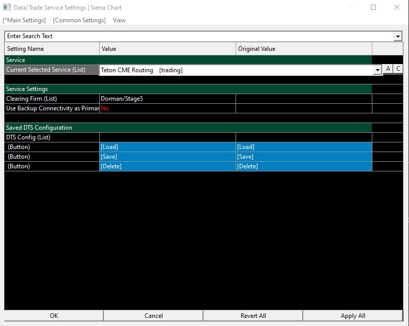

What is "Global Settings >> Data/Trade Service Setttings >> Common Settings >> Intraday Data Storage Time Unit" set to?
[2025-10-22 21:12:06]
TriStar Trading - Posts: 201
Both windows attached. 1 tick. I have another install on this PC. It is connected to Rithmic but it's using Denali. I verified by noting there is an [M] behind the contract name. I will try that also but need to wait for CME open. I'm writing an extract of SC DOM/Order Flow data to feed to AI for analysis purposes. I would never have thought to dig into NBCV2 otherwise. That study very well thought out. Thanks! Mike

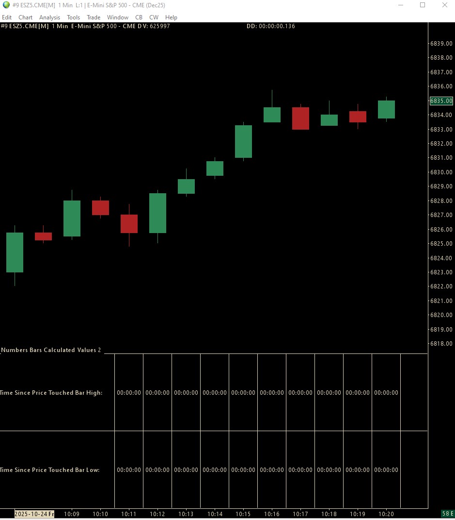

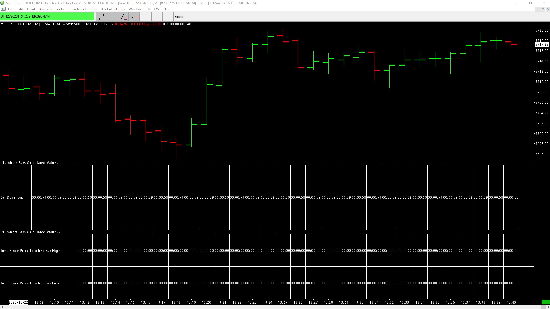

[2025-10-23 17:08:22]

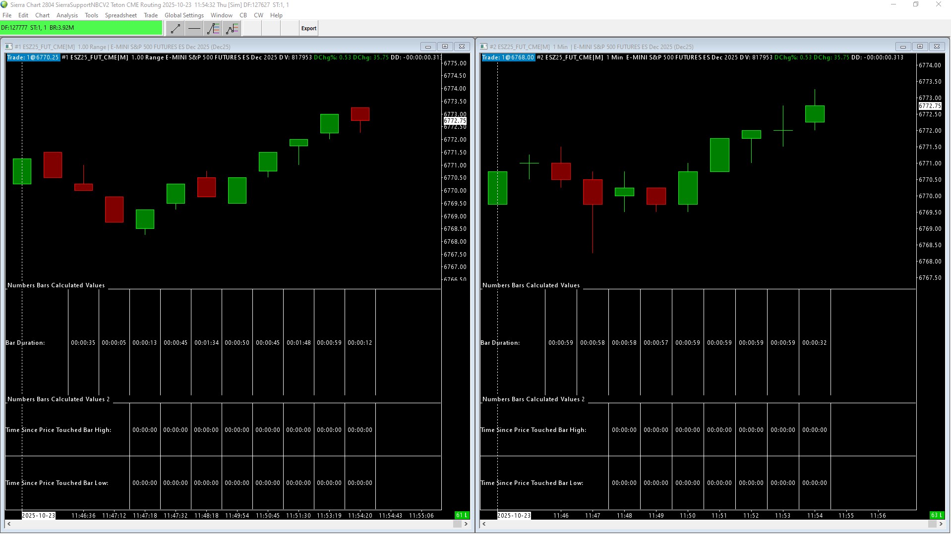

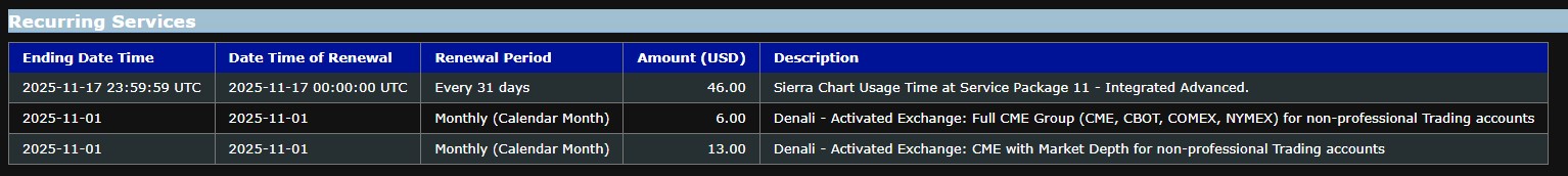

No Sir on the emulator. What I meant above about accumulating time was that one point the "Time Since" this morning was at like 15 hours and change. Now I am back to zeros. I've attached the chartbook and a screen shot. Once again, the vertical lines are the new bar we would expect to see data. FWIW I also attached my recurring services for data services. (Side question. I do not use market depth. I do however use DOM data. I was with the understanding I needed Market Depth for the DOM. Is that correct or not? Thanks! Mike

[2025-10-23 17:34:19]

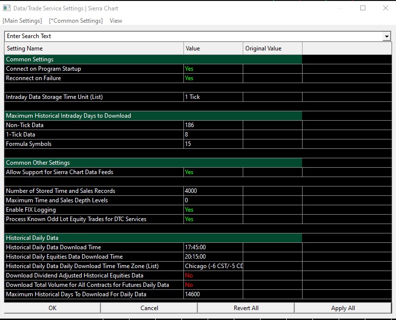

John - I am going to install a fresh copy of SC, make no changes at all, hook to Denali, and I'll use the Example Chartbook to test.
Works fine.
Chart screen capture and data/trade service settings attached.
I have multiple installs of SC I use every day. Each one has had the configuration files copied from the original install per the doco on transferring your system if that little tidbit helps. I assume then it has to be in my setup.

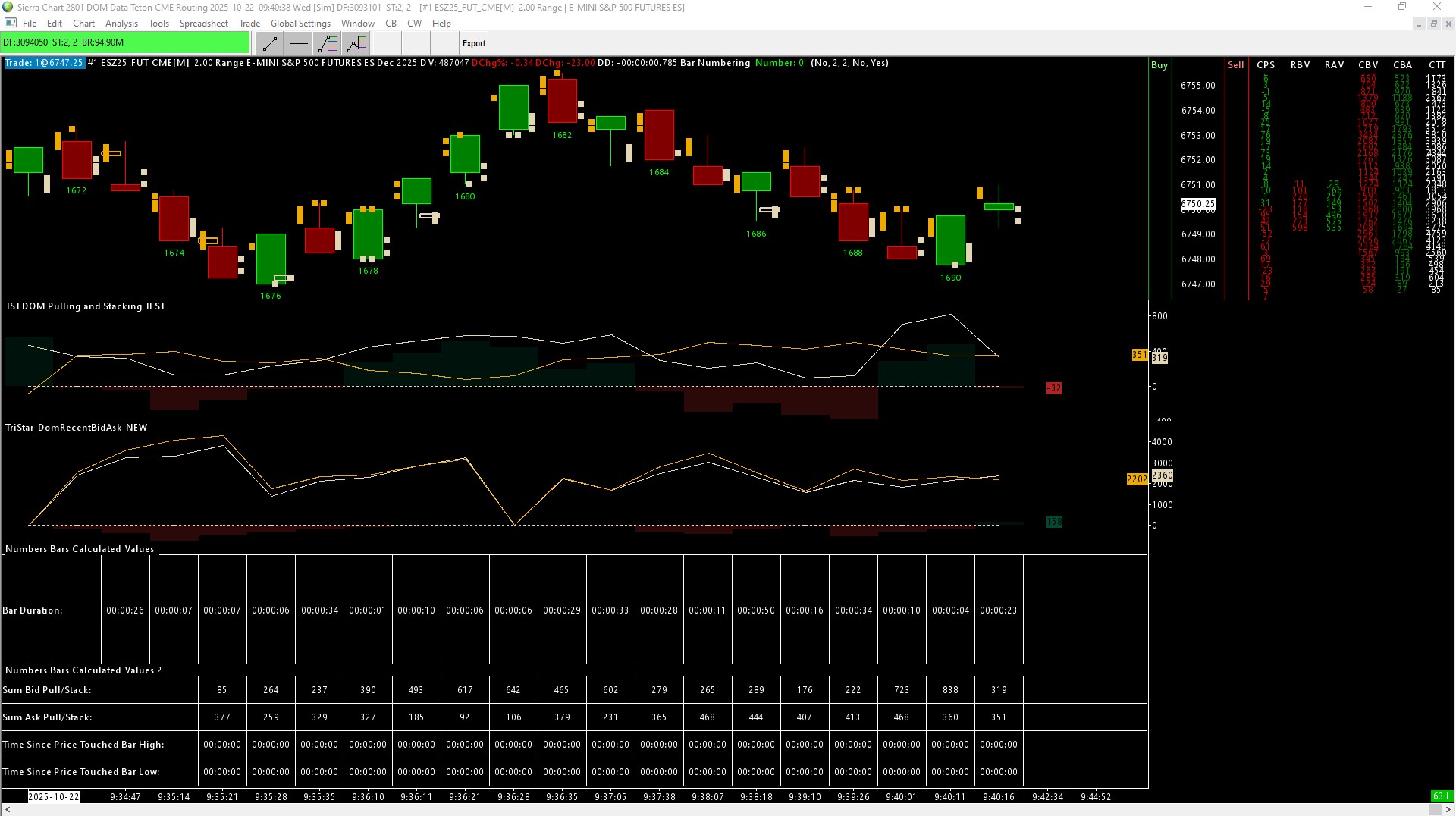

I have 2 of 3 installs working just fine here. Fortunately, one of them is the one I really need to have working. The one that isn't working is the config #2 file I posted above. The most heavily used install. I'm curious, you mentioned yesterday you saw a particular situation in that particular configuration where it did not work. Is that something I can try to fix on my end here? Or can you fix the configuration file and send it back? Is the issue in the config file? Thanks! Mike
