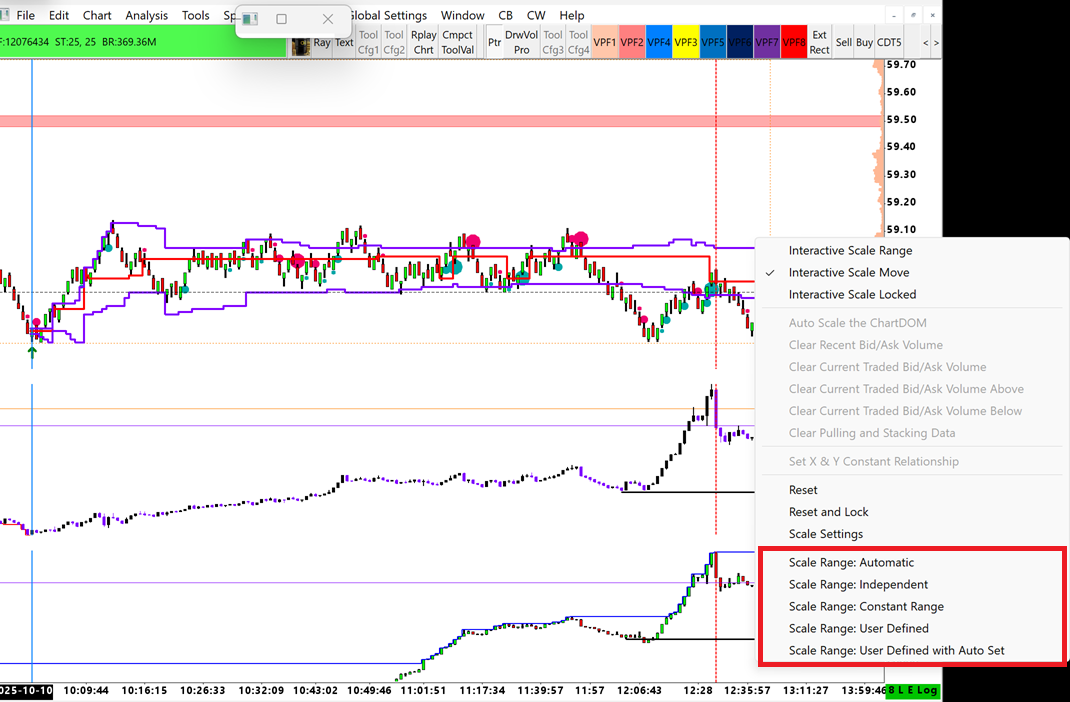

[2025-10-10 19:50:01]
Dan the Man - Posts: 111
This has happened many, many times.
I have 2 indictors loaded.
Only one of the indicator Scale range freezes up.
When I right click to select any of the option, it does not work.
When I go to Scale setting and select any of the option, it does not work.
Every time this occurs, I have to rebuild the chart.
I attached a screen image.
imageScale Range.png / V - Attached On 2025-10-10 19:49:47 UTC - Size: 193.91 KB - 255 views

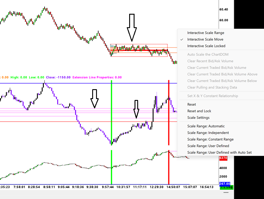

[2025-10-12 01:52:10]
I applied the Daily OHLC Single Point study to:
1) Cumulative Delta Bars Up/Down Tick Volume (region 2)
2) Cumulative Delta Bars (region 3)
The Draw Style is set to: "Background - All Regions" for both of them.
It works on the 1) but for 2) Cumulative Delta Bars the Draw Style does not plot to "All Regions".
I attached a screen image. Look at the bottom region. The red vertical line should extend all the way up to the 2nd region
imageDaily OHLC Single Point.png / V - Attached On 2025-10-12 01:48:45 UTC - Size: 505.8 KB - 245 views

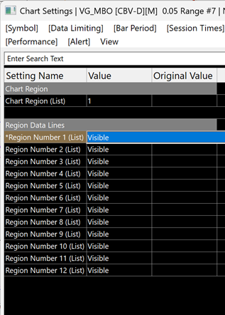

User677437 - Posts: 102
Dan I figured out what your problem is, in just a few minutes.
Go to chart settings. Go to regions. For some reason your default chart region for the main symbol is listed as chart region #3. It should be number 1. This is what is causing the scrolling problems and the bad UI look.
And granted there was no bar graphic setting picked in chart settings - bar period - graph draw type - your choice of candlestick, OHLC bars etc.
so you couldn't even see what the problem was.

[2025-10-12 05:03:48]
bud your chartbook wasn't even usable with the way the subgraphs were.
I don't know what version you're on. I'm on 2695 and on windows. I don't even see a way on my version to do what you want. There is no custom option, and not even a way to get to that coloring scheme.
My draw styles are visible or ignore.

[2025-10-12 10:18:22]
User431178 - Posts: 910
User677437 is using a version that does not have all the features you are using.
Maybe support will confirm, but it seems like "Background - All Regions" only draws in subsequent regions.
In other words, placing it in region 2 will draw only in 2 and greater, and placing it in region 3 will draw only in 3 and greater.
One workaround is to use study subgraphs reference to place the signals in the all in region 2.
You will need to run edit -> translate symbols to current service if you load the chartboos, as I changed the symbols to SC Data.
attachmentDulpicateMod.Cht - Attached On 2025-10-12 10:18:18 UTC - Size: 6.54 KB - 165 views
[2025-10-12 16:36:03]
Thank-you User677437 !
I would not have thought of that workaround. And thanks for the cht.
But, I still have the original issue that I started with.
I submitted a support ticket to support but somehow ended up on this Support Board.
My subject line was "Scale Range" because that was an issue I'm still having.
I am using your DulpicateMod.Cht and have the same issue.
These are the symptoms:
1) I right click the Range Scale in region 2, and set it to "Constant Range", it works, but when I apply a volume profile to the main chart (Region 1) the selected Range Scale in region 2 disappears.
Every time this occurs, I have to set it to "Constant Range" again.
2) In Region 2, in the Daily OHLC - Single Point study, when Draw Extension Lines is set to yes, the Draw Extension Lines are not removed when intersected as in Region 3.
These issues are only in region 2.
imageScale Range (2).png / V - Attached On 2025-10-12 16:35:50 UTC - Size: 140.23 KB - 237 views
[2025-10-12 17:15:32]
Hello, try this updated chart.
I think the problems you describe were both due to the order of the studies in the studies window and the individual scale settings.
1) Now when you add a a drawn-vp the scale setting is retained
2) The lines now appeare to intersect as expected
attachmentDulpicateMod.Cht - Attached On 2025-10-12 17:15:29 UTC - Size: 6.23 KB - 164 views
