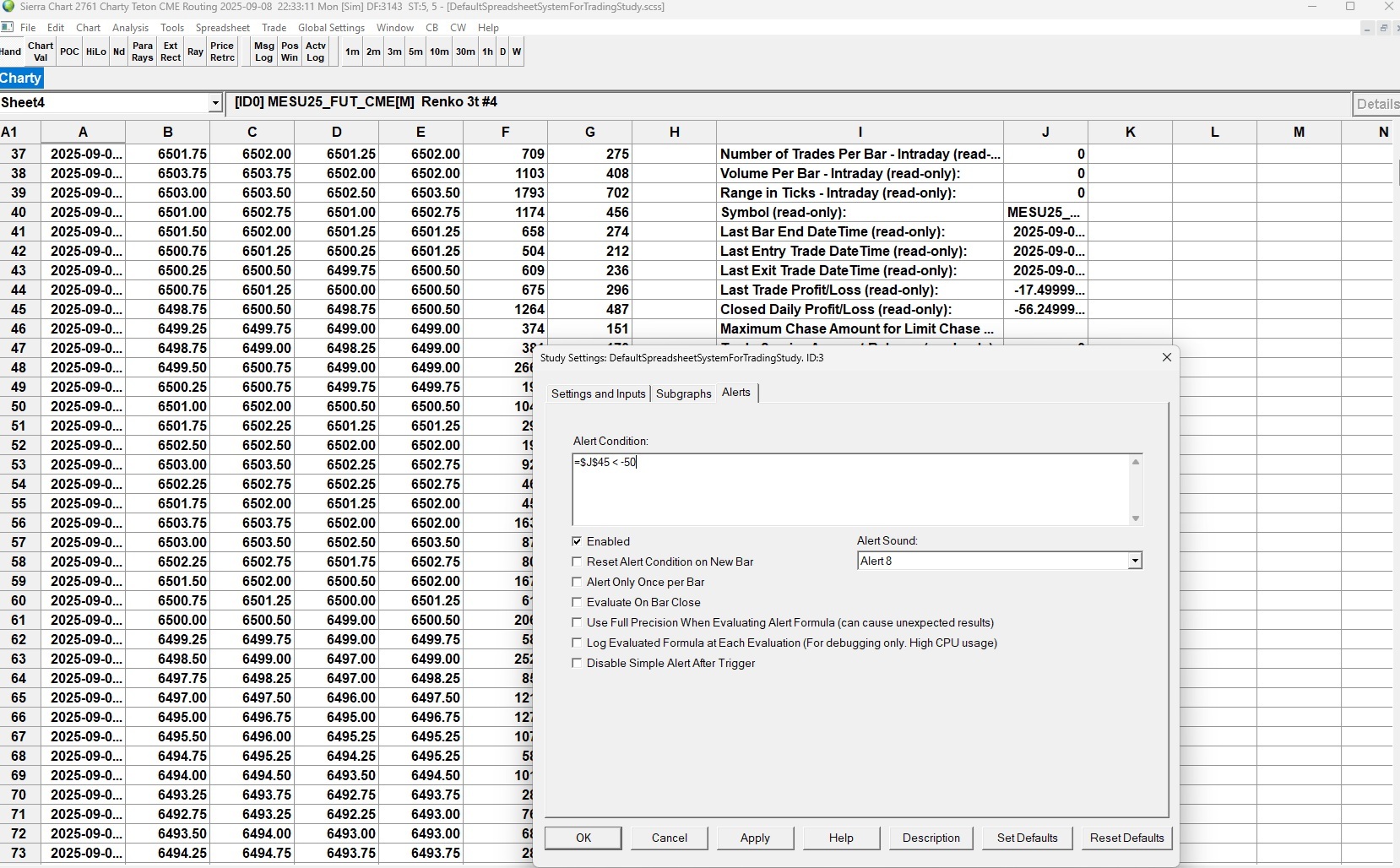

See_Era - Posts: 5
Thanks for the reply, John.
Unfortunately, I'm not getting it to work. I attached a screenshot of the alert tab dialog box with the formula, sitting on top of the 'Spreadsheet system for Trading study', so no alarm sounds when j45 < -50 even when that condition is met since the value on the spreadsheet is -56
imagealertsetup.jpg / V - Attached On 2025-09-08 20:40:56 UTC - Size: 575.3 KB - 271 views
[2025-09-08 21:47:08]
The Spreadsheet System for Trading and the Spreadsheet System/Alert both have capabilities for alerting within the spreadsheet itself. You do not need to use the "Alerts" tab of the settings window in order to do this.
Find an unused formula column in your Spreadsheet System for Trading and enter the following in row 3 of that column:
=$J$45 < -500
Then on the Settings and Inputs tab of the Settings window for that Spreadsheet System for Trading, find the "Column ? Alert" entry for the column where you entered this formula and select the Alert Sound you want to use for it. You will then get an alert sound when the "Closed Daily Profit/Loss" is less than -500. Refer to the following:
Spreadsheet Systems, Alerts and Automated Trading: Column [K, L, M, N, O, P, Q, R, S, T, U, V-Z] Alert
If you want something visual, then you would want to add a "Color Bar Based on Alert Condition" study and reference the subgraph that represents that column. Refer to the following:
