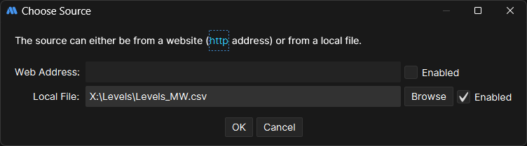

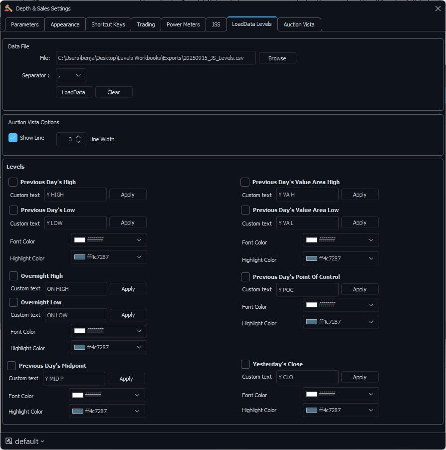

I create my levels using spreadsheets & Excel, then save the sheet w/ the levels as a .csv. I open the text file & select all of the level prices, copy them, then go into the Trading Levels Backend input page, paste them in, then return to or open the chartbook, & recalculate.
What we would like to see in an updated version of this study, is the ability for the TL study to be pointed to a .csv file from the settings. The .csv file is updated/replaced when saving the levels from the Excel Spreadsheet. This saves a lot of time manually opening the file, carefully copying just the numbers needed, logging into SC's TL Study backend, editing the field, pasting the new levels in, then saving the page, double checking that it 'took'. When doing this for more than one market- it can be quite time consuming, even with a routine.
Currently, we use this exact method in MotiveWave & Jigsaw Daytradr. A macro has been created to export the new levels every day from Excel to a .csv file with one 'click', so once Excel has done it's work - Excel can be closed & the levels are now on the charts on those two platforms.
In MW, it is through a study called "Cloud Levels".. In Daytrader, it is accessed through the Settings on each instance of a DOM, on a page called "Load Levels". Attached are screenshots of each to illustrate.
Hopefully this method can be added to the Trading Levels Study as an option, versus this being a suggestion to replace the current method for placing levels in the Study.

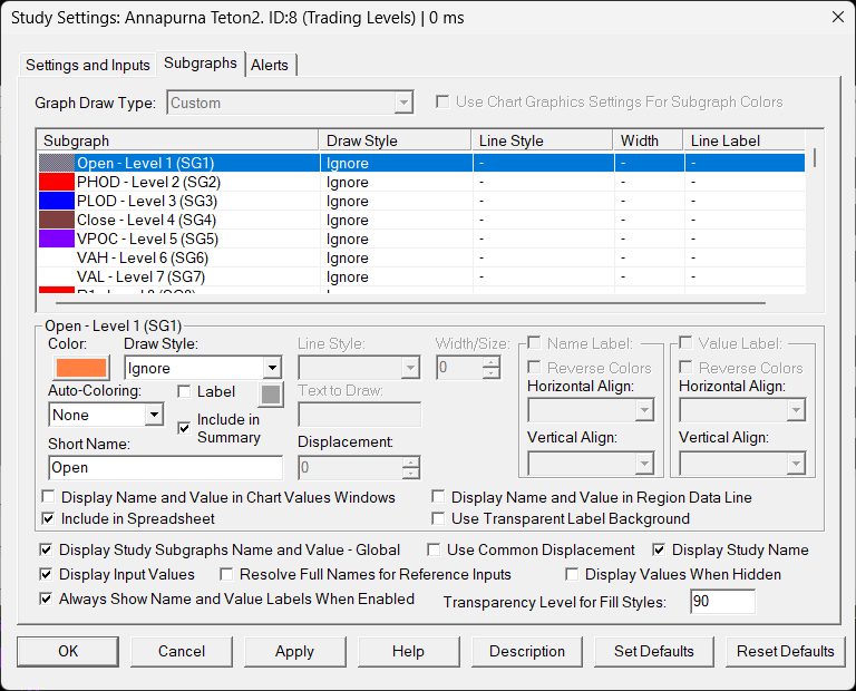

A new but similar anomalous issue has appeared in the past 2 days.
Firstly, in troubleshooting, I updated to the latest version. Also tried on other charts with the same results. I've searched the forum. I've loaded backup chartbooks. I have different versions of this study saved under the "Analysis" tab. All of them behave the same way.
The symbol is correct & matches the server side info. The dates are within expiration for the study.
It started when the Trading Levels did not appear on a chart that is a 'go to' chart for visualizing the Trading Levels.
Prior to this, it was only the one type of draw style that would unexpectedly reset. But at least it reverted to 'line'. Now (see attached), they all go to "ignore".
Look forward to your thoughts. I am bothered that no one else seems to have experienced this the past few days. But I can't work out what is wrong on my end.
Thank you,
Ben

There is no obvious reason for the Subgraphs Draw Style to be changing as you are seeing.
The only reasons for something like this to occur would be the following:
- You are using the Linking option between charts for "Studies" and then actually changing the Draw Style in another chart.
- You have a custom study that is causing the change.
- You are using a Study Collection and adding the collection again, where the Study Collection was setup with the Draw Style of "Dash" or "Ignore".
There has to be something occurring that is causing this change. There is no way this would be changing without some stimulus to cause it to do so.
There is one other thing that this could be related to, which is that the "Trading Levels" input has 3 different options for how the data is set:
- Date, RepeatingValues
- Date, Label, Color, Width, Value
- Date, Label, Color, Width, TopValue, BottomValue
If the third option is used (Date, Label, Color, Width, TopValue, BottomValue) then this will change the Draw Style to be "Transparent Fill Rectangle Top" and "Transparent Fill Rectangle Bottom" for the TopValue and BottomValue respectively.
So if you are using this format, then it would change the Draw Style, but it sounds like it would be what you actually want.
