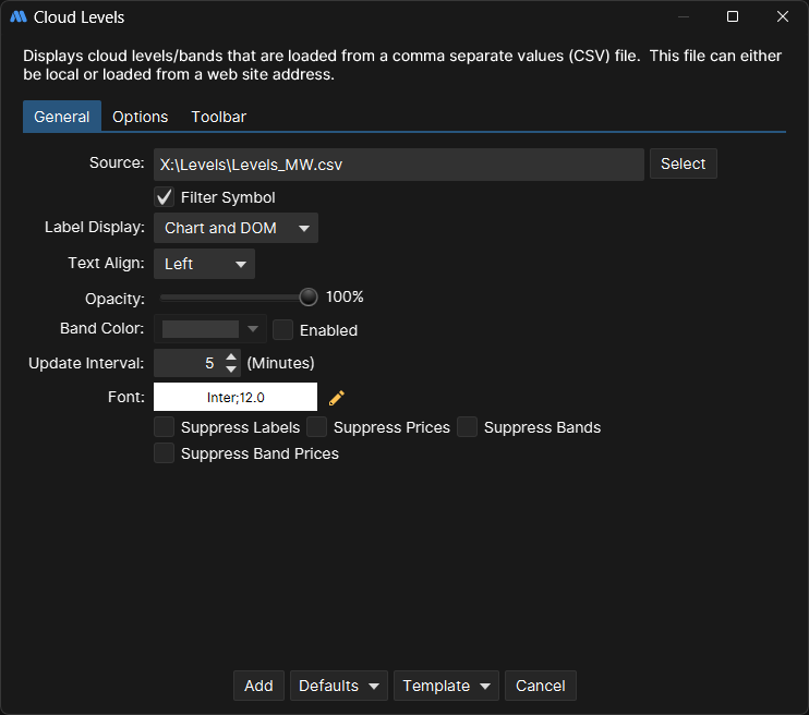

What we would like to see in an updated version of this study, is the ability for the TL study to be pointed to a .csv file from the settings. The .csv file is updated/replaced when saving the levels from the Excel Spreadsheet. This saves a lot of time manually opening the file, carefully copying just the numbers needed, logging into SC's TL Study backend, editing the field, pasting the new levels in, then saving the page, double checking that it 'took'. When doing this for more than one market- it can be quite time consuming, even with a routine.
Currently, we use this exact method in MotiveWave & Jigsaw Daytradr. A macro has been created to export the new levels every day from Excel to a .csv file with one 'click', so once Excel has done it's work - Excel can be closed & the levels are now on the charts on those two platforms.
In MW, it is through a study called "Cloud Levels".. In Daytrader, it is accessed through the Settings on each instance of a DOM, on a page called "Load Levels". Attached are screenshots of each to illustrate.
Hopefully this method can be added to the Trading Levels Study as an option, versus this being a suggestion to replace the current method for placing levels in the Study.
