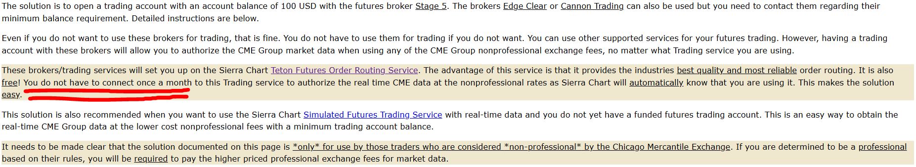

[2025-06-03 14:33:36]
TampaTrader24 - Posts: 9
John, thank you very much.
Confirmed that I do not need Market Depth in this case. Looks like my exchange will be the $3/mo CME Non_Professional Top-of-Book
I read your link but I am confused because here it says that I do not need to connect once/month. Please see the screenshot I've uploaded in the attached file. Can you please confirm whether or not I need to connect once/month?
If the file does not properly attach, here is the copy & paste:
These brokers/trading services will set you up on the Sierra Chart Teton Futures Order Routing Service. The advantage of this service is that it provides the industries best quality and most reliable order routing. It is also free! You do not have to connect once a month to this Trading service to authorize the real time CME data at the nonprofessional rates as Sierra Chart will automatically know that you are using it. This makes the solution easy.
Afterwards, can you please confirm the following in total?
1. Stage 5 = I will open an acccount?
2. Service Package = sign up for Service Package 11?
3. Exchange = sign up for $3/mo CME Non_Professional Top-of-Book?
4. If I use Stage 5 trading, do I still need to sign up with Interactive Brokers and connect that to Sierra?
5. is there anything else I need to do? I will await your answer on the once/month and on these three.
Thank you so much, John.
imageJohn.JPG / V - Attached On 2025-06-03 14:27:10 UTC - Size: 173.11 KB - 346 views
[2025-06-03 17:14:55]
John - SC Support - Posts: 48555
If you are specifically setup on the "Teton Order Routing Service", then you do not need to go through the connection once a month. But if you use a different order routing service (CQG or Rithmic) or connect to Interactive Brokers, then you will need to go through the process.
1. That is fine.
2. Package 11 is good.
3. This is fine.
4. You do not need to setup an account with Interactive Brokers. The account with Stage 5 will work to satisfy the CME Group Non-Professional requirement.
5. Nothing else, apart from actually doing the setup.

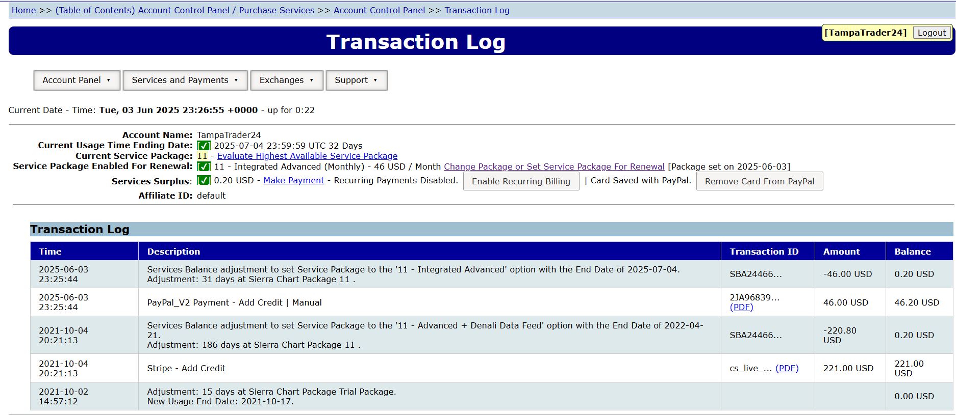

[2025-06-03 23:30:08]
Hi John - I'm halfway there but ran into an issue with Sierra not recognizing my balance? Please see the attached screenshot.
My balance was just $0.20 cents and I selected Service Package 11. I was prompted to make a payment of $46 which I did.
But now it says I still have insufficient balance of $0.20 cents. Can you please help me with this, push this through?
Also, now how do I go ahead and pay for the Exchange? I cannot find the link to actually PAY for this.
Lastly, I signed up for Stage 5. I should be receiving confirmation from them within 24 hours. Sierra website said they will automatically link between Teton, so there's nothing else I'll have to do after that?
Thank you!
imagefor John.JPG / V - Attached On 2025-06-03 23:28:09 UTC - Size: 235.77 KB - 337 views

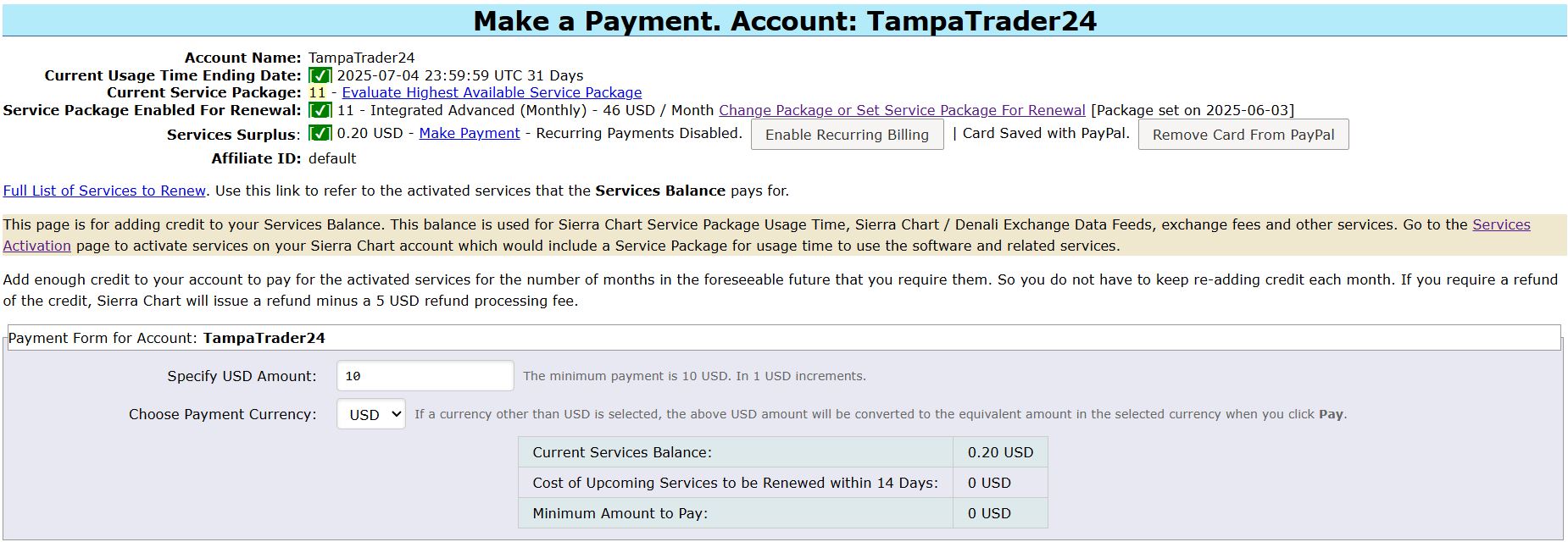

[2025-06-04 16:13:27]
Hi John! It looks like my Service Package 11 is active and confirmed, right? Please see screenshot
I should be fully approved with Stage 5 today and will fund that account with the $100 immediately.
from Stage 5:
Once the application is approved and account is funded we will get your Stage 5 account linked to your Sierra Chart user on their Teton order routing. You’ll then update your Data/Trade Service Settings to the info we give you and can then connect. It’s a very easy setup and we can help out if you run into any issues.
My remaining question right now to you is, how exactly do I sign up for the Exchange$3/mo CME Non_Professional Top-of-Book?
I can see it listed with all the other exchanges, but I cannot find out how to actually select and pay for it.
Thank you!
imagefor John.JPG / V - Attached On 2025-06-04 16:09:55 UTC - Size: 194.08 KB - 328 views

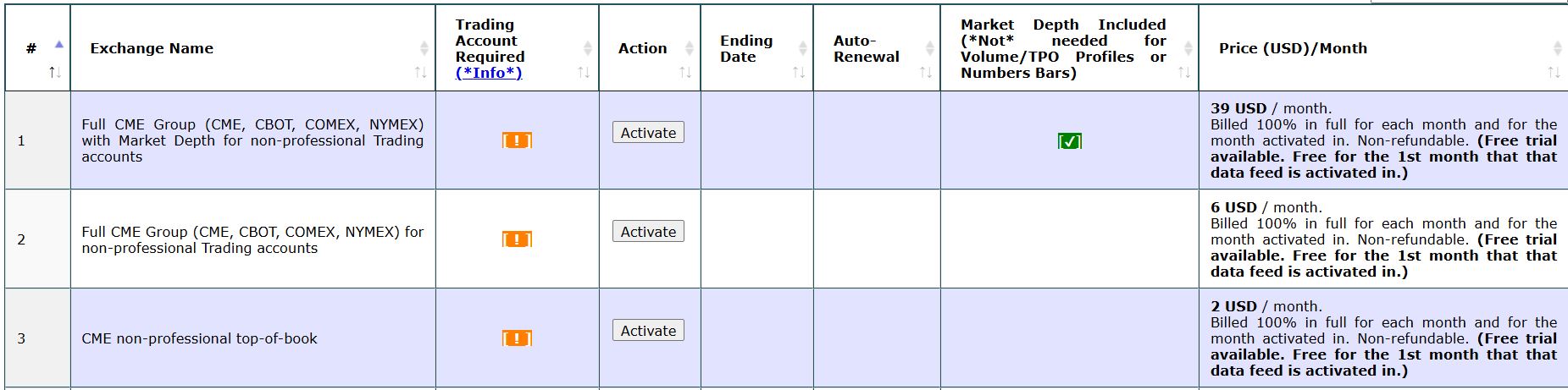

[2025-06-04 16:19:05]
Ah I've found the page to purchase the exchange. If I only need LIVE DATA for the ES, I select #3, is that correct? Screenshot is attached.
I will still have delayed data for everything under COMEX, NYMEX and CBOT under #3, I just won't have live data for that, correct?
imagefor John - exchanges.JPG / V - Attached On 2025-06-04 16:15:44 UTC - Size: 133.74 KB - 276 views
[2025-06-04 17:31:59]
The "CME Non-Professional Top-of-Book" is all you need if you only need data for symbols traded on the CME exchange and you do not need Market Depth data (which you do not need for the TPO).
Since this is your first time using the data for the CME Group from our Denali Exchange Data Feed, you will not be charged when you activate the exchange. You get the remainder of the month in which you activate the exchange for free. So you will not need to pay the $3.00 for the exchange fee until July 1, 2025.
The data for the exchanges that make up the CME Group (CBOT, COMEX, and NYMEX) will be delayed streaming data for your account.
