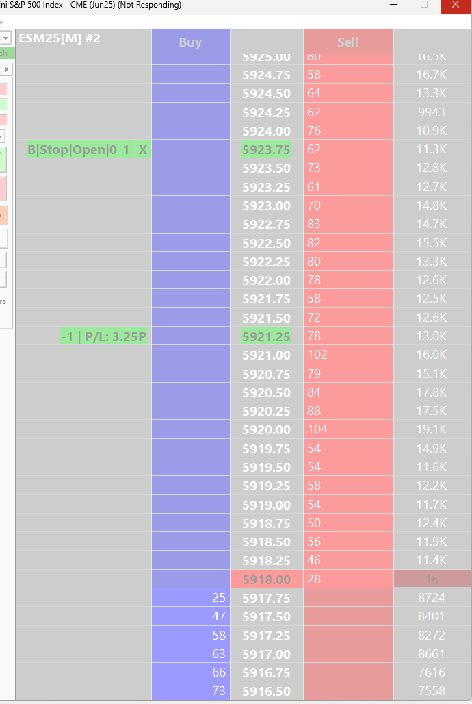

I'm using the Denali via the Trade Evaluator[trading] connection.
My system is fully automated.
Today I noticed when orders were executed (i.e. filled not working) the platform would freeze.
After a couple of instances of this I disabled my automated system and then attempted to executed orders manually to check if it was isolated to the system.
The same behavior occurred when executing manually.
The system completely locks up for a significant amount of time.

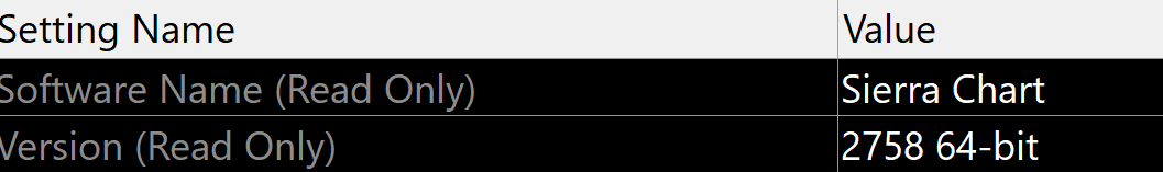

I've attached a screenshot of the behavior as well as the current version I'm running.
I have recordings of the behavior as well. The system is non responsive for multiple minutes.
How can I alleviate this issue?

[2025-05-29 16:18:31]
We suspect that this is a remnant from your trading study. If it was still loaded, then it is possible that it is causing this issue.
Please restart Sierra Chart in "Safe Mode" and then try to place a manual trade with the Trading Evaluator. Safe Mode will not allow non-core studies to be run (you don't have to remove the study itself). If this works, then the next test would be to fully remove your study from all charts and then see if you have an issue placing a manual trade.
If you do not have an issue in the last situation we describe, then we would have to believe it is related to your study.
Refer to the following for how to start the system in Safe Mode:
Sierra Chart - Software Login Instructions: Using Safe Mode
[2025-05-29 16:30:29]
Gradient - Posts: 219
Thanks.
Prior to your response I restarted the platform and reopened the chartbook my system is running on and didn’t experience the issue.
My system had been up for a couple days as it will only trade during specific market hours.
To alleviate the possibility of this issue reoccurring would you suggest restarting the system after each session?
