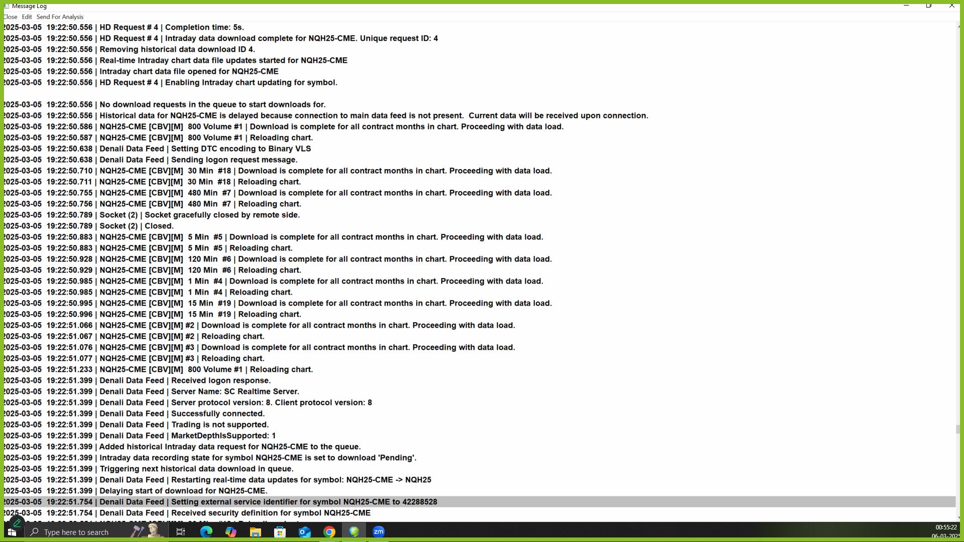

I have a live account from a Stage 5 broker. And I connected using SC data service.
And still not able to get the live data feed.
Please refer to the Screenshot attached.

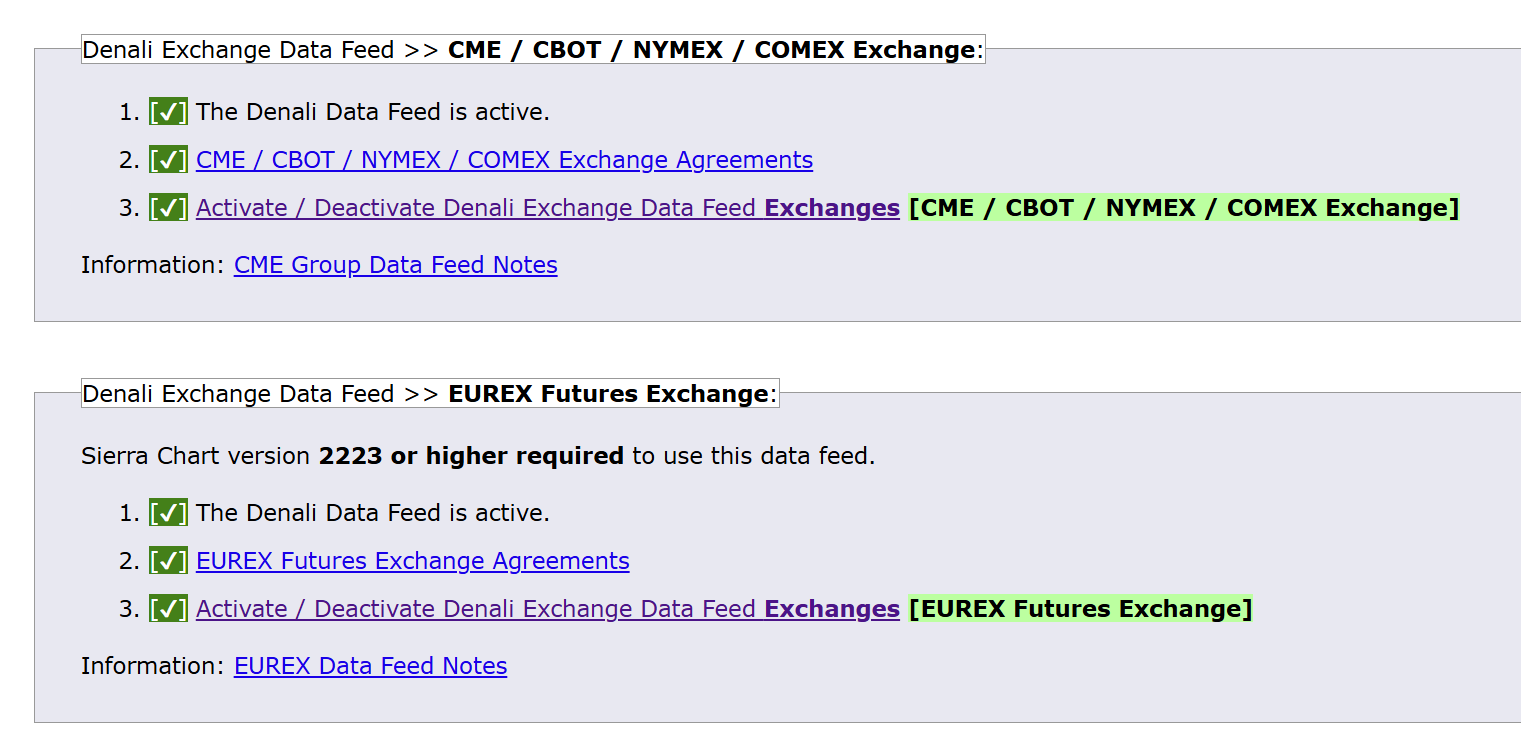

I am using the Denali Exchange Data Feed.

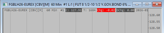

My EUREX data has been active for a long time and works smoothly (see attached screenshot: “live”).
Today, I activated the CBOT / CME / COMEX bundle (see attached screenshot: “activated”).

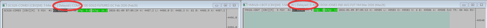

However, within my Sierra Chart instance, I am only receiving delayed data for these newly activated markets (see attached screenshot: “delayed”).

The reason you are not getting real-time data from the Denali Data Feed, and historical data from the Denali Data Feed in the case of when using an external Trading service (Rithmic, CQG, Interactive Brokers), from the CME Group of exchanges, is that you activated the *Non-Professional* exchange fees. However, you have not verified in the last month that you have a live, funded, futures trading account, which the CME needs in order to allow you data at the lower priced fees.
Refer to the "Understanding and Accessing Data From the CME, CBOT, NYMEX, COMEX Exchanges" section here:
Real-Time Exchange Data Feeds Available From Sierra Chart: Understanding and Accessing Data From the CME, CBOT, NYMEX, COMEX Exchanges
Rithmic paper trading or trading evaluator accounts are not considered a live funded futures trading account.
Refer to the following for instructions on how to connect once a month to your *live funded* trading account to qualify for the lower-priced exchange fees:
If you do not have a funded trading account or one with a supported Trading service, then refer to this solution:
Easy Solution to CME Funded Trading Account Requirement
Consider the above solution to avoid this problem in the future.
