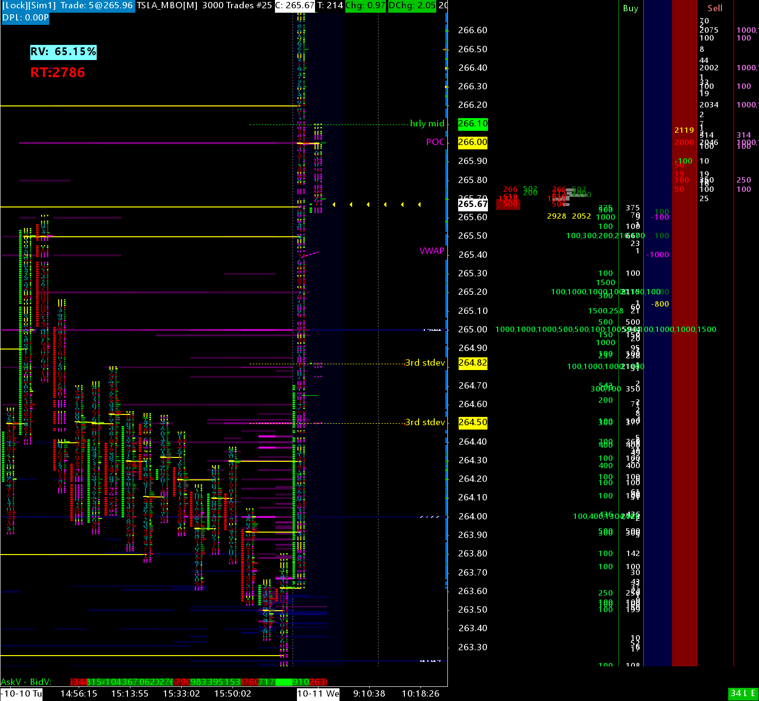

I am primarily looking at TSLA_MBO I was having the issue yesterday and before. I switched data/trade services today and noticed that it was working and I believe I figured out why it was not showing depth. I have a symbol setting of minimum market by order quantity set to 2000. On the -NQTV chart this has the intended effect of filtering out mbo orders below the threshold. However I still see the market depth. When I put the same setting on the _MBO chart it seems to filter out all depth except the first level. I would think the behavior should be consistent across these charts. What is the rule for when a stock is automatically added to the symbol settings list? It seems like TSLA-NQTV was added but TSLA_MBO was not. |

I will try and attach screenshots tomorrow. But the reproduce on my end is simple. Just add 2000 to the value for TSLA_MBO symbol and the market depth column goes down to depth 1. This does not happen on TSLA-NQTV. Can you see if that happens for you?

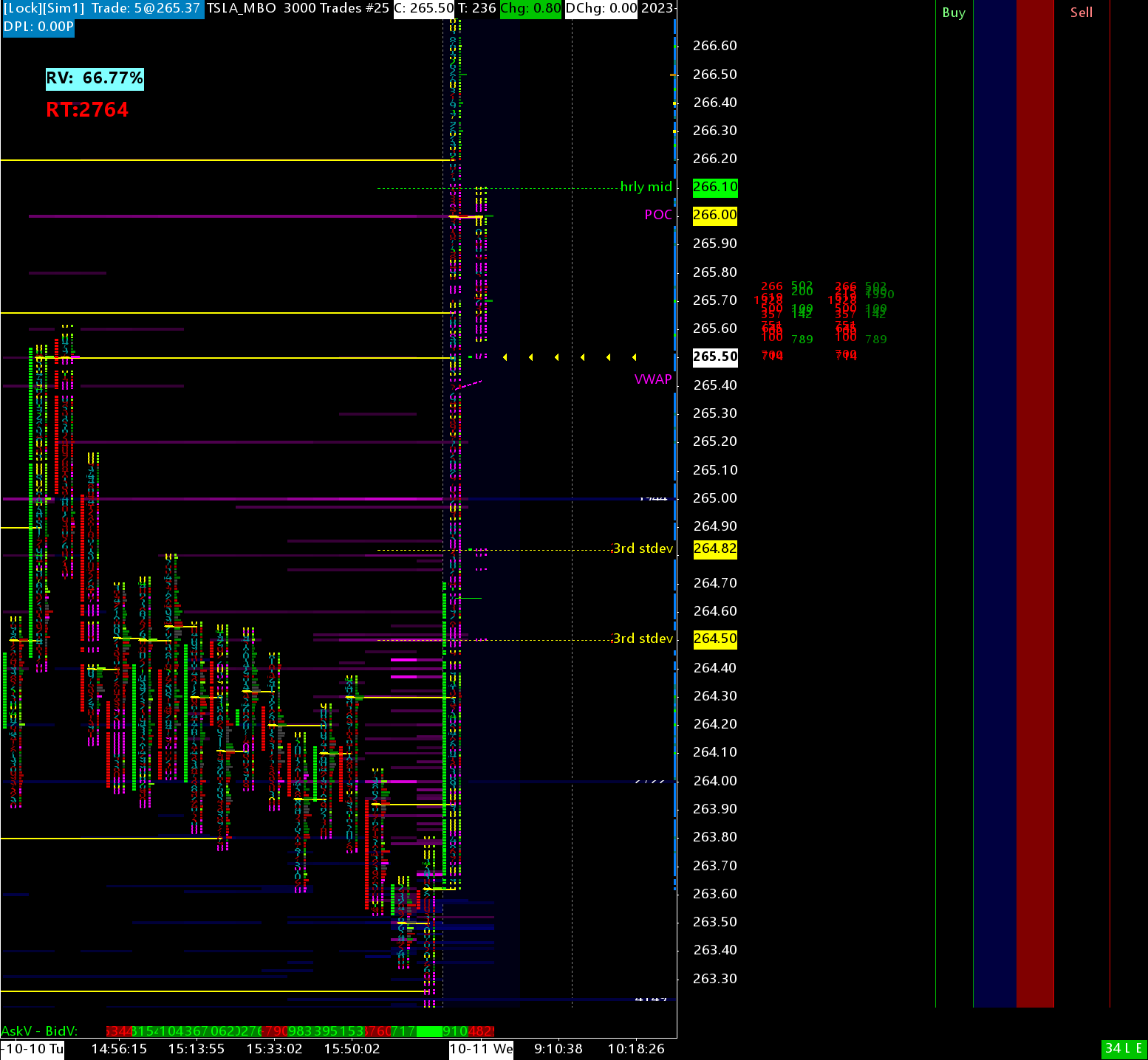

Here is what I noticed in trying to reproduce. The action of just creating a new symbol setting for the TSLA_MBO symbol then removed the depth data. I did not set the minimum market by order quantity to any value. When i disconnect and reconnect, the market depth is gone See images below: https://www.sierrachart.com/image.php?Image=1697026830470.png https://www.sierrachart.com/image.php?Image=1697027034258.png I also duplicated the symbol settings I had for TSLA-NQTV (which shows depth just fine) using the duplicate button. And this also removed the market depth on the chart I also noticed after adding any symbol setting to the TSLA_MBO symbol, once i disconnect and reconnect it does not show any change to the chart, as if it has stopped receiving updates entirely. Other charts will show at yellow banner in the middle saying updating historical data. But the TSLA_MBO chart didn't. Removing the symbol setting entry and then disconnecting and reconnecting the data feed will restore market depth |

One problem we became aware of is that market by order data is not provided for_MBO symbols from all servers. That will be resolved. No do not do this! This is the source of the problem: I also duplicated the symbol settings I had for TSLA-NQTV
You can only duplicate _MBO symbol settings and then disable pattern matching. Sierra Chart Support - Engineering Level Your definitive source for support. Other responses are from users. Try to keep your questions brief and to the point. Be aware of support policy: https://www.sierrachart.com/index.php?l=PostingInformation.php#GeneralInformation For the most reliable, advanced, and zero cost futures order routing, use the Teton service: Sierra Chart Teton Futures Order Routing Date Time Of Last Edit: 2023-10-11 13:53:05

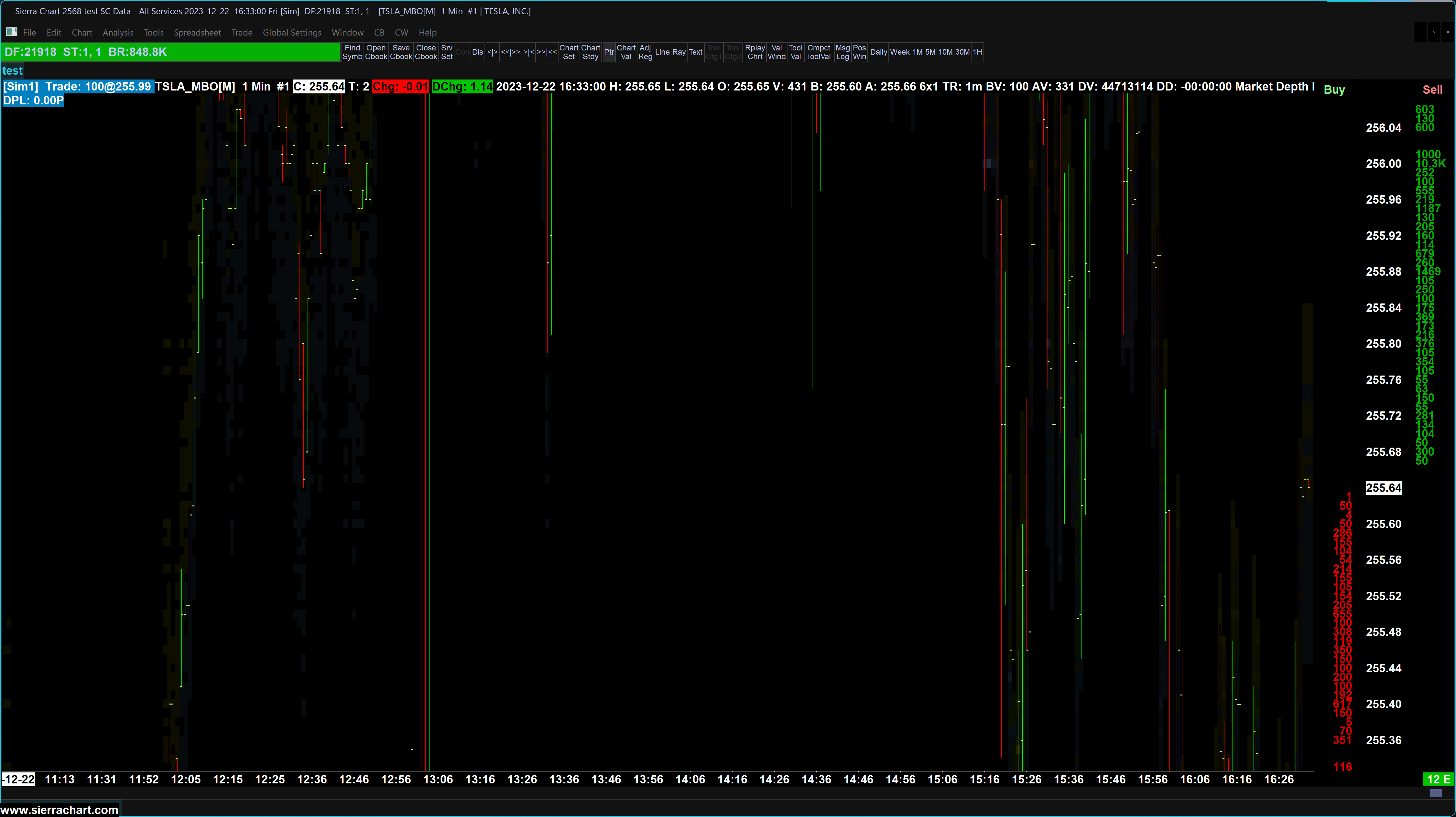

After a ton of testing I think I finally figured out the cause of my intermittent issues getting the book depth to display in DOM on _MBO symbols. If I have a chart in my chartbook that has the "Market Depth Historical Graph" study loaded, it will not load the depth for that symbol. Oddly, if I load the chart dom first without the study, (and it loads the depth correctly as mentioned above), THEN I add the study, everything works fine. I've reproduced this multiple times, and is definitely the cause of my specific issue. I'm still on build 2561, so not sure if this has been fixed, but didn't see anything in the release log about it. @John if you would like more details for a possible bug investigation, let me know. Happy to assist. *EDIT*: Also, upon further investigation, it seems that having other charts, studies (not even market depth studies), loaded in the chartbook will also sometimes cause the chart dom to not display market depth. So it's not just limited to the market depth study. However, the market depth study is the most direct, consistent, and easily reproducible issue. That can be seen just by one chart dom in the chartbook, and having no studies (works fine) or load with the market depth study (stops proper depth load). Hopefully this is something that is just happening to me, but sharing here in case it's a larger issue that others are reproducing. And FWIW, I have zero issues on CME books with all the same types of charts and studies. This only happens when connected to the IB service/API via SC, not if I'm connected only to SC DATA. Date Time Of Last Edit: 2023-12-20 21:08:07

I will be sending you a message log for analysis now. It has some odd lines in there that may be helpful in diagnosing. Really appreciate any help here as this is a significant issue for me. Steps I've taken to get here: 1: Fresh install of SC 2568 2: Connected to my SC account 3: Loaded a chart dom for TSLA_MBO 4: Added the Historical Market Depth Study 5: Disconnect/reconnect to ensure reload - Market depth displays properly at this point 6: Enter my IB details, connect to that data/trade service 7: Convert symbols as prompted - Market depth does not load on the chart DOM. Basically as detailed above, depth loads fine when only connected to SC. When connected via IB, depth does not display when there is a historical market depth study, or other charts that may also cause a break. Steps above were to simplify things. Date Time Of Last Edit: 2023-12-20 23:56:03

| [2023-12-22 16:34:39] |
| methodtrades - Posts: 48 |
Here is the image you requested (IB connected, with market depth study on the chart): https://www.sierrachart.com/image.php?Image=1703262580688.png -- Here is an additional image showing the same chart and settings on the SC Data service only, with the market depth study. This is also how it looks when I connect to IB, with no market depth study on the chart: https://www.sierrachart.com/image.php?Image=1703262781456.png |
