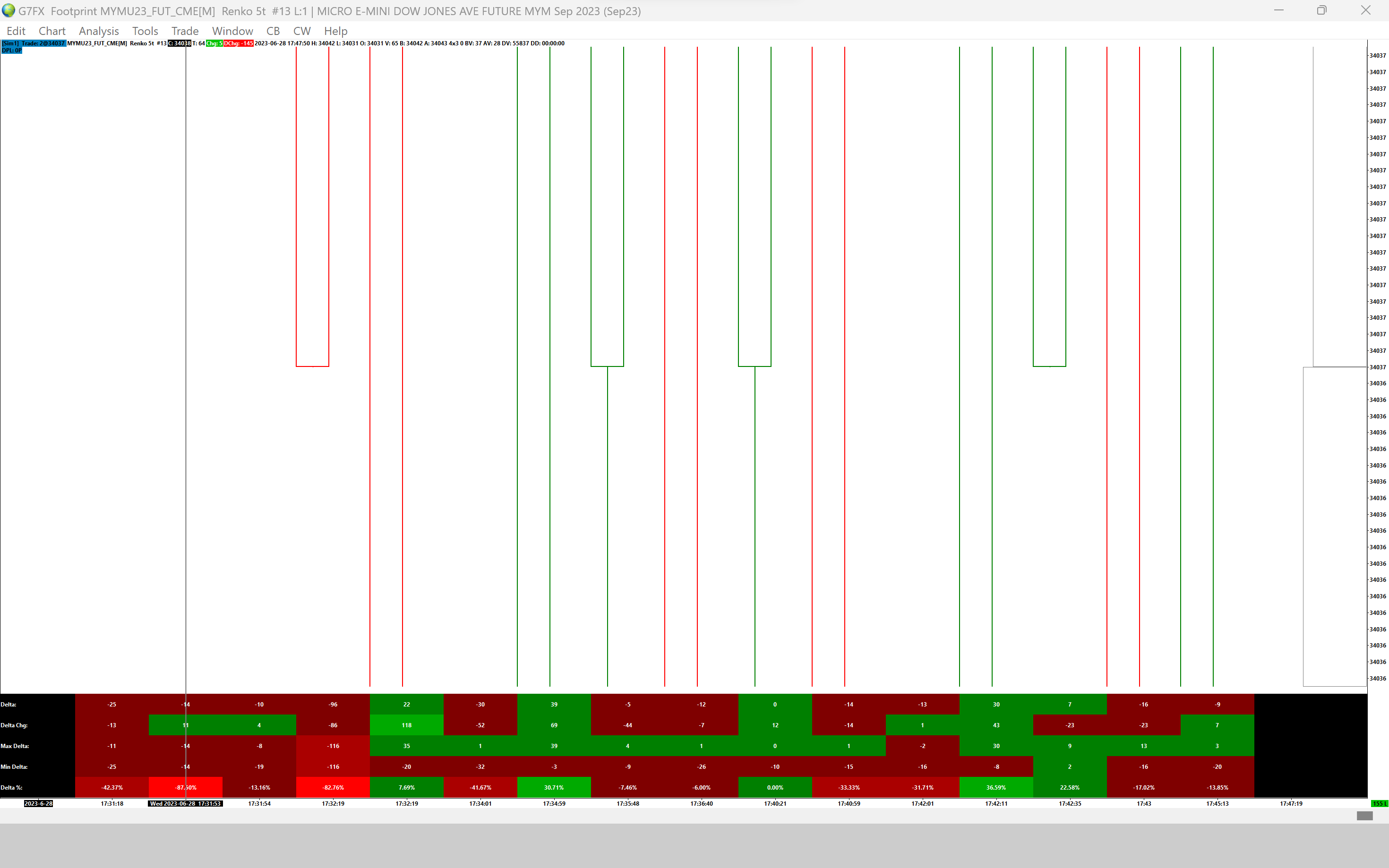

[2023-06-28 17:50:35]
jomar - Posts: 19
okay they are sorta starting to work, i think the data was just slow to load.
But now the bars are all out of scale, how do i fix this (screenshot attached)
imageScreenshot 2023-06-28 104809.png / V - Attached On 2023-06-28 17:49:55 UTC - Size: 172.96 KB - 534 views
[2023-06-28 18:41:57]
John - SC Support - Posts: 48556
Start by setting the scale to Automatic and the resetting the scales. Refer to the following:
Chart Scale and Scale Adjusting: Opening the Scale Settings Window for the Main Price Graph
Chart Scale and Scale Adjusting: Automatic (Scale Range)
Chart Scale and Scale Adjusting: Resetting the Scale
