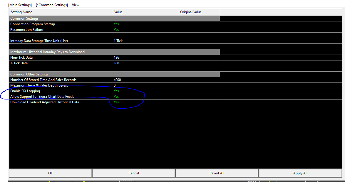

Also I followed those direction and in Sierra chart platform, all I have to do say "Yes" to "Allow Support for Sierra Chart Data Feeds", correct? as shown in the attached file.
imageSC Exchange Feed.PNG / V - Attached On 2021-04-28 00:35:56 UTC - Size: 24.59 KB - 394 views
[2021-04-28 02:08:34]
You currently have the Sierra Chart Exchange Data Feed and have activated the CBOE Indices exchange.:
https://www.sierrachart.com/index.php?page=doc/SierraChart_RealTime_And_Historical_Symbols.php&SymbolsPage=Indices#INDEX-CBOE
And you have the Denali exchange data which includes the entire CME Group. Those would be the symbols listed under File >> Find Symbol >> Futures (Specifically the CME group of 4)
Yes this is correct.

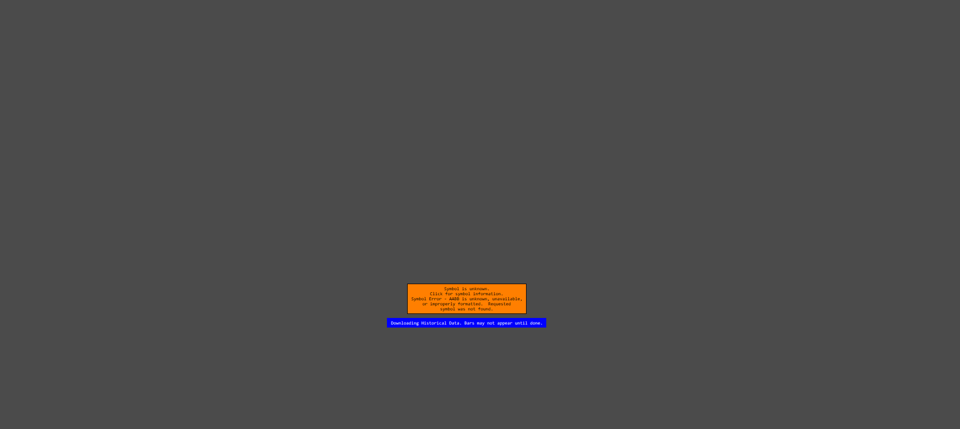

Thanks, I still don't know how to access the FINRA data in SC?
Also, I took one of the symbols and tested in the feed and I got the following errors (see screenshot attached).
imageAABB.png / V - Attached On 2021-04-28 16:16:31 UTC - Size: 11.33 KB - 369 views
[2021-04-28 16:24:53]
The reason you got the above error is because any data that you are not specifically getting from us is looking to come from CQG, since that is what your Service is set to. I made a mistake in my earlier statement about having access to the Historical data, although you can get it if you install a separate instance of Sierra Chart and set the Service to SC Data - All Services.
Therefore, you would have to subscribe to the U.S. Equities to be able to get the data while your Service is set to CQG.

First, check that the option for File >> Data/Trade Service Settings >> Common Settings >> Allow Support for Sierra Chart Data Feeds is set to Yes. The information you are showing implies that it is set to No. Change it to Yes, then select File >> Disconnect followed by File >> Connect to Data Feed.
If it is set to Yes already, then follow these instructions to get us your Message Log:
