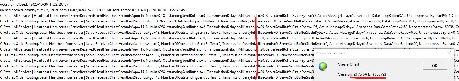

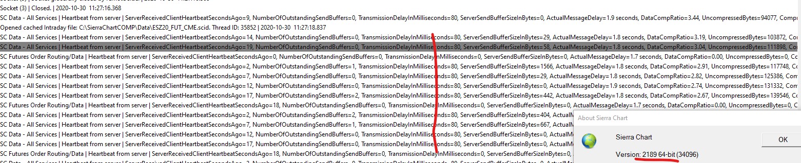

OK, so I upgraded to 2175, Use real-time data compression checked. Remote Buffer Delay in ms = 0 (default).
Unfortunately theres no difference to 2150. Chart is still laggy, overall experience is tragic, chart/DOM it updating as the chart update interval is ca. 100-150ms. And still when I replay the same period using standard replay all is running extremaly fast and smooth so the data is there. It just cant be that fast on live data.
My log from heartbeat below. Is there anything I should check/set on my side to finally get back to proper and perfect Denali operation as it was 1-2 months ago?
Is there any way to switch off that ms timestamping? Maybe that remote buffer dalay should be set to some other value?

[2020-10-30 10:39:34]
User311344 - Posts: 142
After update from 2175 to 2189 Ive started seeing laggy chart again! As I noticed in heartbeat information you probably set the minimal possible TransmissionDelayInMilliseconds from 20ms to 80ms!!! I get 80ms even though it's set to 20ms in SC server settings.
This is so wrong!!! Please revert back to at least those 20ms which were possible before and charts update speed was acceptable even though it should be at last 10ms same as minimal chart update interval.
Everything is going fine up to 2180, but in 2189 seems as you hardcoded 80ms as minimal. Attached are two logs from almost the same moment so theres no change in internet connection or pc/network configuration, etc.
I hope this is only some minor bug or temporary setting cause charts updating at 80ms are laggy as hell.
Date Time Of Last Edit: 2020-10-30 10:44:21

This issue is inadvertent. We are not sure of the cause yet. It will be resolved after the market close today. It does not appear to be an issue on the Sierra Chart side, but instead the server-side but we will find out.
Date Time Of Last Edit: 2020-10-30 18:00:50

[2020-10-30 20:21:40]
The problem has been identified and we will be doing an update on the server to resolve after the close today.
It relates to how real-time compression is enabled. Newer versions signal this through the encoding request message rather than by using a particular port.
Date Time Of Last Edit: 2020-10-30 20:22:33
