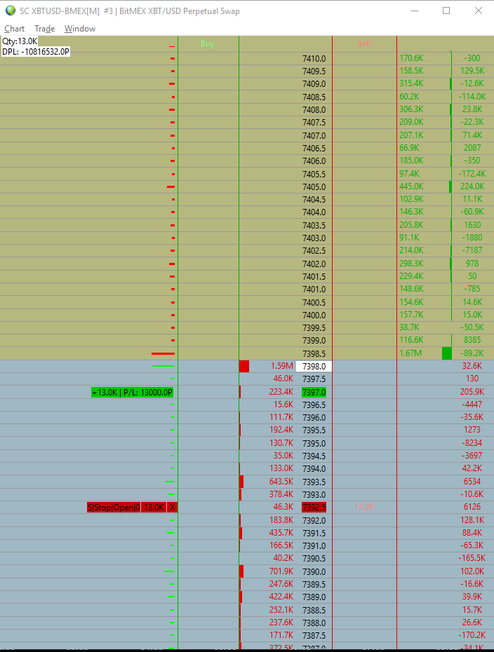

I have been trying to get the correct PNL to appear while I trade using the Trading DOM, but currently still is showing me incorrect PNL.
In pictures provided, I am long 13000 contracts, and my PNL shouldnt be nowhere near +$13000.
I attached an image of the settings I set, as I read many board posts to try to solve this. No luck on my end unfortunately.
imagejava.PNG / V - Attached On 2019-12-29 18:50:26 UTC - Size: 51.92 KB - 494 views
imagejava1.PNG / V - Attached On 2019-12-29 18:50:31 UTC - Size: 44.65 KB - 476 views

I would also like to ask since I'm here.. How can I save the layout I currently have for my trading DOM? If I try opening a new trading DOM, it is a blank and brand new trading dom with none of my settings/colors saved on the layout I have on the first Picture
imagejava.PNG / V - Attached On 2019-12-29 18:57:21 UTC - Size: 51.92 KB - 446 views

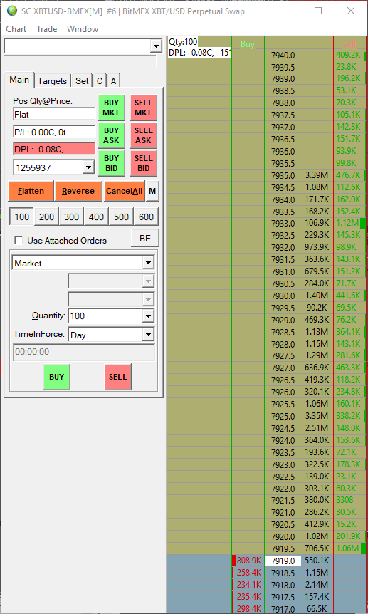

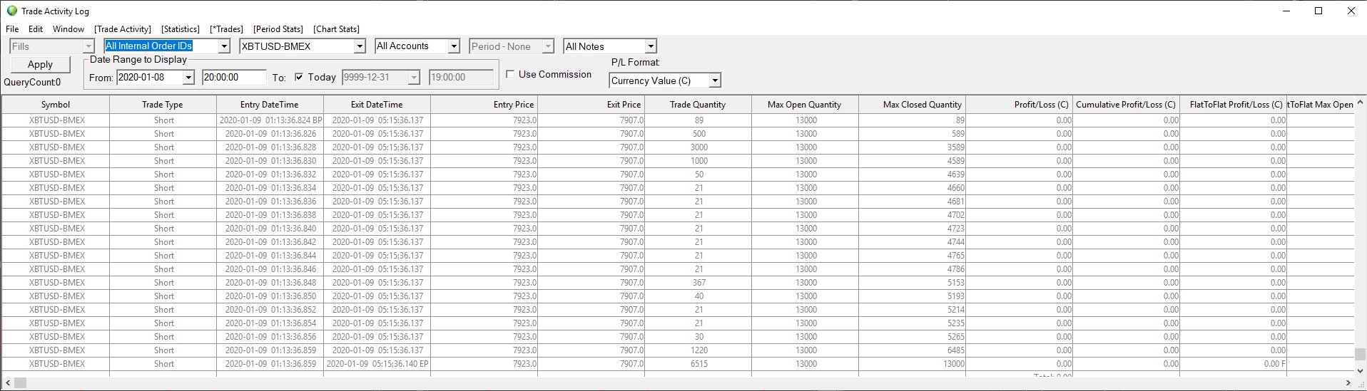

Hello, I have followed all steps for this, but for some reason I am stillnot getting the correct PNL.
In pictures provided, I display the position I took a short from 7923, covered at 7907(a winning short position) and for some reason my Daily PNL still comes out to negative(the negative calculation I received was also incorrect. It shouldnt be .08 BTC)
Please help
imageDOM.PNG / V - Attached On 2020-01-09 10:28:54 UTC - Size: 56.27 KB - 565 views
imagetrades.PNG / V - Attached On 2020-01-09 10:29:01 UTC - Size: 73.84 KB - 569 views

On my daily PNL on Bitmex.com, I won 0.0011 BTC(or ~$8)

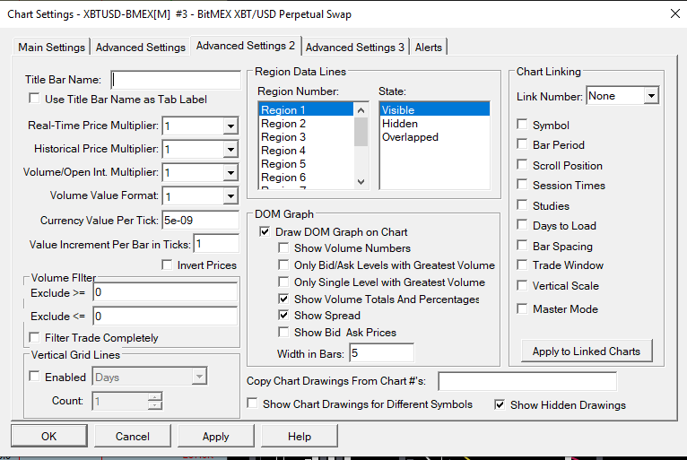

Do you know what the Currency Value Per Tick should be for XBTUSD on BitMex?
We will check with them on this.
Date Time Of Last Edit: 2020-01-12 23:42:51
[2020-01-14 03:59:14]
User227811 - Posts: 16
I believe you currently have it correct: 5e-09. I'm just not sure why its constantly giving me the wrong PNL. if it was the correct number, thatd be one thing. But for it to be giving me the wrong side (+ or -) and wrong number, its a pain to constantly have to check my bitmex page. Please assist me as I have been using SC for a long time now, and plan to. This would make my trading a lot better if I didnt have to spend ~1-2min checking up on my PNL on bitmex.

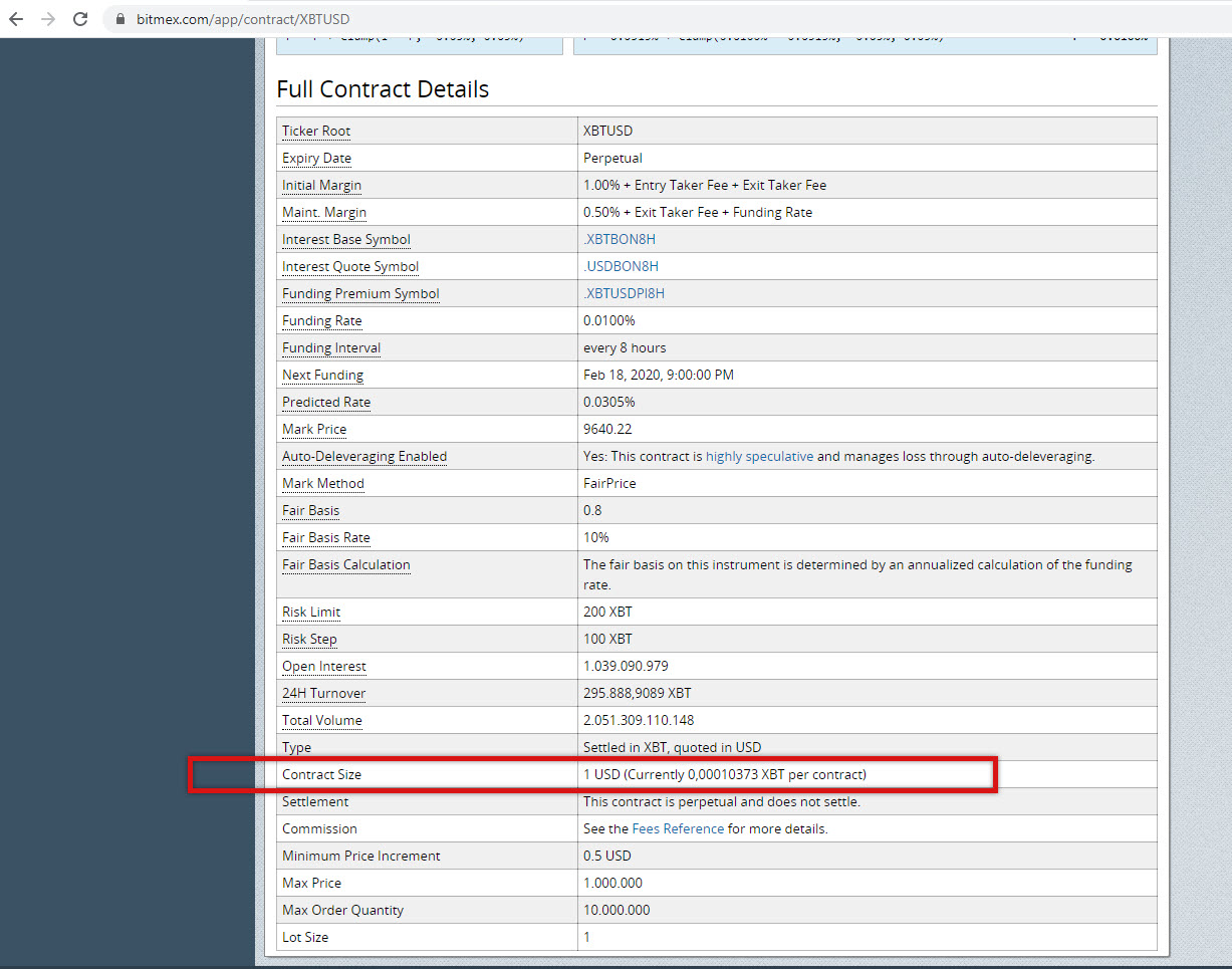

N!co - Posts: 140
The problem is that the tick value of the Bitmex XBT contract is no a fixed value
the orders size to open trades are in $ , but the profit/loss is in XBT
A 100.000$ order at a Bitcoin price of 10.000$ = 10 XBT
but a 100.000$ order at a bitcoin price of 5000$ = 20 XBT
therefor the tickvalue of XBT changes as the price goes up o down
the formula is = Contracts * (1/entryPrice - 1/exitPrice)
see screenshot for the current tick value
( that's per 1 USD, so you have to devide that value by 2 , since the minimum ticksize of the XBT contract =0.5)
one other minor problem to calculate the correct profit/loss
is that market orders (takers) suffer a 0.075% fee (on the $ contract value of the order)
while limit orders ( makers) get paid 0.025% rebate
imageBitMex_tickvalue.jpg / V - Attached On 2020-02-18 17:56:32 UTC - Size: 267.15 KB - 645 views
