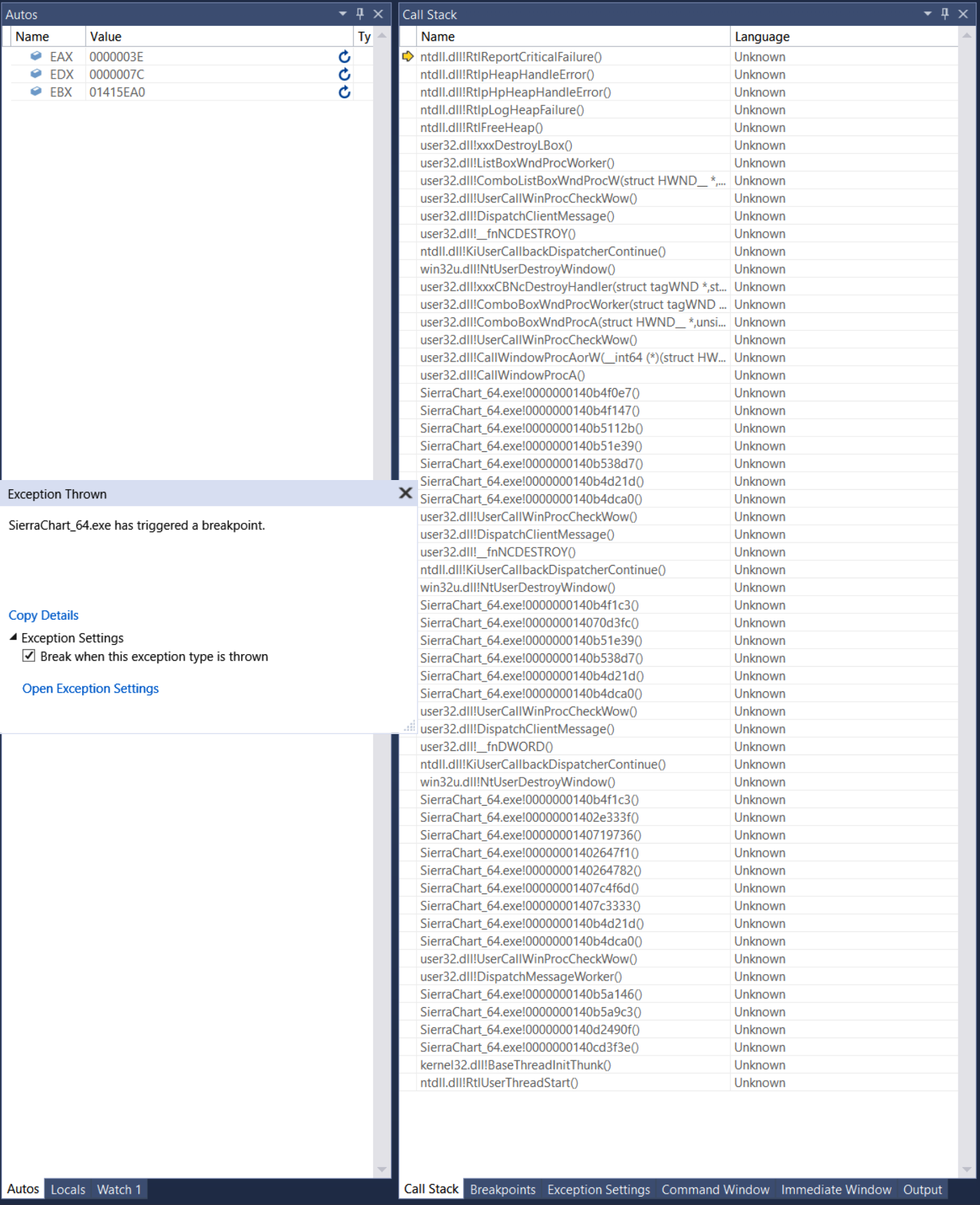

We (emojitrading) have been examining the chartbooks of this user and user tommartin321 in relation to this thread and the issue logged here:
Chartbook Crashing from Custom Studies: Caught an unhandled exception in c_Chart:WindowProc.
We have recompiled the relevant studies serving the chartbooks against v1997.
The issue in this thread seems to have disappeared as a result.
The chartbook in the other thread still causes problems. Debugging with Visual Studio attached to Sierra Chart implies that there is heap corruption occurring with Sierra Chart. We find this occurs consistently when the chartbook is closed. The VS debugger does not point to the custom study dll, but to the windows ntdll.dll (not that we are closed to the possibility of a bug within the custom study dll, however it has been working fine up until v1997).
The custom study uses persistent pointers to allocate and release dynamic memory as per the various ACSIL examples. At the last call to the function, the study checks for a non-null pointer, deletes the memory and clears the pointer as per the ACSIL examples.
Prior to recompiling against v1997 and using the VS debugger, Sierra Chart and Windows dlls (not the custom study dll) were causing errors on closing that seemed to relate to accessing an out of bounds index in an array of characters. There is nothing in the custom study that deals with arrays of characters and we are wondering whether this could relate in some way to the study ID numbering bug identified in v1996 perhaps when the study defaults (or chartbook parameters for studies) are being read/written? The pre-v1997 compiled version was compiled against v1928.
We've attached the output of the Visual Studio debugger. We would also be happy to supply Sierra Chart support with the custom study DLL if this helps investigate a potential bug within v1997. As I say, we are not closed to the idea that there is a bug within our code, however, the Visual Studio debugging process is not breaking at areas within the custom study's code.

We have undertaken further testing on this issue and attach another chartbook from an affected user. Our studies make use of dynamic memory allocation for vectors of structs and make use of sc.SetPersistentPointer. We have verified all of our code for memory allocation and deallocation which occurs in line with Sierra Chart's examples. We have also verified that no out of bounds vector indexes are being referenced.
What has been consistent in all cases has been heap corruption and two of the three affected chartbooks make use of a large number of charts including several with short timeframes (1 minute), a large number of days loaded relative to the chart timeframe (60 days) and multiple custom indicators with relatively loose parameters. Several charts include Numbers Bars. Charts also include thin instruments with missing price levels.
During the latest testing we have noticed this error from the standard Numbers Bars study on one of the affected chartbooks (screen dump attached):
Chart: NQZ9-CME [C] 1 Min #10 | Study: Numbers Bars | Exception occurred while calling study function. | 2019-10-12 11:06:30.809 *

This occurs because there has been a memory corruption which affected that study:
It is not the study itself which has a problem. It is something else related to your custom study.

It is 100% clear, there is a problem in your code. It is occurring in this function:
ETOFSv3_64.scsf_Emoji_License_Manager
The debugger is reporting this:
Exception thrown at 0x000007FEFD65B87D in SierraChart_64.exe: Microsoft C++ exception: std::ios_base::failure at memory location 0x000000000009A920.
But we are suspicious of whether that is really the accurate exception.
This is the call stack:
>  KernelBase.dll!RaiseException() + 61 bytes  Unknown
  ETOFSv3_64.dll!000007fedb54b14d()  Unknown
  ETOFSv3_64.dll!000007fedb4da556()  Unknown
  ETOFSv3_64.dll!000007fedb4e3c05()  Unknown
  ETOFSv3_64.dll!000007fedb4ec49a()  Unknown
  ETOFSv3_64.dll!000007fedb4ec859()  Unknown
  ETOFSv3_64.dll!000007fedb4d8fa3()  Unknown
  ETOFSv3_64.dll!scsf_Emoji_License_Manager() + 1140 bytes  Unknown

We tested your complextest Chartbook, with extensive checking of memory for corruptions, and no problems were found. We opened the Chartbook, left it open for hours and then closed it. Under the debugger this whole process took many hours. And no corruptions or exceptions other than the exceptions already mentioned.
Perhaps the issue was related to invalid DisplayOrder indexes. This probably makes sense especially being there was a recent change with working with that variable. And under our testing described above, the safety checks relating to the use of that variable were already implemented. Even without the safety check though, there should never have been any type of heap correction. At worst you would have had a garbled display of inputs on the chart or an access violation.
Date Time Of Last Edit: 2019-10-20 07:34:17
[2019-10-20 11:39:35]
binaryduke - Posts: 387
Thank you for looking at this. We did experience one test where an input was garbled and appeared in oriental characters. We now have 2-3 areas to focus on for optimisation so thank you again for taking the time on this.
