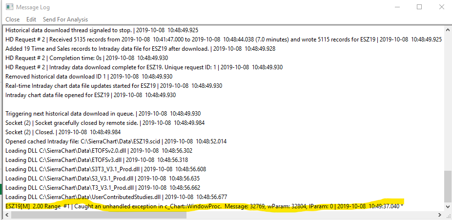

After updating to the current version 1997, my chartbook is constantly crashing. Error message and Chartbook files have been uploaded.

We are continuing to test your Chartbook on a release build and completely stable. No there is nothing more that we need other than the Chartbook. Actually, we can now see what the problem is. You are running custom studies now that we look at your screenshot again.

Yes, that's correct. My Sierra Charts only crashes when I add the Custom Studies.

There is indeed a problem with the custom studies you are using. Refer to:
Custom Studies has issue on windows 10
The developer will take care of this.
