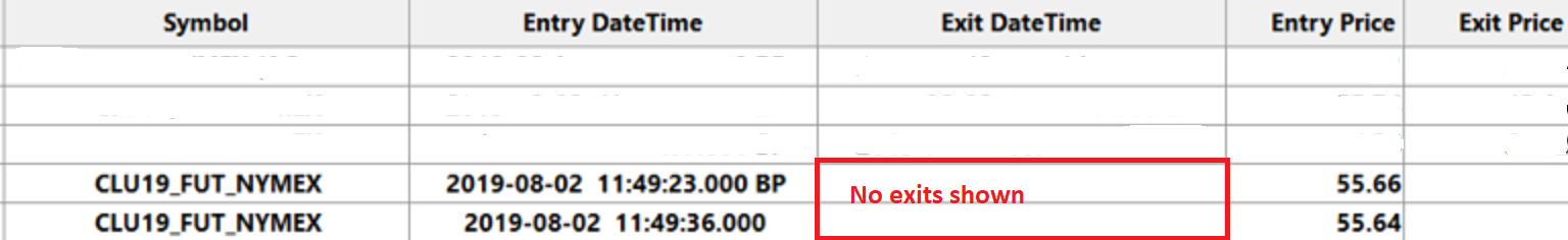

[2019-08-03 23:22:08]
4trading - Posts: 22
Here is another problem trade. I was up a good amount and attempted to exit multiple times with several different SC installs on 2 separate PCs. It seemed like I was trapped in the trade.
This has happened about 5 times or so the past month.
I whited out other trades, but SC shows that I never exited the two CL entries.
Fortunately my statement shows I made a profit on this trade, although it was only less than 1/2 of when I attempted to exit.
Edit: Wow! That is weird. Now the exits are showing up in SC.
Date Time Of Last Edit: 2019-08-03 23:50:11

[2019-08-04 00:45:59]
In regards to post #21, this is not completely clear. We need precise details.
Is this referring to 2019-08-02 where there was a problem with the order status reporting and orders disappearing? (Which were actually still working and the position quantity was still updating properly)
Are you referring to subsequent fill reporting within the Trade Activity Log or some incident during order entry? We would highly doubt there would've been any problem during order entry. We have never had any reports of an issue other than on 2019-08-02.
The problem on Friday is well understood and we are preparing detailed information for users and also point out to TT the particular issue which needs to get resolved on their side which triggered the problem and greatly exacerbated it, and going to issue additional usage time to the affected users.
There were missing fills, with the TT order routing on 2019-08-02 during the issue which occurred for about 2-3 hours. We are going at those added over this weekend assuming no technical complications.
Date Time Of Last Edit: 2019-08-04 07:39:47
[2019-08-04 14:31:09]
I am pretty new with SC-TT (1+ month), but mostly it has been exceptional for executions, compared to other platforms I have used.
It is possibly a separate problem, but I did not document which days it happened, or which versions of SC.
None of the incidents were as bad as Friday however.
So let's put it on hold until next time it happens. I will make sure to document it and send in the log for that day.
I appreciate your diligent work. Thanks.
