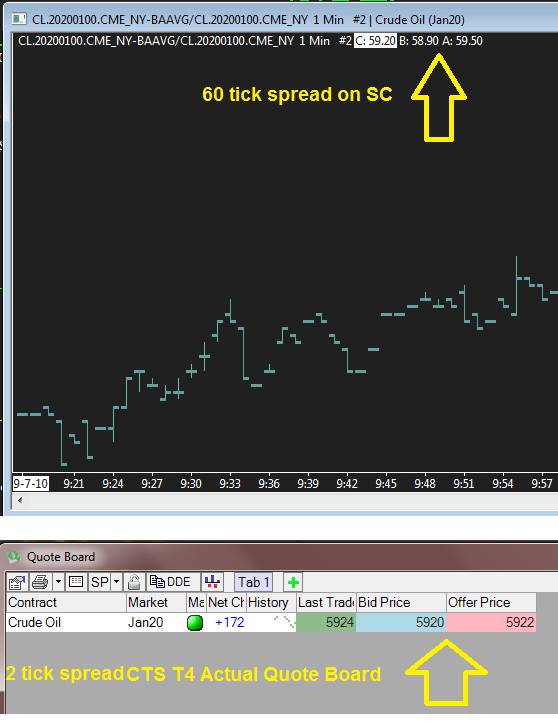

[2019-07-10 16:29:23]
User851475 - Posts: 3
Attached is a screenshot taken directly from the CTS T4 quote board which shows a spread of 2 ticks as opposed to 60 ticks inside SC. Both CTS and Interactive Brokers are showing 2 ticks. And obviously a spread for a contract even 6 months out is never 76. While you may not support external feeds, I'm sure you do support that they work correctly inside of SC. Your help is greatly appreciated.

[2019-07-10 17:50:35]
We think the difference has to do with implied market depth being included by Interactive Brokers and CTS.
This has come up before. We can do that with the Sierra Chart data feeds as well. I do not see how we can solve this though with the CTS FIX data feed.
Without implied depth this is what we are currently seeing from the CME:
Current Quote CLF20
2019-07-10 13:42:11.000 Wed
LastPrice: 59.64
LastSize: 1
Daily Price Chg: 2.12
Ask: 59.98
Bid: 59.26
Bid Ask Avg: 59.62
Bid Ask Diff: 72.0 Ticks
Bid x Ask: 2 x 2
Daily Open: 58.09
Daily High: 59.68
Daily Low: 58.09
Previous Close: 57.52
Daily Volume: 13676
Num Trades: 1517
Open Interest: 89567
Date Time Of Last Edit: 2019-07-10 17:51:08

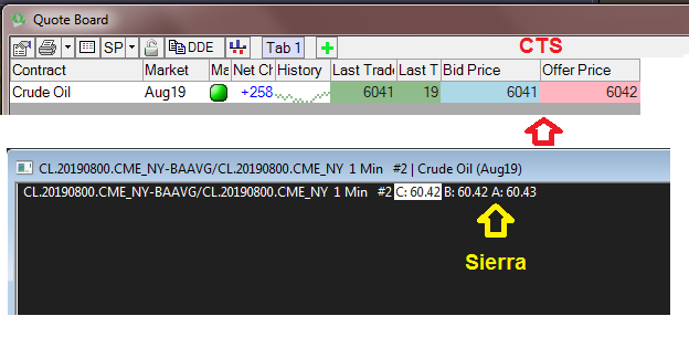

[2019-07-10 18:41:54]
Not sure what implied market depth is. Regardless of the contract month, the top of the book best bid/ask should be showing. Without it, that means I can't chart or trade any months other than the current contract month. I just compared the current August Contract of SC and CTS and it works correctly (See attachment).
imageAugust Current CL Contract SC vs CTS.png / V - Attached On 2019-07-10 18:36:26 UTC - Size: 27.52 KB - 512 views
[2019-07-11 09:29:03]
Refer to:
https://www.cmegroup.com/confluence/display/EPICSANDBOX/MDP+3.0+-+Consolidating+Implied+and+Multiple+Depth+Books
We will support this in our own data feed.
