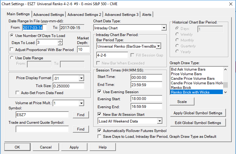

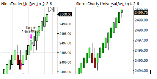

Attached is a snippet comparing the NinjaTrader 2-2-6 vs the Sierra Charts 4-2-6 Universal Renko bar chart bars. In particular, note the last bar. On NinjaTrader, a new bar is filled from the offset position immediately when the bar forms. On Sierra Charts, the bar doesn’t fill from the offset until the bar closes. The offset position is the middle of the previous bar for these settings.
Also attached is a snip of my Sierra Charts chart settings.
1. Is there a way to configure the Sierra Charts 4-2-6 Universal Renko bar chart to immediately fill from the offset position when the bar forms?

1. No this is not supported.
2. Not now. The code is not available and would not be useful in the way that it exists.
3. This capability does not exist but will be available in 45 to 60 days.

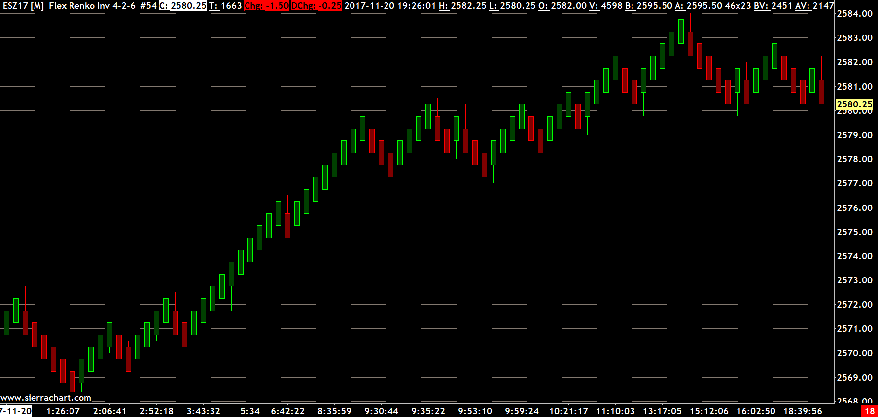

On the desired chart, the topping green bar body high at the top of the run would never be greater than the wick or body of a following red bar because in order for the next bar to form following the green topping bar, a price 1 tick higher than the body high of the green topping bar would have to occur, and this price would show up as a wick that is higher than the green topping bar body on a following red bar (as shown on the desired chart).
We do not agree with the statement because the price action could cause this condition, but this is not relevant because you are comparing to 1614 which we no longer support and there may very well have been a problem.
However, as you can see in the current implementation which is a much more thorough and complete implementation which was one of the objectives of the recent work on Renko bars, you do not see what you are describing:
http://www.sierrachart.com/image.php?Image=1511304411475.png

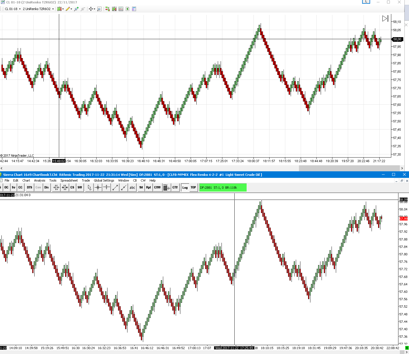

Try FlexRenko 4-2-2, third setting (new bar exceeed, reversal met + 1 tick)

The 4-2-2 Flex Renko with the 3rd New Trend Bar setting matches very well - after I adjusted my Start Time. I originally saw a glitch where one of the bar bodies was only 3 ticks instead of 4. I looked into this and discovered the glitch tracked the Start Time. I had assumed that selecting "Use Evening Session" and setting the Evening Start and Evening End Times overrode the other Start and End Times in the Session Time section, but it doesn't. This may have been one of my issues all along. Anyway, it looks like the 4-2-2 setting is working. I'll monitor it for a few days and see how it goes.
