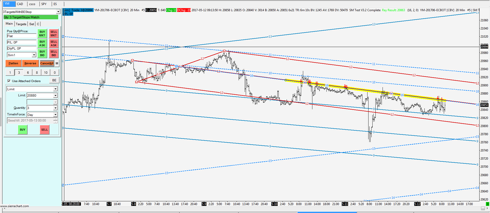

The Chartbook file, Spreadsheet file and the Custom Study CPP file have been uploaded. Also uploaded is a screenshot of the active chart: http://www.sierrachart.com/image.php?Image=1494602034934.png
The timer error occurs after 3-5 hours of use, either in live or in replay mode with "Auto Trading Enabled" in the SC menu.

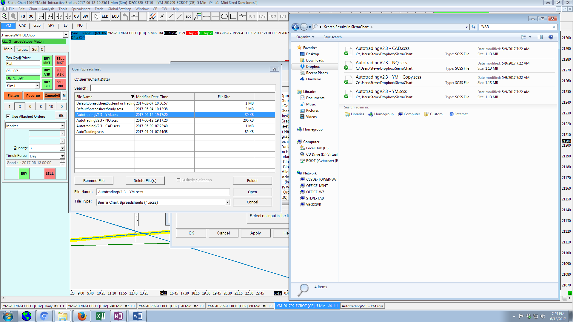

The Timer Event error occurred on my system again today. This time SC crashed completely and when I reopened it my studies had again been wiped out. I was unable record a video file due to the hard crash, but I've attached a screen capture of the size of the affected studies after the crash. The files that were opened when the program crashed were:
AutotradingV2.3 - YM.scss
AutotradingV2.3 - NQ.scss
Prior to the crash these files were the same size as the backups shown in right side of the the screen capture ~1.1MB. After the crash the file sizes were 39KB and 206KB.
