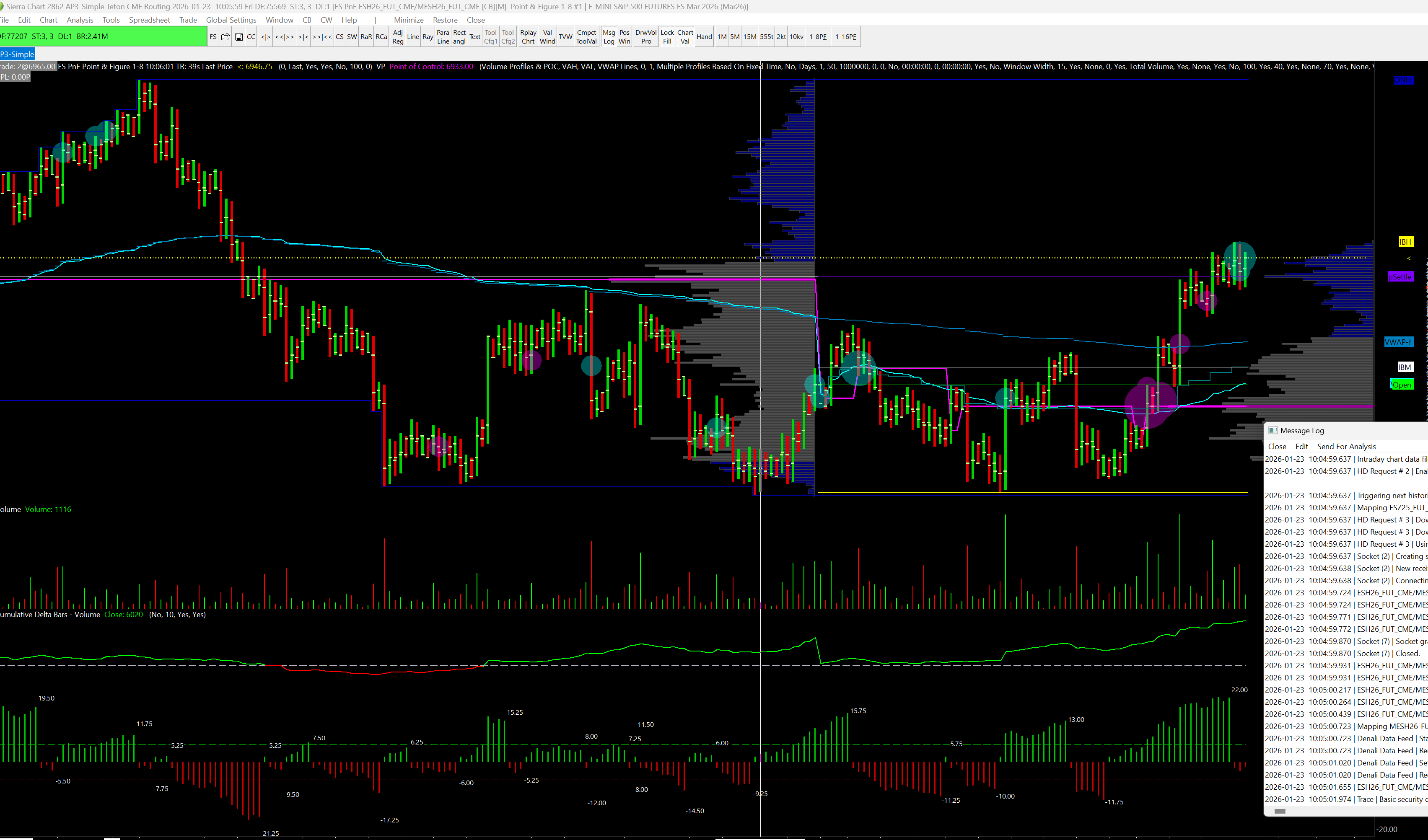

I'm using Denali and Teton, I have Service Pack 11, and am subscribed to Denali Exchange Data Feed >> CME/CBOT/NMEX/COMEX Exchange.
I have been experiencing seemingly random instances wherein my platform stops receiving any new data. THe little clock at the top of the chart where the studies info is gets stuck (I assume this means no more data is coming in) while the system clock in the window border keeps running.
This is very concerning because if I have a trade open, or I don't immediately notice that data isn't flowing, I will be trading on something static. The green connection box is still lit up too!
This doesn't seem to resolve when I hit reconnect or disconnect then reconnect. Usually closing SC and reopening resolves issue, however there are instances wherein I have to close and reopen more than once.

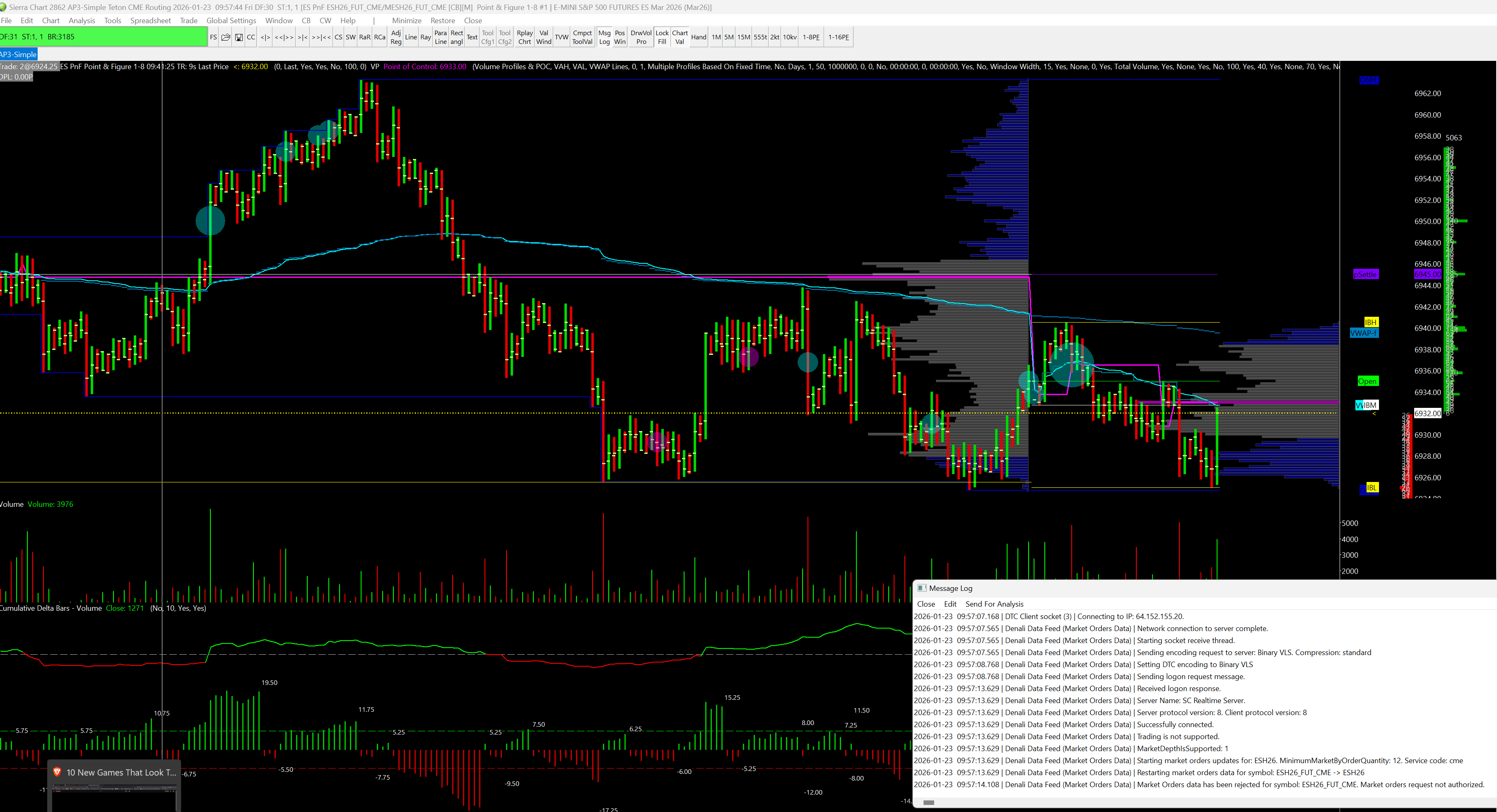

In my first image it shows that I my last 'piece' of data was 09:41:25, whereas the window clock shows it is already 09:57:44.
The second image is after I restarted SC. You can see the massive difference in the chart (window time is 10:05:59)
imageImg1 No new dat.png / V - Attached On 2026-01-23 15:15:40 UTC - Size: 355.03 KB - 158 views
imageImg2 After restart.png / V - Attached On 2026-01-23 15:15:46 UTC - Size: 317 KB - 157 views

2026-01-27 09:19:24.556 | DTC Client socket (3) | Creating socket.
2026-01-27 09:19:24.556 | DTC Client socket (3) | New receive buffer size: 0
2026-01-27 09:19:24.556 | DTC Client socket (3) | Connecting to IP: 216.200.108.154.
2026-01-27 09:19:24.846 | Denali Data Feed | Network connection to server complete.
2026-01-27 09:19:24.846 | Denali Data Feed | Starting socket receive thread.
2026-01-27 09:19:24.846 | Denali Data Feed | Sending encoding request to server: Binary VLS. Compression: standard
2026-01-27 09:19:25.139 | HD Request # 1 | Timestamp of first Intraday data file record written: 2026-01-26 09:51:30.457000.
2026-01-27 09:19:25.145 | Denali Data Feed | Setting DTC encoding to Binary VLS
2026-01-27 09:19:25.145 | Denali Data Feed | Sending logon request message.
2026-01-27 09:19:26.539 | Trace | Basic security definition symbol settings fields ignored in primary service client. Symbol: ESH26_FUT_CME
2026-01-27 09:19:26.539 | Teton CME Routing | Setting external service identifier for symbol ESH26_FUT_CME to 42140878
2026-01-27 09:19:26.539 | Teton CME Routing | Received security definition for symbol ESH26_FUT_CME
2026-01-27 09:19:27.267 | Denali Data Feed | Received logon response.
2026-01-27 09:19:27.267 | Denali Data Feed | Server Name: SC Realtime Server.
2026-01-27 09:19:27.267 | Denali Data Feed | Server protocol version: 8. Client protocol version: 8
2026-01-27 09:19:27.267 | Denali Data Feed | Successfully connected.
2026-01-27 09:19:27.267 | Denali Data Feed | Trading is not supported.
2026-01-27 09:19:27.267 | Denali Data Feed | MarketDepthIsSupported: 1
2026-01-27 09:19:27.267 | Denali Data Feed | Restarting real-time data updates for symbol: ESH26_FUT_CME -> ESH26
2026-01-27 09:19:28.146 | Requesting market depth updates for: ESH26_FUT_CME if supported. NumLevels=100
2026-01-27 09:19:28.146 | Denali Data Feed (Market Orders Data) | Connecting to the server ds27.sierracharts.com. Port 10060
2026-01-27 09:19:28.151 | DTC Client socket (4) | Creating socket.
2026-01-27 09:19:28.151 | DTC Client socket (4) | New receive buffer size: 0
2026-01-27 09:19:28.151 | DTC Client socket (4) | Connecting to IP: 216.200.108.154.
2026-01-27 09:19:28.440 | Denali Data Feed (Market Orders Data) | Network connection to server complete.
2026-01-27 09:19:28.440 | Denali Data Feed (Market Orders Data) | Starting socket receive thread.
2026-01-27 09:19:28.440 | Denali Data Feed (Market Orders Data) | Sending encoding request to server: Binary VLS. Compression: standard
2026-01-27 09:19:28.710 | Denali Data Feed (Market Orders Data) | Setting DTC encoding to Binary VLS
2026-01-27 09:19:28.710 | Denali Data Feed (Market Orders Data) | Sending logon request message.
2026-01-27 09:19:28.895 | Denali Data Feed | Setting external service identifier for symbol ESH26_FUT_CME to 42140878
2026-01-27 09:19:28.895 | Denali Data Feed | Received security definition for symbol ESH26_FUT_CME
2026-01-27 09:19:29.093 | Denali Data Feed (Market Orders Data) | Received logon response.
2026-01-27 09:19:29.093 | Denali Data Feed (Market Orders Data) | Server Name: SC Realtime Server.
2026-01-27 09:19:29.093 | Denali Data Feed (Market Orders Data) | Server protocol version: 8. Client protocol version: 8
2026-01-27 09:19:29.093 | Denali Data Feed (Market Orders Data) | Successfully connected.
2026-01-27 09:19:29.093 | Denali Data Feed (Market Orders Data) | Trading is not supported.
2026-01-27 09:19:29.093 | Denali Data Feed (Market Orders Data) | MarketDepthIsSupported: 1
2026-01-27 09:19:29.093 | Denali Data Feed (Market Orders Data) | Starting market orders updates for: ESH26. MinimumMarketByOrderQuantity: 12. Service code: cme
2026-01-27 09:19:29.093 | Denali Data Feed (Market Orders Data) | Restarting market orders data for symbol: ESH26_FUT_CME -> ESH26
2026-01-27 09:19:29.470 | Denali Data Feed (Market Orders Data) | Market Orders data has been rejected for symbol: ESH26_FUT_CME. Market orders request not authorized.
2026-01-27 09:19:30.478 | Denali Data Feed | Clearing market depth for ESH26_FUT_CME
2026-01-27 09:20:23.369 | Socket (2) | CloseSocket call.
2026-01-27 09:20:23.369 | Socket (2) | Shutdown started. Waiting for graceful close.
2026-01-27 09:20:23.369 | Historical data download thread signaled to stop.
2026-01-27 09:20:23.370 | HD Request # 1 | Received 598308 Intraday data records from 2026-01-26 09:51:29.055000 to 2026-01-27 09:20:20.926000 (23.5 hours. Delay: 2.4 seconds) and wrote 598282 records for ESH26_FUT_CME
2026-01-27 09:20:23.378 | HD Request # 1 | Add time&sales data | Remembered last file record date-time: 2026-01-27 14:20:20.926000
2026-01-27 09:20:23.378 | HD Request # 1 | Completion time: 1m 3s.
2026-01-27 09:20:23.378 | HD Request # 1 | Intraday data download complete for ESH26_FUT_CME. Unique request ID: 1
2026-01-27 09:20:23.378 | Removing historical data download ID 1.
2026-01-27 09:20:23.378 | Real-time Intraday chart data file updates started for ESH26_FUT_CME
2026-01-27 09:20:23.378 | Intraday chart data file opened for ESH26_FUT_CME
2026-01-27 09:20:23.378 | HD Request # 1 | Enabling Intraday chart updating for symbol.
2026-01-27 09:20:23.378 | No download requests in the queue to start downloads for.
2026-01-27 09:20:23.378 | Initiating new historical data download for ESH26_FUT_CME to get the latest data since the download was started while not connected to primary service.
2026-01-27 09:20:23.378 | Added historical Intraday data request for ESH26_FUT_CME to the queue.
2026-01-27 09:20:23.378 | Intraday data recording state for symbol ESH26_FUT_CME is set to download 'Pending'.
2026-01-27 09:20:23.378 | Triggering next historical data download in queue.
2026-01-27 09:20:23.378 | HD Request # 3 | Downloading Intraday chart data for ESH26_FUT_CME to the file ESH26_FUT_CME.scid. Service: cme
2026-01-27 09:20:23.378 | HD Request # 3 | Download start date-time: 2026-01-27 09:20:20.000000. File last date-time: 2026-01-27 09:20:20.926000
2026-01-27 09:20:23.378 | HD Request # 3 | Using server: ds32.sierracharts.com port 10149
2026-01-27 09:20:23.419 | Socket (5) | Creating socket.
2026-01-27 09:20:23.419 | Socket (5) | New receive buffer size: 0
2026-01-27 09:20:23.419 | Socket (5) | Connecting to IP: 69.39.70.248.
2026-01-27 09:20:23.663 | Socket (2) | Socket gracefully closed by remote side.
2026-01-27 09:20:23.663 | Socket (2) | Closed.
2026-01-27 09:20:23.729 | ESH26_FUT_CME/MESH26_FUT_CME [CB] Point & Figure 1-16 #1 | Download is complete for all contract months in chart. Proceeding with data load.
2026-01-27 09:20:23.730 | ESH26_FUT_CME/MESH26_FUT_CME [CB] Point & Figure 1-16 #1 | Reloading chart.
2026-01-27 09:20:23.733 | ESH26_FUT_CME [CB] #2 | Download is complete for all contract months in chart. Proceeding with data load.
2026-01-27 09:20:23.743 | ESH26_FUT_CME [CB] #2 | Reloading chart.
2026-01-27 09:20:23.761 | ESH26_FUT_CME [CB] 30 Min #5 | Download is complete for all contract months in chart. Proceeding with data load.
2026-01-27 09:20:23.761 | ESH26_FUT_CME [CB] 30 Min #5 | Reloading chart.
2026-01-27 09:20:23.780 | ESH26_FUT_CME/MESH26_FUT_CME [CB] Point & Figure 1-16 #4 | Download is complete for all contract months in chart. Proceeding with data load.
2026-01-27 09:20:23.780 | ESH26_FUT_CME/MESH26_FUT_CME [CB] Point & Figure 1-16 #4 | Reloading chart.
2026-01-27 09:20:23.783 | ESH26_FUT_CME/MESH26_FUT_CME [CB] 30 Min #6 | Download is complete for all contract months in chart. Proceeding with data load.
2026-01-27 09:20:23.783 | ESH26_FUT_CME/MESH26_FUT_CME [CB] 30 Min #6 | Reloading chart.
2026-01-27 09:20:23.975 | HD Request # 3 | Setting DTC encoding to Binary VLS
2026-01-27 09:20:23.975 | HD Request # 3 | Sending historical data logon request message.
2026-01-27 09:20:24.258 | ESH26_FUT_CME [CB] #2 | Reloading chart.
2026-01-27 09:20:24.281 | HD Request # 3 | Requesting Intraday data. Start date-time: 2026-01-27 09:20:20. Record interval: 0. Symbol: ESH26
2026-01-27 09:20:24.294 | ESH26_FUT_CME [CB] #2 | Waiting for historical downloads to complete with the IDs: 3,
2026-01-27 09:20:24.295 | ESH26_FUT_CME/MESH26_FUT_CME [CB] Point & Figure 1-16 #1 | Reloading chart.
2026-01-27 09:20:24.300 | ESH26_FUT_CME/MESH26_FUT_CME [CB] Point & Figure 1-16 #1 | Waiting for historical downloads to complete with the IDs: 3,
2026-01-27 09:20:24.303 | ESH26_FUT_CME/MESH26_FUT_CME [CB] 30 Min #6 | Reloading chart.
2026-01-27 09:20:24.309 | ESH26_FUT_CME/MESH26_FUT_CME [CB] 30 Min #6 | Waiting for historical downloads to complete with the IDs: 3,
2026-01-27 09:20:24.311 | ESH26_FUT_CME/MESH26_FUT_CME [CB] Point & Figure 1-16 #4 | Reloading chart.
2026-01-27 09:20:24.316 | ESH26_FUT_CME/MESH26_FUT_CME [CB] Point & Figure 1-16 #4 | Waiting for historical downloads to complete with the IDs: 3,
2026-01-27 09:20:24.326 | ESH26_FUT_CME [CB] 30 Min #5 | Reloading chart.
2026-01-27 09:20:24.348 | ESH26_FUT_CME [CB] 30 Min #5 | Waiting for historical downloads to complete with the IDs: 3,
2026-01-27 09:20:24.558 | HD Request # 3 | Decompressing data.
2026-01-27 09:20:24.835 | HD Request # 3 | Receiving Intraday data for ESH26_FUT_CME starting at 2026-01-27 09:20:20.231000
2026-01-27 09:20:24.835 | Socket (5) | CloseSocket call.
2026-01-27 09:20:24.835 | Socket (5) | Shutdown started. Waiting for graceful close.
2026-01-27 09:20:24.836 | Historical data download thread signaled to stop.
2026-01-27 09:20:24.836 | HD Request # 3 | Received 2 Intraday data records from 2026-01-27 09:20:20.231000 to 2026-01-27 09:20:20.926000 (0.7 seconds. Delay: 3.9 seconds) and wrote 0 records for ESH26_FUT_CME
2026-01-27 09:20:24.841 | HD Request # 3 | Add time&sales data | Remembered last file record date-time: 2026-01-27 14:20:20.926000
2026-01-27 09:20:24.841 | HD Request # 3 | Completion time: 1s.
2026-01-27 09:20:24.841 | HD Request # 3 | Intraday data download complete for ESH26_FUT_CME. Unique request ID: 3
2026-01-27 09:20:24.841 | Removing historical data download ID 3.
2026-01-27 09:20:24.841 | Real-time Intraday chart data file updates started for ESH26_FUT_CME
2026-01-27 09:20:24.841 | Intraday chart data file opened for ESH26_FUT_CME
2026-01-27 09:20:24.841 | HD Request # 3 | Enabling Intraday chart updating for symbol.
2026-01-27 09:20:24.841 | No download requests in the queue to start downloads for.
2026-01-27 09:20:24.847 | ESH26_FUT_CME [CB] 30 Min #5 | Download is complete for all contract months in chart. Proceeding with data load.
2026-01-27 09:20:24.847 | ESH26_FUT_CME [CB] 30 Min #5 | Reloading chart.
2026-01-27 09:20:24.866 | ESH26_FUT_CME/MESH26_FUT_CME [CB] Point & Figure 1-16 #4 | Download is complete for all contract months in chart. Proceeding with data load.
2026-01-27 09:20:24.867 | ESH26_FUT_CME/MESH26_FUT_CME [CB] Point & Figure 1-16 #4 | Reloading chart.
2026-01-27 09:20:25.114 | Socket (5) | Socket gracefully closed by remote side.
2026-01-27 09:20:25.114 | Socket (5) | Closed.
2026-01-27 09:20:25.268 | ESH26_FUT_CME [CB] #2 | Download is complete for all contract months in chart. Proceeding with data load.
2026-01-27 09:20:25.268 | ESH26_FUT_CME [CB] #2 | Reloading chart.
2026-01-27 09:20:25.299 | ESH26_FUT_CME/MESH26_FUT_CME [CB] 30 Min #6 | Download is complete for all contract months in chart. Proceeding with data load.
2026-01-27 09:20:25.304 | ESH26_FUT_CME/MESH26_FUT_CME [CB] 30 Min #6 | Reloading chart.
2026-01-27 09:20:25.304 | ESH26_FUT_CME/MESH26_FUT_CME [CB] Point & Figure 1-16 #1 | Download is complete for all contract months in chart. Proceeding with data load.
2026-01-27 09:20:25.305 | ESH26_FUT_CME/MESH26_FUT_CME [CB] Point & Figure 1-16 #1 | Reloading chart.
2026-01-27 09:20:25.347 | ESH26_FUT_CME [CB] 30 Min #5 | Reloading chart.
2026-01-27 09:20:25.400 | ESH26_FUT_CME/MESH26_FUT_CME [CB] Point & Figure 1-16 #4 | Reloading chart.
2026-01-27 09:20:25.775 | ESH26_FUT_CME [CB] #2 | Reloading chart.
2026-01-27 09:20:25.842 | ESH26_FUT_CME/MESH26_FUT_CME [CB] Point & Figure 1-16 #1 | Reloading chart.
2026-01-27 09:20:25.857 | ESH26_FUT_CME/MESH26_FUT_CME [CB] 30 Min #6 | Reloading chart.
2026-01-27 09:20:25.901 | Mapping MESH26_FUT_CME to MESH26. Service code: cme
2026-01-27 09:20:25.901 | Denali Data Feed | Starting real-time market data updates for: MESH26_FUT_CME (MESH26). ID: 2 Service code: cme
2026-01-27 09:20:25.901 | Denali Data Feed | Requesting security definition data for: MESH26_FUT_CME (MESH26). ID: 2
2026-01-27 09:20:26.050 | ESH26_FUT_CME/MESH26_FUT_CME [CB] 30 Min #6 | Chart data loading complete.
2026-01-27 09:20:26.185 | Trace | Basic security definition symbol settings fields ignored in primary service client. Symbol: MESH26_FUT_CME
2026-01-27 09:20:26.185 | Teton CME Routing | Setting external service identifier for symbol MESH26_FUT_CME to 42003800
2026-01-27 09:20:26.185 | Teton CME Routing | Received security definition for symbol MESH26_FUT_CME
2026-01-27 09:20:26.363 | ESH26_FUT_CME/MESH26_FUT_CME [CB] 30 Min #6 | Reloading chart.
2026-01-27 09:20:26.468 | ESH26_FUT_CME/MESH26_FUT_CME [CB][M] Point & Figure 1-16 #1 | StartDateTimeForLoadingOrderFills: 2025-01-20 00:00:00
2026-01-27 09:20:26.624 | ESH26_FUT_CME/MESH26_FUT_CME [CB][M] Point & Figure 1-16 #1 | Chart data loading complete.
2026-01-27 09:20:26.773 | ESH26_FUT_CME/MESH26_FUT_CME [CB][M] Point & Figure 1-16 #4 | StartDateTimeForLoadingOrderFills: 2025-01-20 00:00:00
2026-01-27 09:20:26.807 | ESH26_FUT_CME/MESH26_FUT_CME [CB][M] Point & Figure 1-16 #4 | Chart data loading complete.
2026-01-27 09:20:26.836 | Denali Data Feed | Setting external service identifier for symbol MESH26_FUT_CME to 42003800
2026-01-27 09:20:26.836 | Denali Data Feed | Received security definition for symbol MESH26_FUT_CME
2026-01-27 09:20:26.842 | ESH26_FUT_CME/MESH26_FUT_CME [CB][M] Point & Figure 1-16 #1 | Reloading chart.
2026-01-27 09:20:26.906 | ESH26_FUT_CME/MESH26_FUT_CME [CB][M] Point & Figure 1-16 #4 | Reloading chart.
2026-01-27 09:20:28.360 | ESH26_FUT_CME/MESH26_FUT_CME [CB][M] 30 Min #6 | Chart data loading complete.
2026-01-27 09:20:29.317 | ESH26_FUT_CME/MESH26_FUT_CME [CB][M] Point & Figure 1-16 #1 | StartDateTimeForLoadingOrderFills: 2025-01-20 00:00:00
2026-01-27 09:20:29.392 | ESH26_FUT_CME/MESH26_FUT_CME [CB][M] Point & Figure 1-16 #1 | Chart data loading complete.
2026-01-27 09:20:29.470 | ESH26_FUT_CME/MESH26_FUT_CME [CB][M] Point & Figure 1-16 #4 | StartDateTimeForLoadingOrderFills: 2025-01-20 00:00:00
2026-01-27 09:20:29.495 | ESH26_FUT_CME/MESH26_FUT_CME [CB][M] Point & Figure 1-16 #4 | Chart data loading complete.
2026-01-27 09:20:29.977 | Opened cached Intraday file: C:\SierraChart\Data\ESH26_FUT_CME.scid. Thread ID: 18240
2026-01-27 09:20:36.494 | ESH26_FUT_CME [CB][M] 30 Min #5 | Chart data loading complete.
2026-01-27 09:20:36.528 | ESH26_FUT_CME [CB][M] #2 | Chart data loading complete.
2026-01-27 09:22:44.555 | Denali Data Feed | There has been no activity on the network socket for 45s. Will reconnect.
2026-01-27 09:22:44.555 | Denali Data Feed (Market Orders Data) | Waiting for socket receive thread to end
2026-01-27 09:22:44.555 | DTC Client socket (4) | CloseSocket call.
2026-01-27 09:22:44.555 | DTC Client socket (4) | Shutdown started. Waiting for graceful close.
2026-01-27 09:22:44.555 | Denali Data Feed (Market Orders Data) | Disconnected from the server.
2026-01-27 09:22:44.556 | Denali Data Feed | Waiting for socket receive thread to end
2026-01-27 09:22:44.556 | DTC Client socket (3) | CloseSocket call.
2026-01-27 09:22:44.556 | Denali Data Feed | Disconnected from the server.
2026-01-27 09:22:44.556 | Denali Data Feed | Data feed disconnected. Will reconnect in 3 seconds.
2026-01-27 09:22:44.556 | DTC Client socket (3) | Shutdown started. Waiting for graceful close.
2026-01-27 09:22:44.826 | DTC Client socket (4) | Socket gracefully closed by remote side.
2026-01-27 09:22:44.826 | DTC Client socket (4) | Closed.
2026-01-27 09:22:47.544 | Denali Data Feed | Connecting to the server ds26-2.sierracharts.com. Port 10048
2026-01-27 09:22:47.583 | DTC Client socket (2) | Creating socket.
2026-01-27 09:22:47.583 | DTC Client socket (2) | New receive buffer size: 0
2026-01-27 09:22:47.583 | DTC Client socket (2) | Connecting to IP: 64.152.155.18.

[2026-01-27 16:57:44]
John - SC Support - Posts: 48277
We do see the following in your log at exactly the time you state you had the issue:
2026-01-27 09:35:46.443 | DTC Client socket (5) | Close event error. Windows error code 10053: An established connection was aborted by the software in your host machine. *
So you did have a connectivity issue at this time. There were no issues with our servers at this time, so it was not a problem on our end.
Refer to the following regarding this error:
Data/Trading Service Connection and Symbol Issues: 1.2. Network Communication or Server Problem
