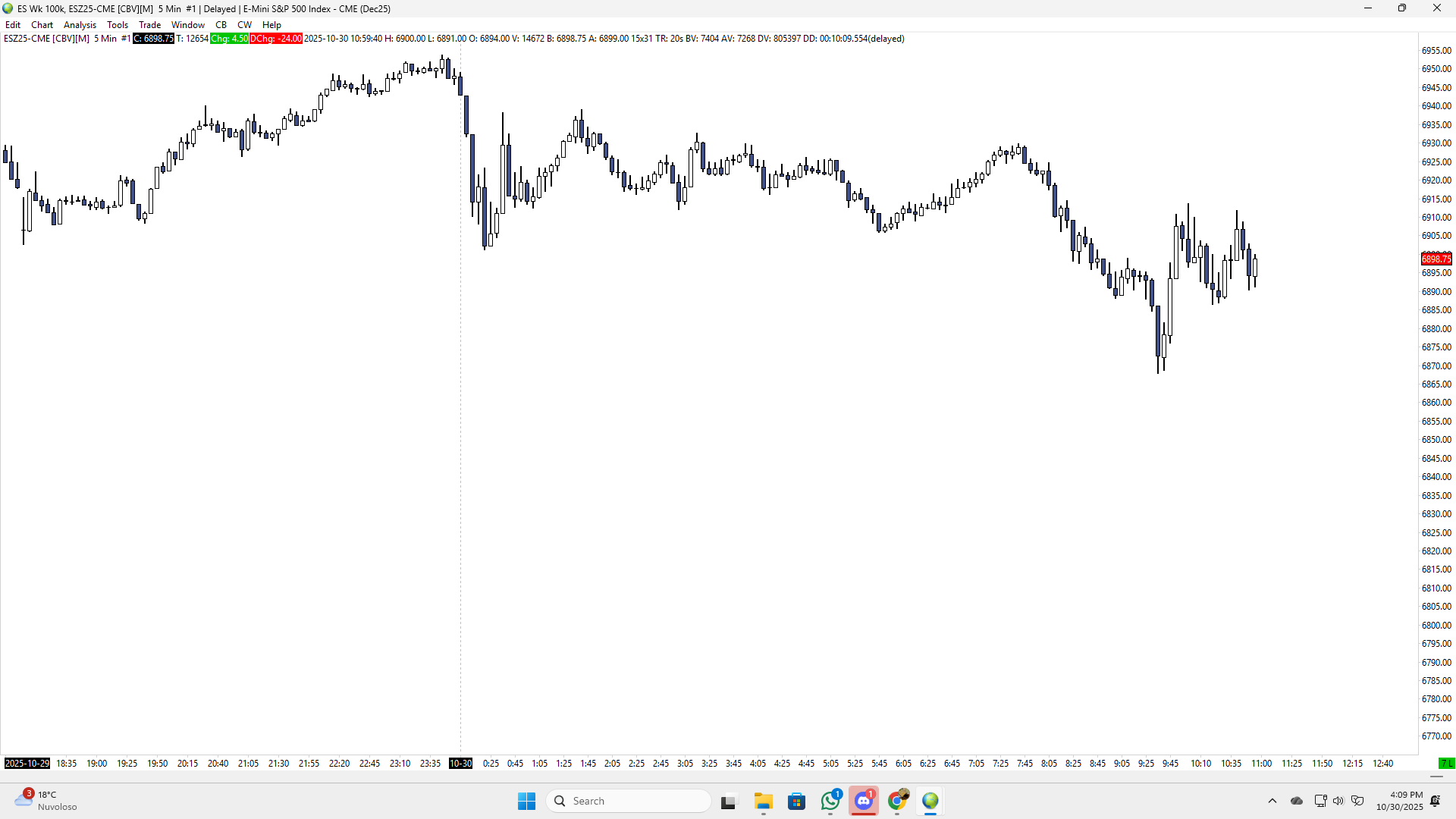

So the file is suppose to show me Benchmark and VWAP and it's not showing up while before it was working fine.
Now it's just a plain chart with candlesticks no VWAP No benchmarks.
imageScreenshot 2025-10-30 110910.png / V - Attached On 2025-10-30 15:05:17 UTC - Size: 257.04 KB - 132 views
imageScreenshot 2025-10-29 120149.png / V - Attached On 2025-10-30 15:05:47 UTC - Size: 169.48 KB - 148 views
[2025-10-30 15:10:29]
User286338 - Posts: 16
Now the chart is just plain
imageScreenshot 2025-10-30 160953.png / V - Attached On 2025-10-30 15:10:07 UTC - Size: 73.65 KB - 179 views
[2025-10-30 15:33:07]
John - SC Support - Posts: 48659
We do not know what might have occurred. First, is that a different chartbook? Did you remove the studies?

[2025-11-01 12:59:26]
Hey i have resolved the chart issue. So what happened was since i downloaded the sierra chart software it was safe mode.
And i have been using since 7 months like this with no issues.
However, when i ask other people they told me to try unticking SAFE MODE so i did and everything went back to normal.
Just so that you know if this problems arises for someone else you might be able to help them in a better way.
