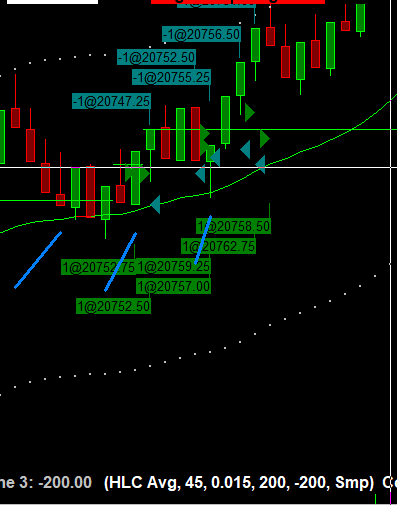

When I execute a trade and the marker on the chart for the position comes up, it seems to be placing it in random spots on the chart. It isn't on the bar or at the moment of execution. It used to work fine but recently changed. I am trading a 9 range chart.

We need to see an image of what you are seeing.

Please see attached. Even the ones on the bars are not in the right spot. You can see the other ones floating.
imageimage.png / V - Attached On 2025-02-28 01:42:31 UTC - Size: 6.41 KB - 225 views

I checked my computer settings and the timezone is set correctly. Is there something in SC that needs done with the time zone setting? How do I do that?

[2025-02-28 21:41:39]
John - SC Support - Posts: 48139
Your computer clock is different from the exchange clock (which is set to match the national standard clock) by 54 seconds. This definitely could cause what you are seeing. Here is the line from the log:
2025-02-28 12:42:37.606 | Local computer UTC time and Server UTC time difference: 54 seconds.
Refer to the following for how to turn on the Network Time Protocol within Sierra Chart to keep your computer time synchronized to the national standard:
Network Time Protocol Client
[2025-02-28 23:57:50]

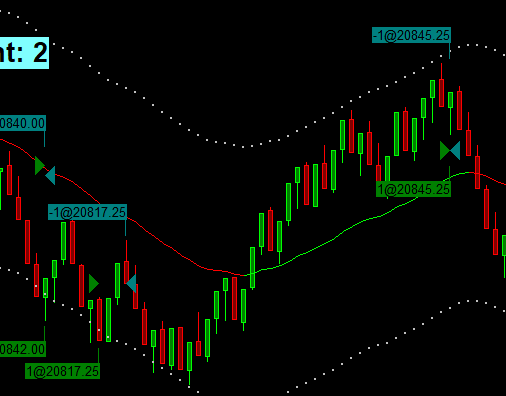

User969241 - Posts: 155
I enabled it but the markers are still off.
imagedrawing.png / V - Attached On 2025-02-28 23:57:49 UTC - Size: 7.74 KB - 192 views
[2025-03-03 14:52:23]
The previous markers will remain offset, as those time stamps were incorrect based on your clock at that time.
Are you still having a problem with new order fills not showing properly? If so, then please get us your Message Log again by following these instructions:
Reconnect to the data feed:
[2025-03-03 21:53:44]
Yes. It is still not showing in the right spot.-

[2025-03-04 03:10:20]
Sierra_Chart Engineering - Posts: 25094
This is the problem:
2025-03-03 16:54:25.326 | Local computer UTC time and Server UTC time difference: 60 seconds.
Refer to:
