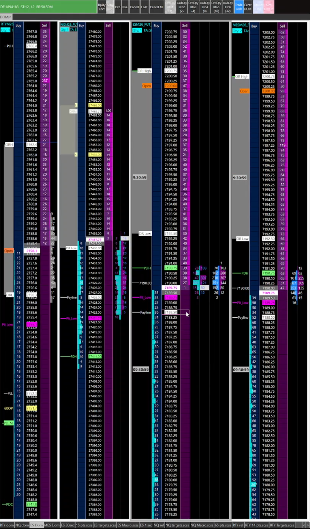

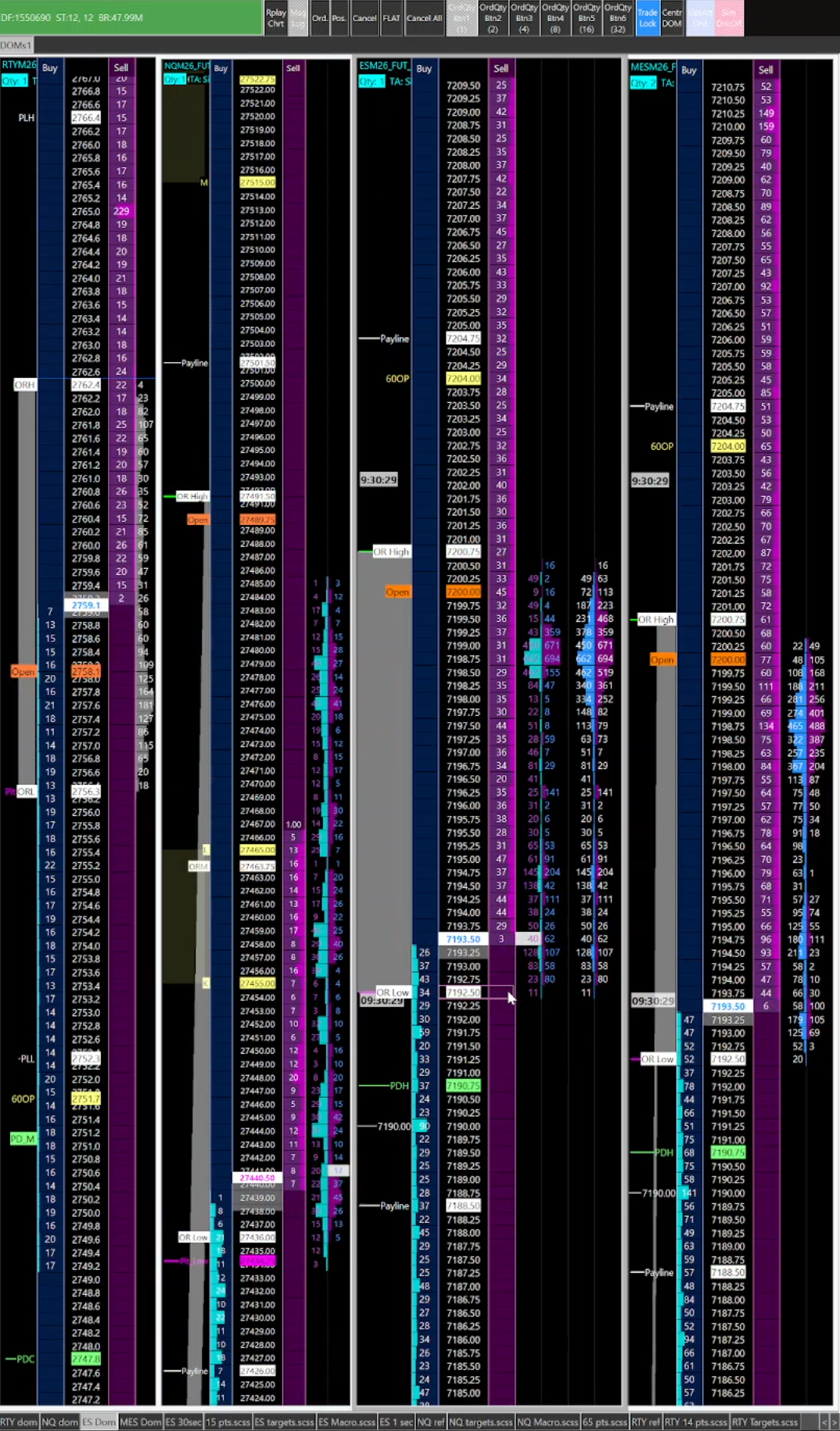

User941854 - Posts: 9
Screenshot 1 is at 09:30:29 EST; ES displays correctly, with the Background Draw Style (fill) fully rendered whereas RTY, NQ, and MES do not. Their High/Low lines are present, but the full fill is delayed until 09:30:59 (screenshot 2).
I am trying to have all symbols render the fill immediately at 09:30:29, consistent with ES as seen in screenshot 1.

[2026-04-30 17:22:18]
Is this an issue in a replay? If so, then you would need to ensure you are replaying the Chart and Trading DOM together.
But what we stated previously still stands. If the information you are looking for is not displayed at the latest bar in the chart, then it will not necessarily be visible in the Trading DOM without changing the Bar Spacing. Even then, you may not be able to see it depending on how far back it goes.
The other option is to setup your information so that it extends to the most recent bar in the chart.

Sébastien - Posts: 156
User941854,
I think your problem comes from 2 things :
- you need to use the draw style Fill Rectangle Bottom/Top. You'll get a cleaner result by doing so.
- You might need to enlarge your DOMs bar spacing by pressing PgUp or Up Arrow.
Doing this should fix your issue.
