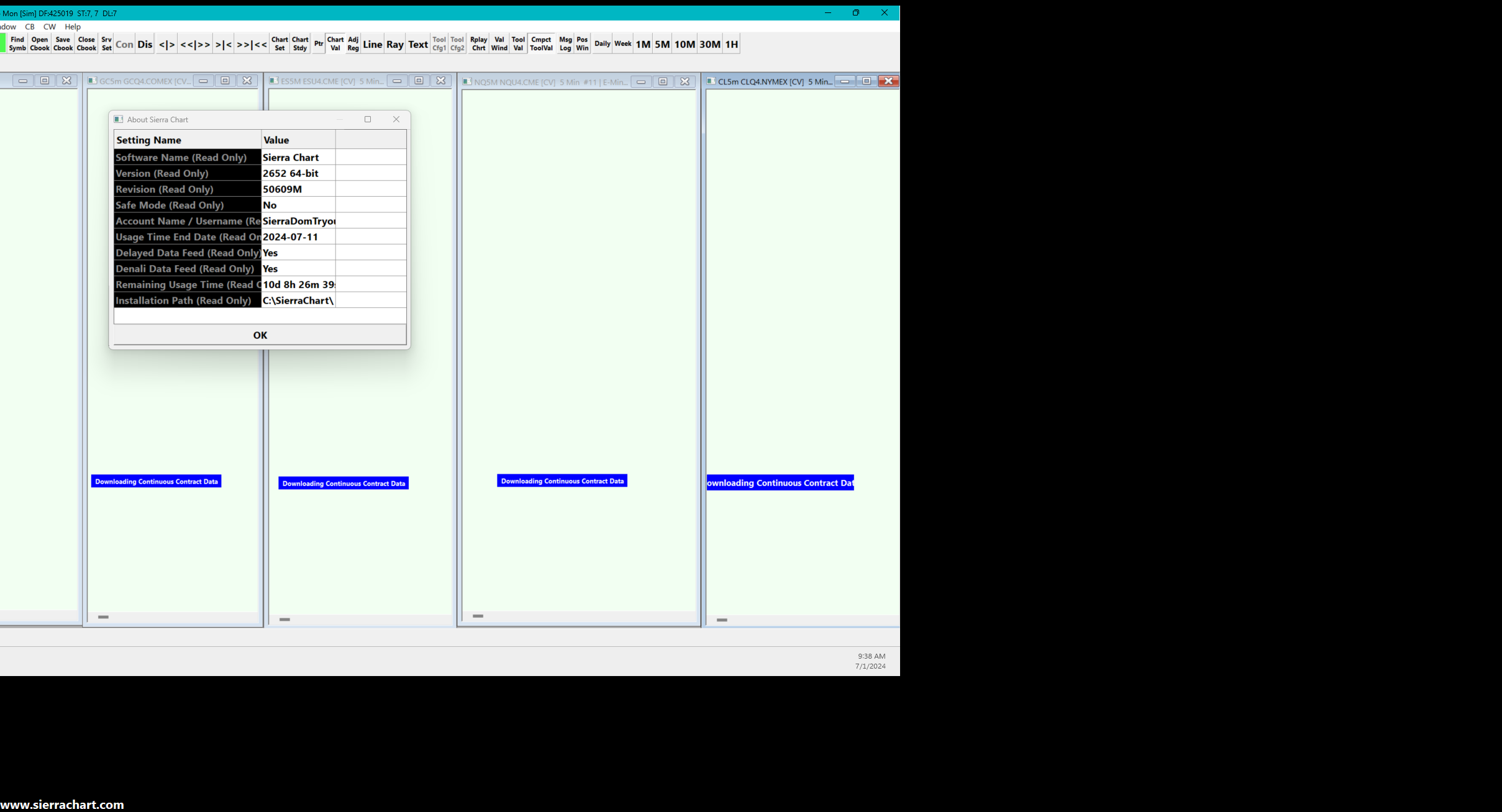

I was on version 2634. Did not know that I needed to upgrade to version 2652. I trade off the DOM on each chart I watch. This morning I experienced child orders that were not cancelled after the target or stop were hit. So I hit cancel a few times in a row. Then the whole connection into Sierra Charts with a Rithmic feed disconnected. When I tried to restart, the charts just say, "Downloading Continuous Contract Data" and they never load.
I came to the support board. I noticed that I needed to upgrade to Sierra Charts so I downloaded and installed the current version. I am on version 2652. However, the charts will still not load. I am a OneUpTrader.
Here is a screenshot of what I am seeing. https://www.sierrachart.com/image.php?Image=1719848332269.png

You are not setup to get any real-time data from us, therefore you are getting your data from Rithmic. Rithmic has a lack of historical data, so using a "Continuous Futures Contract" can cause issues, as if the data is not there, then there will be problems downloading it from Rithmic.
We recommending setting the "Continuous Futures Contract" option to "None" in order to alleviate the immediate issue.
