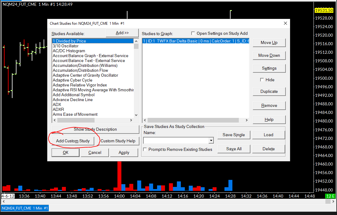

Safe mode prevents me from adding any third party studies. It doesn't matter which one it is the second time I go to add studies and click "ADD Custom Study" the 2nd instance Sierra immediately crashes.
I can't believe its my computer as main Sierra is the most solid piece of software I've ever run zero crashes in main instance.
So to repeat I create second instance create a chart or load workspace with charts. Add Study go to add custom study add one have tried 30+ they all load the first time and if I leave running never crash. If I go back either in seconds, minutes or hours and click Add Custom Study CRASH. It's instant and 100% of the time this has happened probably 75-100 times as my main instance takes up too much CPU so its essential I run other instances.

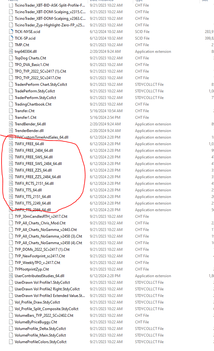

I agree but my point is there's NO WAY TO TELL WHICH study isn't working.
If I delete a custom study will it show back up the next time I start Sierra? Or do all the studies in main data directory get copied the FIRST time opening a 2nd instance. I don't want to go through them all, delete them all then have them show back up next time I create second instance.
That's the main point of my post how can I get rid of third party studies? Here's SOME I know are third party if I delete these and close sierra and start back up, create 2nd instance will they show up again?
Remember its not the loading of a 3rd party study that's causing the crash just clicking Sierra's button to add additional studies that crashes it. If I can track down which study or studies are causing this can let that developer know and you guys too because none crash main instance. The other instances are not as stable as main Sierra is, it doesn't make sense why a study would crash that but never crashes main instance.
