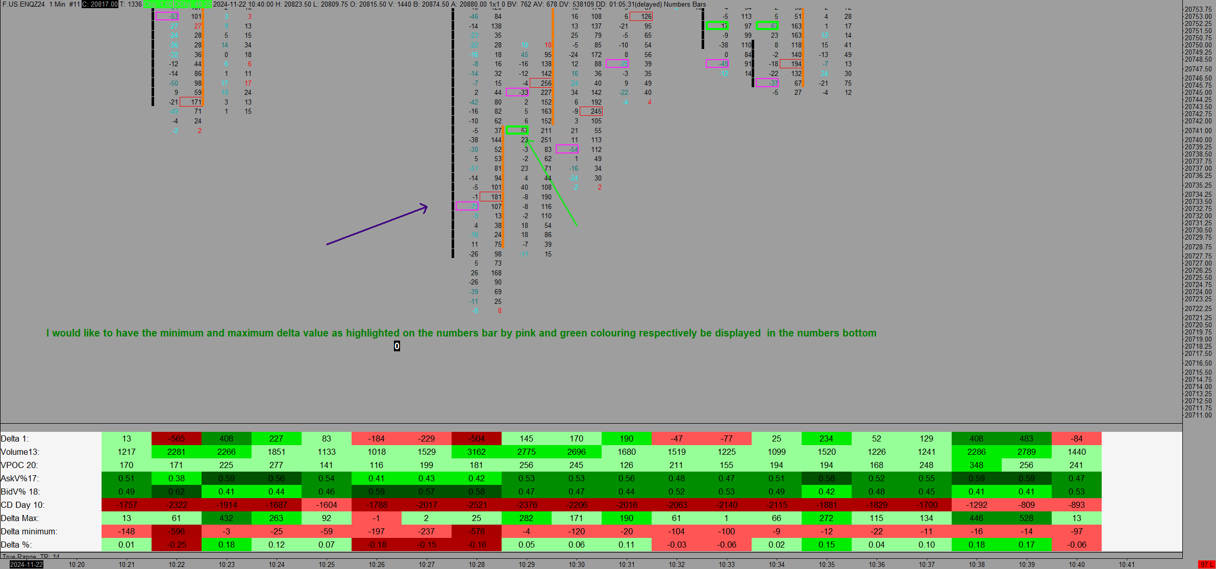

https://www.sierrachart.com/image.php?Image=1732418967107.png Please have a look at this chart, I want to display the minimum and maximum value from my numbers bars to numbers bottom. If I can be pay an extra fee for this I don't mind or if I can be able to solve it on my own please guide me on how I can go about it. It means a great deal for my chart studies. |

You can do this using the built-in tools. Do the following: - Add the Numbers Bars study. - Set the Input for "Highlight Minimum Value In" to a particular column where you want to have the highlight - Set the Input for "Highlight Maximum Value In" to a particular column where you want to have the highlight - Set the Input for "Highlight Maximum/Minimum Value Based On" to "Bid Volume or Ask Volume" - Set the Input for "Ignore 0 Values for Minimum Highlight" to "Yes" With the above, the Numbers Bars subgraphs for "Price at Minimum Highlight" and "Price at Maximum Highlight" will have the price level for the Minimum/Maximum Bid or Ask. If you want the actual Minimum/Maximum numbers, then do the following: - Add two copies of the "Spreadsheet Formula" study to the chart. Enter the following formulas to get the maximum and minimum numbers (one each into each Spreadsheet Formula): =IF(AVAP(ID1.SG4, 0) <= BVAP(ID1.SG4, 0), AVAP(ID1.SG4, 0), BVAP(ID1.SG4, 0)) =IF(AVAP(ID1.SG5, 0) >= BVAP(ID1.SG5, 0), AVAP(ID1.SG5, 0), BVAP(ID1.SG5, 0)) Where ID1 is the ID of the Numbers Bars study, SG4 is the "Price at Minimum Highlight" subgraph, and SG5 is the "Price at Maximum Highlight". You can then use the "Numeric Information Reference" study to put those values into a numeric table (similar to the "Numbers Bars Calculated Values" study). Refer to the following: Numbers Bars: Highlight Minimum Value In Numbers Bars: Highlight Maximum Value In Numbers Bars: Highlight Maximum/Minimum Value Based On Numbers Bars: Ignore 0 Values for Minimum Highlight Spreadsheet Formula Study/Chart Alerts And Scanning: Special Functions Numeric Information Reference For the most reliable, advanced, and zero cost futures order routing, use the Teton service: Sierra Chart Teton Futures Order Routing |

Hey John, thank you for getting back to me. I have been trying to apply the formula you have sent me but it does not produce the desired results. I want the maximum (ask vol-bid vol) and the minimum (ask vol-bid vol) be displayed similar to the "Numbers Bars Calculated Values" study and not the Bid vol or Ask vol. I have also noticed that when I add a study to my chart and then I click apply to load the added study onto the chart, the spread sheet values resets to zero. I would also really appreciate if you could help me on this. Thank you. |

Hey John,I have managed to display the minimimum and max delta on the spreadsheet formula.The only issue remaining is I cannot add another study onto the chart without my spreadsheet formula displaying zero. Attached below is an image of the results. https://www.sierrachart.com/image.php?Image=1732561142882.png |

We are not understanding what you are wanting exactly. In your Numbers Bars Calculated Values you already have the Minimum and Maximum Delta. The formulas we gave you with the particular setup will only give you the price point of the Minimum and Maximum Bid or Ask. Taking the delta at those locations does not give the Minimum and/or Maximum delta in the bar. Let us know exactly what you are after and we can help you get there. For the most reliable, advanced, and zero cost futures order routing, use the Teton service: Sierra Chart Teton Futures Order Routing |
