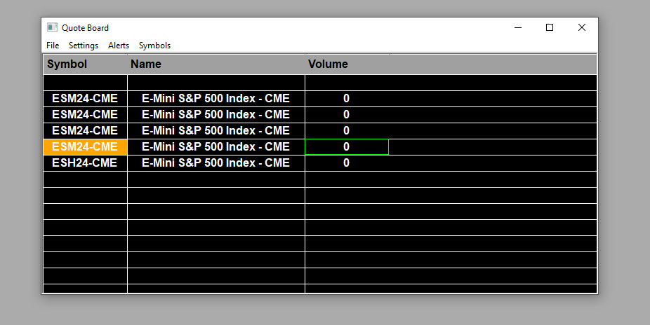

i am trying to access the delayed volume data for ES and crude oil, but for some reason it is not loading. As you can see on the screenshot I have rolled over the symbol and have, for instance, for ES, set for the most current - ESM. It worked fine before. Has there possible been an update to the package service I am using, so am no longer able to see the real-time (altough delayed) data? I have currently applied ESM24 - CME contract
I appreciate your response,
thanks,
Vedran
imageSnimka zaslona 2024-04-03 205528.png / V - Attached On 2024-04-03 18:55:52 UTC - Size: 21.82 KB - 297 views

The first issue is that you are on an older version and you need to update. The Delayed Streaming Data we have is no longer able to be used in the version you are running. Follow these instructions to update:
As to why you are getting Delayed data, this is due to the fact that you are on the "Base Advanced" package. The "Base" packages do not have support for the real-time data for the CME Group, just the delayed streaming data.
If you are wanting to access real-time data for the CME Group then you need to be on one of the "Integrated" packages to start with. Refer to the following:
Description of Service Packages and Pricing: Integrated Packages
And you also need to have a live, funded, futures trading account in order to qualify for the non-professional exchange fees for the CME Group. And you need to be able to connect your Sierra Chart software to that account at least once a month for verification. Refer to the following:
Real-Time Exchange Data Feeds Available From Sierra Chart: Understanding and Accessing Data From the CME, CBOT, NYMEX, COMEX Exchanges
If you do not have an account that will qualify for the above, then refer to the solution outlined at the following link:
Easy Solution to CME Funded Trading Account Requirement
Once you have the above worked out, then you would go through the Setup Instructions at the following link to setup, activate, and pay for the real-time data for the CME Group:
