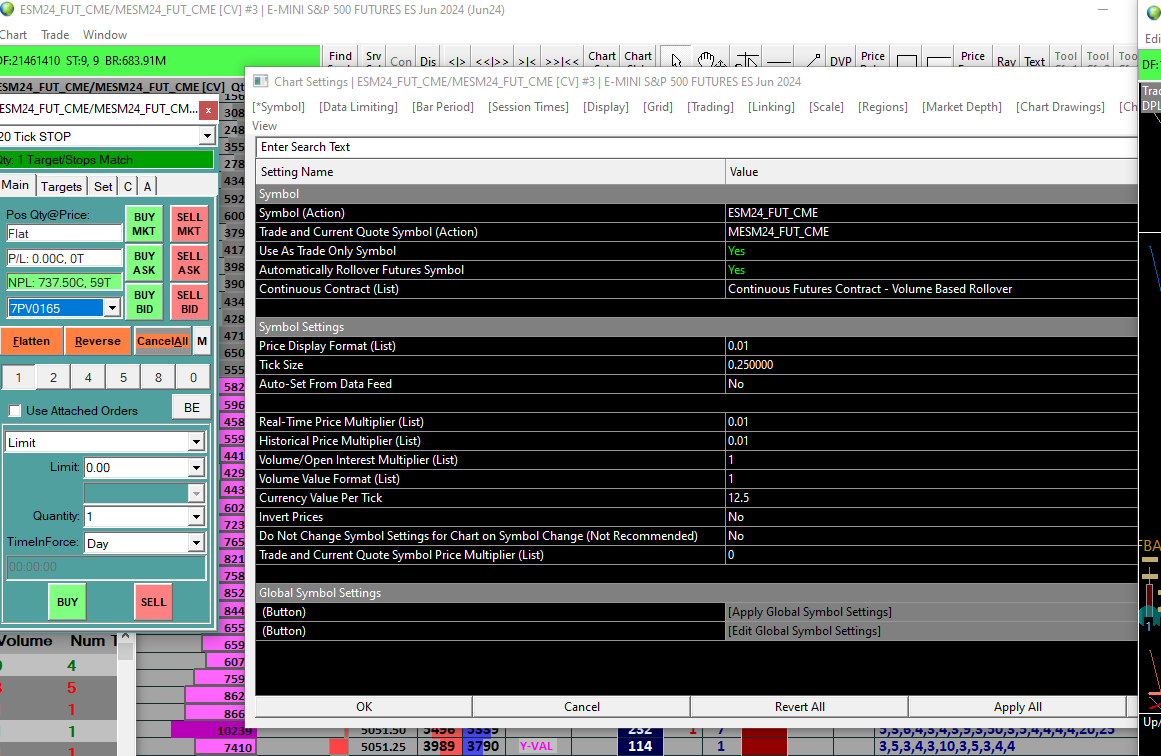

Not a big deal, but i have a Trade DOM in a separate instance where my symbol is ES and I am trading MES and the PnL displays for ES even though my trades are going through as MES
I have tried to remedy this a number of ways
Its really not a problem for me. i have been using it this way
But i wanted you to be aware of this - especially since you said it is impossible
I will attach a screenshot let me know if you want more info
imageTrade Window PnL Issue.PNG / V - Attached On 2024-05-01 15:45:35 UTC - Size: 91.39 KB - 162 views
[2024-05-01 18:30:10]
What you are doing is fine, it is not impossible. The above response was not considering the "Trade and Current Quote Symbol".
You need to adjust the "Chart >> Chart Settings >> Symbol >> Currency Value per Tick" for that Chart/Trade Window so that the Currency Value per Tick is for the MES, not the ES. Refer to the following:
Chart Settings: Updating Currency Value per Tick for Trade Symbol
