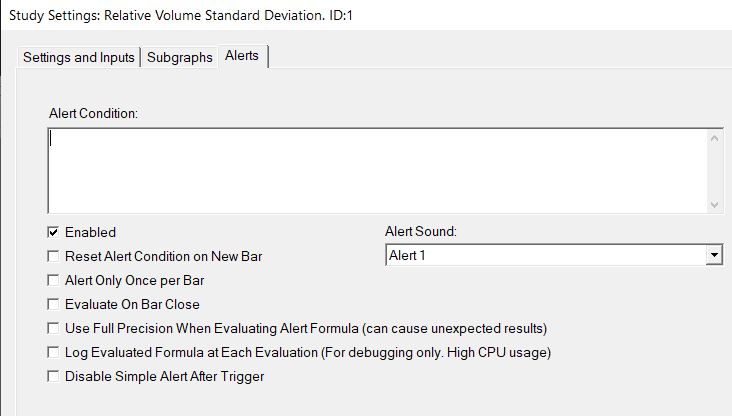

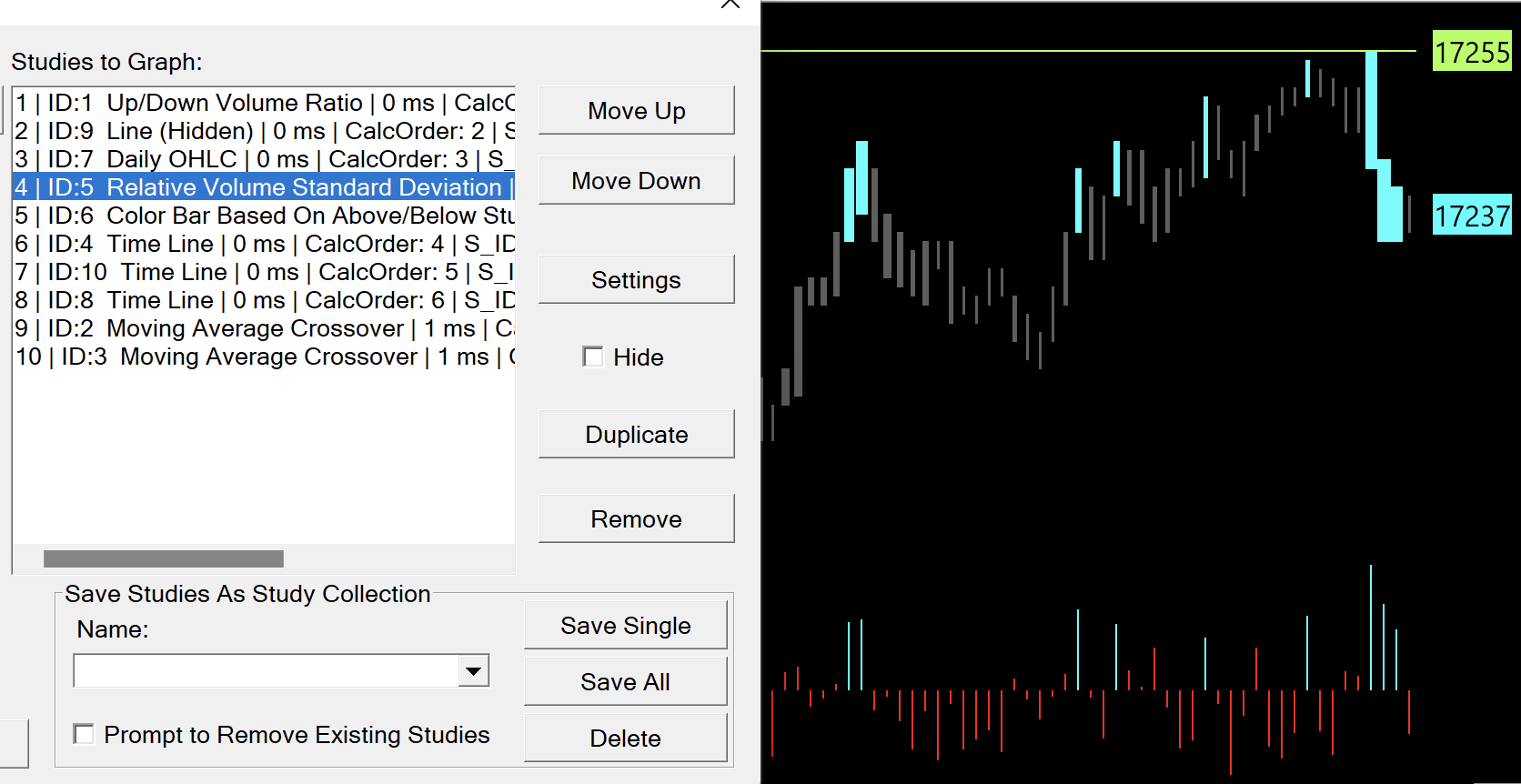

I have enabled the alert option in both the studies window and general settings. Screenshot attached.
I also tried different .wav files with no audible alert.
Even the message log is not showing any alerts.
Not sure what I'm missing here. Is that related to the nature of the indictor itself?
Date Time Of Last Edit: 2024-02-19 08:29:53
imagea.JPG / V - Attached On 2024-02-19 08:28:15 UTC - Size: 38.86 KB - 240 views
imageb.JPG / V - Attached On 2024-02-19 08:28:24 UTC - Size: 63.23 KB - 233 views
[2024-02-19 17:22:19]
You do not have an Alert Formula entered in the "Relative Volume Standard Deviation" study. Therefore, there is nothing to alert on.
You had stated that you have a "Color Bar Based on Alert Condition" study that is coloring the bar when the condition you want is true. If this is correct, then you need to add the "Alert Number" to the Alert Tab for the "Color Bar Based on Alert Condition" study.

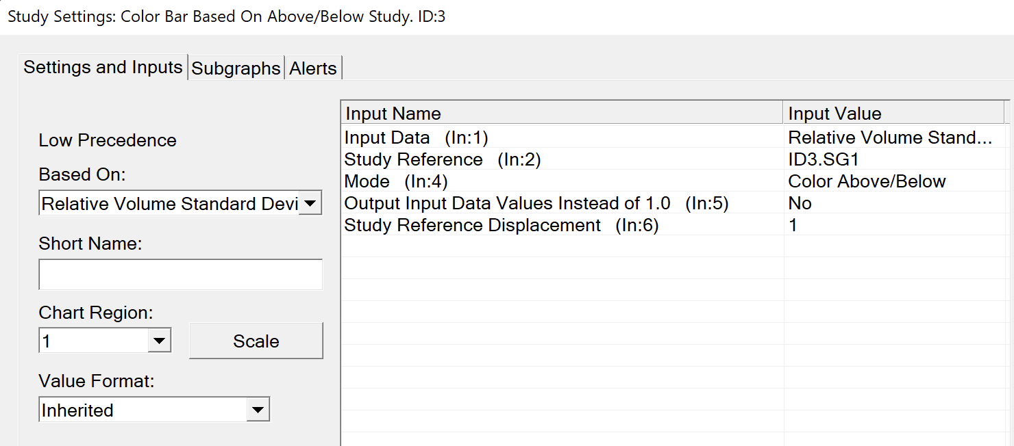

It's still not working. Please note that I have a Color bar based on 'Above/Below study' rather than 'Alert Condition'. Screenshot attached.
Since the 'study' doesn't have any alert formula, I guess we still have the original problem.
Regards
Date Time Of Last Edit: 2024-02-20 09:31:40
imageScreenshot 2024-02-20 at 1.38.40 PM.png / V - Attached On 2024-02-20 08:11:24 UTC - Size: 81.67 KB - 394 views
[2024-02-20 17:20:34]
Since you are using the "Color Bar Based on Above/Below Study", you are correct that there is not an existing formula that we can use.
Keep in mind that the "Color Bar Based on Above/Below Study" is going to color every bar depending on whether the Input for "Input Data" is actually above or below the referenced study. Therefore, what we would need to understand is when do you want the alert to go off? Is it just for one of the situations (Above or Below) or something more specific?

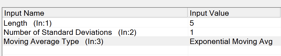

The 3 inputs, with my preferred values, are attached in the screenshot. They are
1. length e.g 5
2. Std. Deviation. e.g 1
3. Moving average e.g EMA
Any help will be greatly appreciated. Thanks

Does your "Color Bar Based on Above/Below Study" work properly? From what we see in your image, it is setup to reference itself, so there is not a way for it to actually work.
Let's start at the beginning. You are using the "Relative Volume Standard Deviation" study to look at something. What exactly do you want to compare the results of the "Relative Volume Standard Deviation" against?

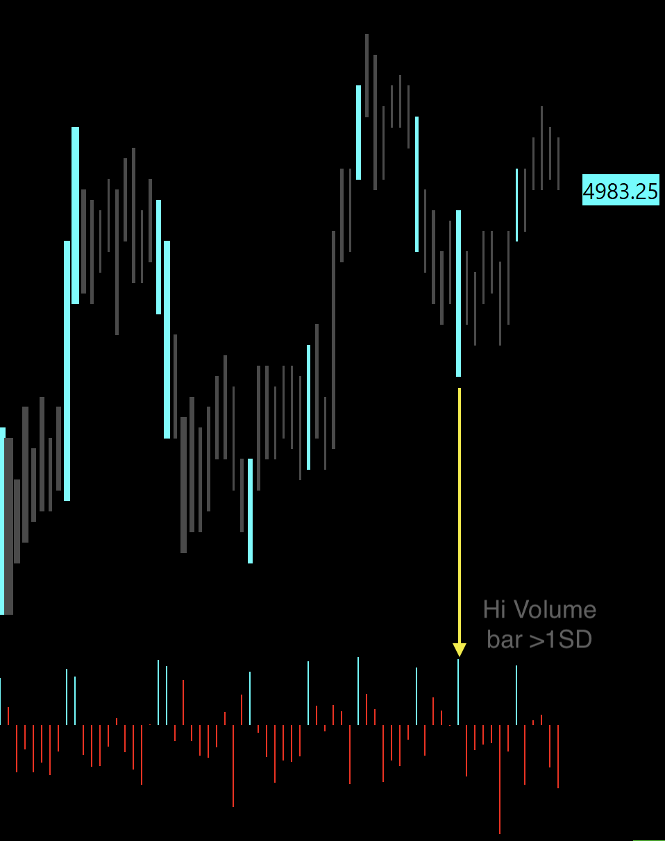

I want to identify 'high volume' bars.
At each bar close, it will be compared against the EMA of the last 5 bars and if it's more than 1 standard deviation to the upside, I want an alert.
Please note that the 'Relative Volume Standard deviation' indicator is an existing in-built indicator and NOT custom built but it serves my purpose very well.
My only additional requirement is adding audio alert in addition to visual 'color bar' alert.
