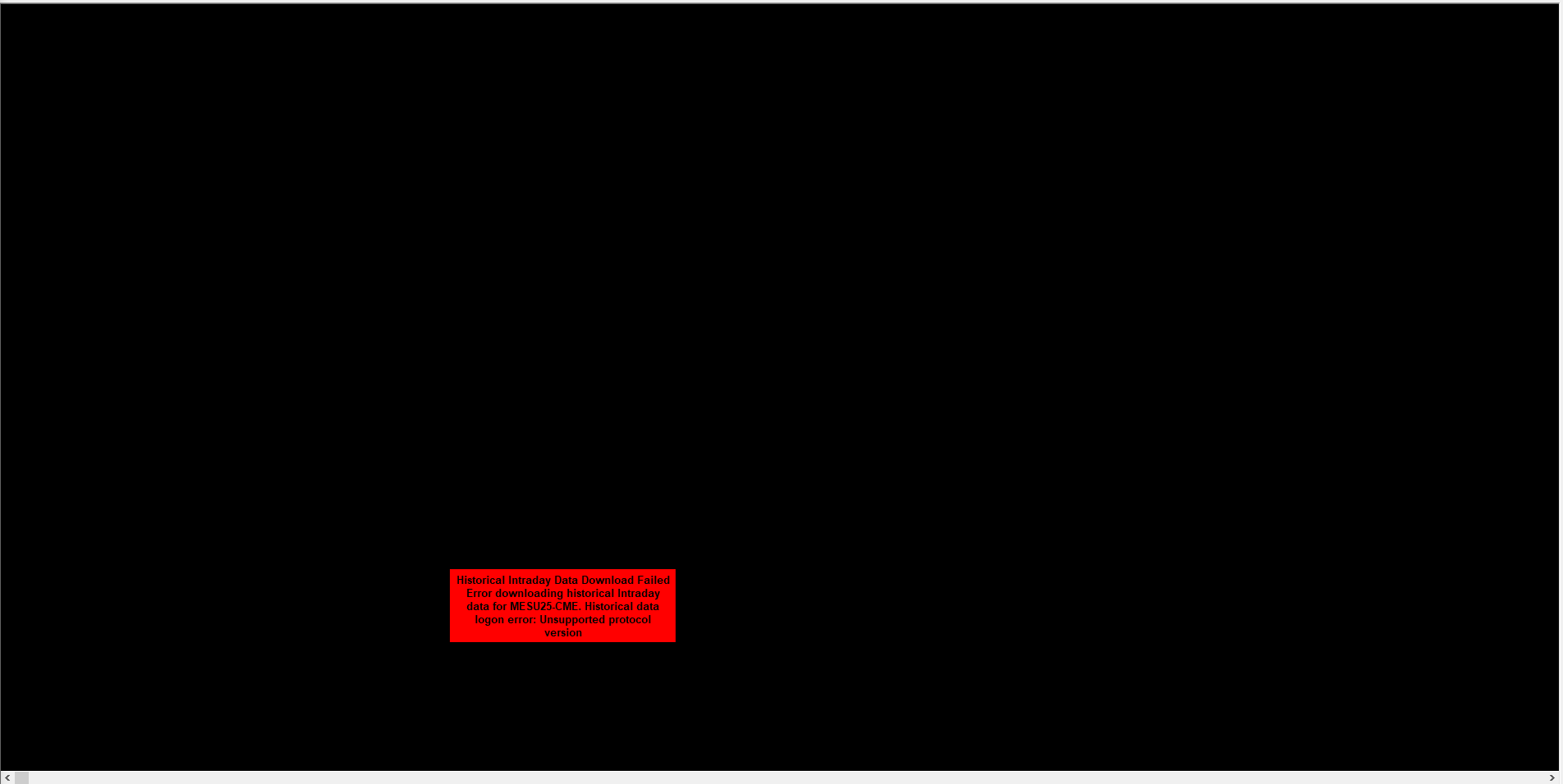

Dear Sierra Chart,
I opened the platform today and received an error "Error downloading historical intraday data for EURUSD. Historical data logon error: Unsupported protocol version". Please see attached. Basically, I am not getting the data from overnight at the moment. Wondering if you would be able to please help. I did perform an update to Sierra chart to current version. Also, no updates have been performed to my PC in the last 48 hours.
Thank you in advance.

[2024-02-08 09:20:17]
Sierra_Chart Engineering - Posts: 25476
This is very unusual to get an error like that. It indicates corrupted data, really which should never happen.
Try again:
Re-download all the data in the chart by going to the chart and selecting "Edit >> Delete All Data and Download" from the main Sierra Chart menu. You just need to do this once per symbol and not for each chart. This command is on the main Sierra Chart menu at the top. Only use it from that location.
Date Time Of Last Edit: 2024-02-08 09:20:28
[2024-02-08 10:20:27]
florinsandru - Posts: 14
Hi Sierra chart,
That worked. Thank you very much for your help.
Have a greats rest of your day!
Regards,
Florin.

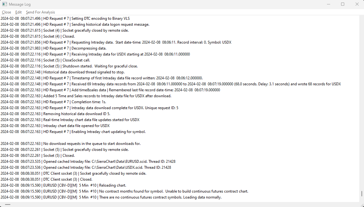

Hello I have tried this but the data is no downloading.
imageScreenshot 2025-08-05 214857.png / V - Attached On 2025-08-05 13:47:56 UTC - Size: 15.41 KB - 290 views
[2025-08-05 13:52:04]
Fully re-download the data in the chart by going to the chart and selecting "Edit >> Delete All Data and Download". Only use this command from the Edit menu at the top of the main window or chart.
Or, in the case of a Continuous Futures Contract chart, follow these instructions:
After about a minute provide a copy of the Message Log following these instructions:

jethrogou - Posts: 56
It didn't fix the issue
imageScreenshot 2025-08-05 220508.png / V - Attached On 2025-08-05 14:04:34 UTC - Size: 198.34 KB - 201 views

2025-08-05 22:13:37.066 | HD Request # 1 | Sending historical data logon request message.
2025-08-05 22:13:37.066 | Socket (2) | CloseSocket call.
2025-08-05 22:13:37.066 | Socket (2) | Write in progress. Shutdown being delayed. PendingSize=0
2025-08-05 22:13:37.066 | HD Request # 1 | Error downloading historical Intraday data for MESU25-CME. Historical data logon error: Unsupported protocol version
2025-08-05 22:13:37.067 | Historical data download thread signaled to stop.
2025-08-05 22:13:37.067 | HD Request # 1 | Received 0 Intraday data records from 00:00:00.000000 to 00:00:00.000000 (0.0 seconds and wrote 0 records for MESU25-CME
2025-08-05 22:13:37.067 | HD Request # 1 | Add time&sales data | Remembered last file record date-time: 00:00:00.000000
2025-08-05 22:13:37.067 | HD Request # 1 | Completion time: 25s.
2025-08-05 22:13:37.067 | HD Request # 1 | Intraday data download complete for MESU25-CME. Unique request ID: 1
2025-08-05 22:13:37.067 | Removing historical data download ID 1.
2025-08-05 22:13:37.067 | Real-time Intraday chart data file updates started for MESU25-CME
2025-08-05 22:13:37.067 | Intraday chart data file opened for MESU25-CME
2025-08-05 22:13:37.067 | HD Request # 1 | Enabling Intraday chart updating for symbol.
2025-08-05 22:13:37.067 | No download requests in the queue to start downloads for.
2025-08-05 22:13:37.413 | Socket (2) | Write has completed. Shutdown being performed.
2025-08-05 22:13:37.413 | Socket (2) | Shutdown started. Waiting for graceful close.
2025-08-05 22:13:37.678 | Socket (2) | Socket gracefully closed by remote side.
2025-08-05 22:13:37.678 | Socket (2) | Closed.
2025-08-05 22:13:39.306 | Denali Data Feed | Connecting to the server ds25-2.sierracharts.com. Port 443
2025-08-05 22:13:39.313 | DTC Client socket (2) | Creating socket.
2025-08-05 22:13:39.313 | DTC Client socket (2) | New receive buffer size: 0
2025-08-05 22:13:39.313 | DTC Client socket (2) | Connecting to IP: 64.152.155.21.
2025-08-05 22:13:39.593 | Denali Data Feed | Network connection to server complete.
2025-08-05 22:13:39.593 | Denali Data Feed | Starting socket receive thread.
2025-08-05 22:13:39.594 | Denali Data Feed | Sending encoding request to server: Binary VLS. Compression: standard
2025-08-05 22:13:59.595 | Denali Data Feed | Did not receive Encoding Response from server. Disconnecting. *
2025-08-05 22:13:59.595 | Denali Data Feed | Waiting for socket receive thread to end
2025-08-05 22:13:59.595 | DTC Client socket (2) | CloseSocket call.
2025-08-05 22:13:59.595 | DTC Client socket (2) | Shutdown started. Waiting for graceful close.
2025-08-05 22:13:59.595 | Denali Data Feed | Disconnected from the server.
2025-08-05 22:13:59.595 | Denali Data Feed | Data feed disconnected. Will reconnect in 3 seconds.
2025-08-05 22:14:02.597 | Denali Data Feed | Connecting to the server ds26-2.sierracharts.com. Port 10048
2025-08-05 22:14:14.637 | DTC Client socket (3) | Creating socket.
2025-08-05 22:14:14.637 | DTC Client socket (3) | New receive buffer size: 0
2025-08-05 22:14:14.637 | DTC Client socket (3) | Connecting to IP: 64.152.155.18.
2025-08-05 22:14:26.602 | Denali Data Feed | Timeout connecting to server.
2025-08-05 22:14:26.602 | Denali Data Feed | Failed connections: 2
2025-08-05 22:14:26.602 | DTC Client socket (3) | CloseSocket call.
2025-08-05 22:14:26.603 | Denali Data Feed | Disconnected from the server.
2025-08-05 22:14:26.603 | Denali Data Feed | Data feed disconnected. Will reconnect in 3 seconds.
2025-08-05 22:14:26.603 | DTC Client socket (3) | Closed.
2025-08-05 22:14:29.604 | Denali Data Feed | Connecting to the server ds26.sierracharts.com. Port 10048
2025-08-05 22:14:29.610 | DTC Client socket (3) | Creating socket.
2025-08-05 22:14:29.610 | DTC Client socket (3) | New receive buffer size: 0
2025-08-05 22:14:29.610 | DTC Client socket (3) | Connecting to IP: 64.152.155.17.
2025-08-05 22:14:29.903 | Denali Data Feed | Network connection to server complete.
2025-08-05 22:14:29.903 | Denali Data Feed | Starting socket receive thread.
2025-08-05 22:14:29.903 | Denali Data Feed | Sending encoding request to server: Binary VLS. Compression: standard
