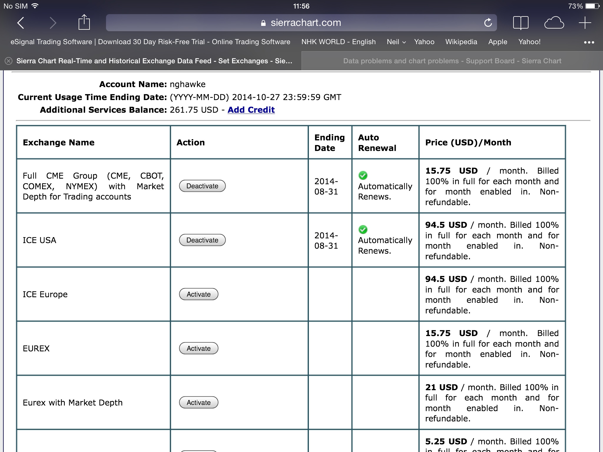

3. I activated the data feed in SC for the following services
i. SC feed
ii. ice data
iii. Full CME group data
I have an active IB account. Should the charts from CME group display the [M] because I'm not seeing it. If this is ok then no problem. I have attached a screen shot of the activation screen.
B. I will review the topics you suggest.
Thanks and Regards
Neil.
imageimage.jpg / V - Attached On 2014-08-05 02:56:48 UTC - Size: 492.35 KB - 512 views
[2014-08-05 04:31:23]
What you did is correct.
You should definitely see the [M] at the top of the charts for CME Symbols.
We want you to update the Symbol Settings and reconnect to the data feed. Here are the instructions:
Global Symbol Settings: Update/Apply Symbol Settings to Charts
If you still do not see the [M], then post a copy of the Message Log, by following these instructions:
https://www.sierrachart.com/index.php?page=PostingInformation.php#log
