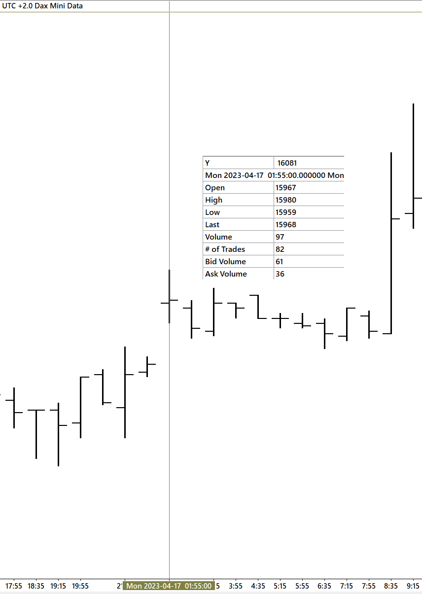

imageDAX 40 min chart summer time 01_55 is incorrect.png / V - Attached On 2024-01-15 00:38:54 UTC - Size: 28.98 KB - 215 views

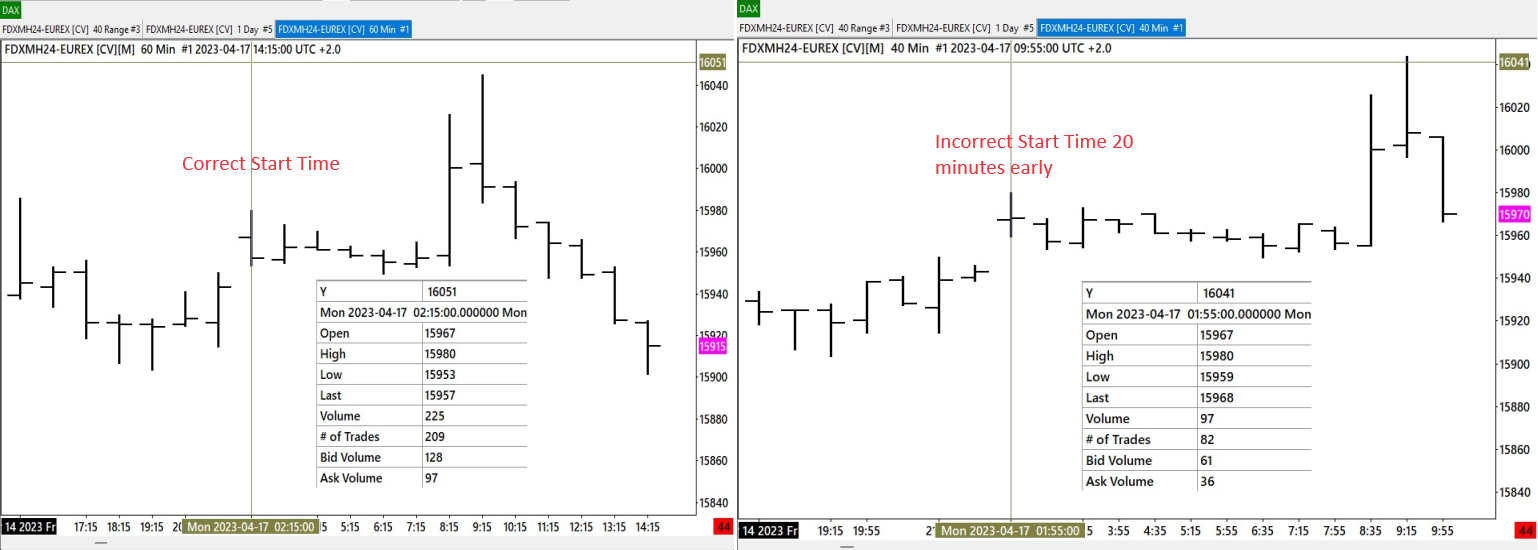

I have provided a pic of a 60 minute chart which starts at the correct time ie 02:15 and the same chart but bar period changed to 40 minutes.
The start time is now 01:55 (20 mins earlier) NOT 02:15 - the correct start time.
This of course makes all the following bars incorrect for the 40 minute bar interval.
The last 40 minute bar has a timestamp of 21:55. This is the same time stamp for non-daylight saving. With a start at 01:55. If it starts at the correct time the last bar stamp should be 21:35.
As mentioned previously the time stamps for 40 minute bars are correct during normal time.

[2024-01-16 14:27:43]
What we stated previously still holds. The issue is that you have Session Times starting at 01:15. As such, with a 40 minute Bar Period, you will have a bar at 01:55, as you note above, regardless of the DST setting.
The reason the DST comes into play is that the exchange does not start until 02:15 when DST is active. Therefore, the first trade will be at 02:15 and not at 01:15. Therefore, the first bar that covers this time is the one at 01:55. Hence the reason for the bar at that time. When you have 1 minute bars it does not show this as you actually have a 1 minute bar at 02:15. The same is true for 60 minute bars - you have a new bar that will start at 02:15.
