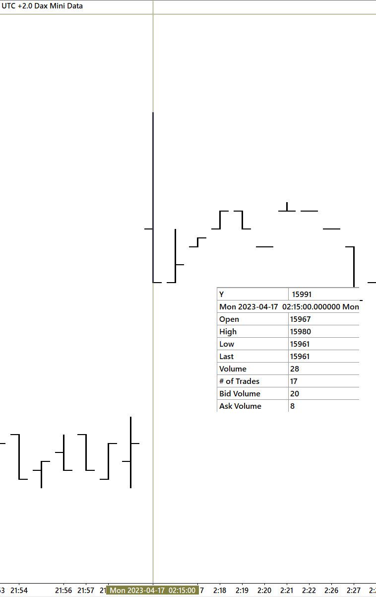

I have my Global TZ set to +1/+2 Brussels and a DAX chart set to Brussels TZ. All my FDX data was downloaded with those settings.
If I select 1 minute bars the chart start time is correct. ie. No DST is 01:15 and during DST (DAX starts 1 hour later) is 02:15.
If I change the bar period to say 40 minutes the first bar time stamp is correct when no DST ie. 01:15 but during DST the bars start at 01:55 which is 40 mins after the normal start time ie. 01:15.
The session should start at 02:15 and the next bar should be 02:55.
When I change the chart to a 60 minute bar the start times are all correct.
I have not encountered this with any of the US markets.
Thank you, Peter.
imageDAX 1 min chart summer time 02_15 is correct.png / V - Attached On 2024-01-15 00:38:33 UTC - Size: 27.54 KB - 251 views
imageDAX 40 min chart summer time 01_55 is incorrect.png / V - Attached On 2024-01-15 00:38:54 UTC - Size: 28.98 KB - 215 views
