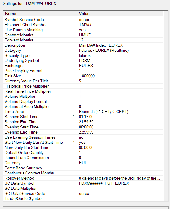

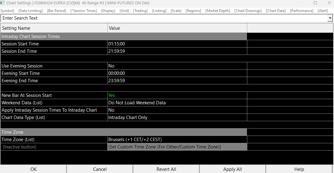

Thanks for your reply. I read the information you pointed me to and I believe I have all my session times correct as shown in attached pics.
Symbol settings are 01:15 to 21:59:59. Time zone is UTC +1/+2. Global time setting is set to the same as are the chart session times.
