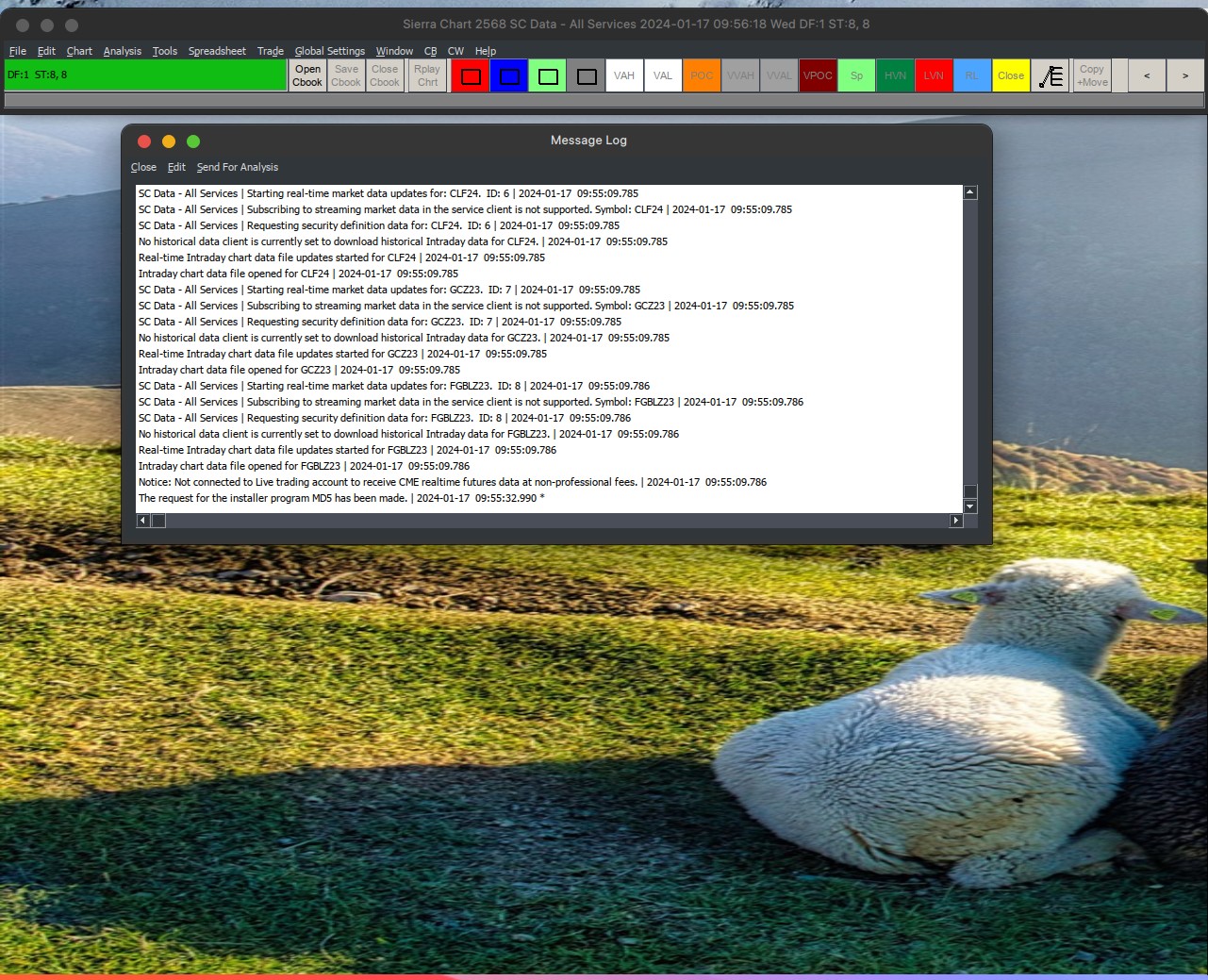

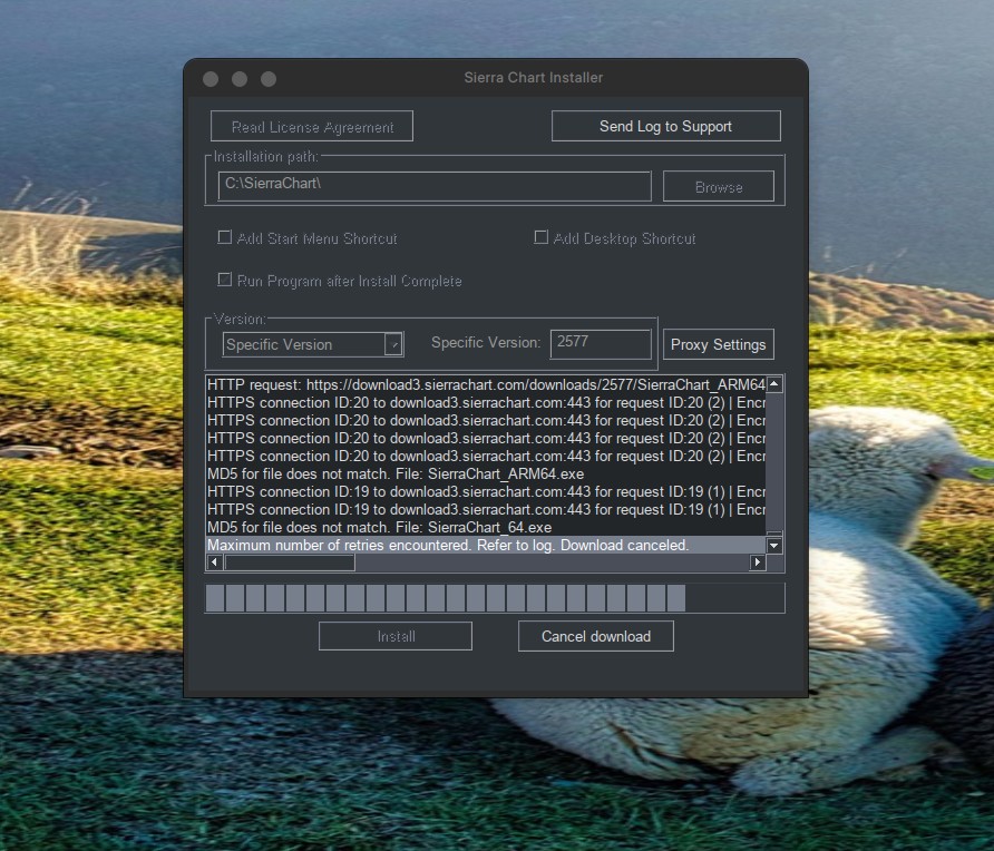

[2024-01-17 09:48:54]
User805074 - Posts: 29
Good morning,
I send you a copy of the message log after disconnecting the data source, and connection for 1 minute, but connected to Trading Evaluator - Delayed it enters in a loop of connection and reconnection, without connecting successfully, I run Sierra Chart in Linux Kubuntu 64 bits 22. 04, plasma 5.27.10, kernel 5.15.0-91-generic (64)bits, without problems until this week, when I can't update the version, neither from the platform, nor from the downloaded installer, as you can see in the screenshots, the error is:
MD5 for file does not match. File: SierraChart_64.exe
Thanks.

imageScreenshot_20240117_095627.jpg / V - Attached On 2024-01-17 09:48:01 UTC - Size: 423.64 KB - 261 views
imageScreenshot_20240117_095926.jpg / V - Attached On 2024-01-17 09:48:11 UTC - Size: 194.18 KB - 291 views

John - SC Support - Posts: 48643
We see the following in your log:
DTC Client socket (6) | Connect event error. Windows error code 10061: Conexión rechazada.
Refer to the following regarding this:
Historical Intraday Data (Missing Data / Download Errors / Viewing More Data): Error when Downloading Historical Intraday Data from the Sierra Chart Historical Data Server
With regards to the updater, use the Zip installer instead:
Software Download: Sierra Chart Zip Installer

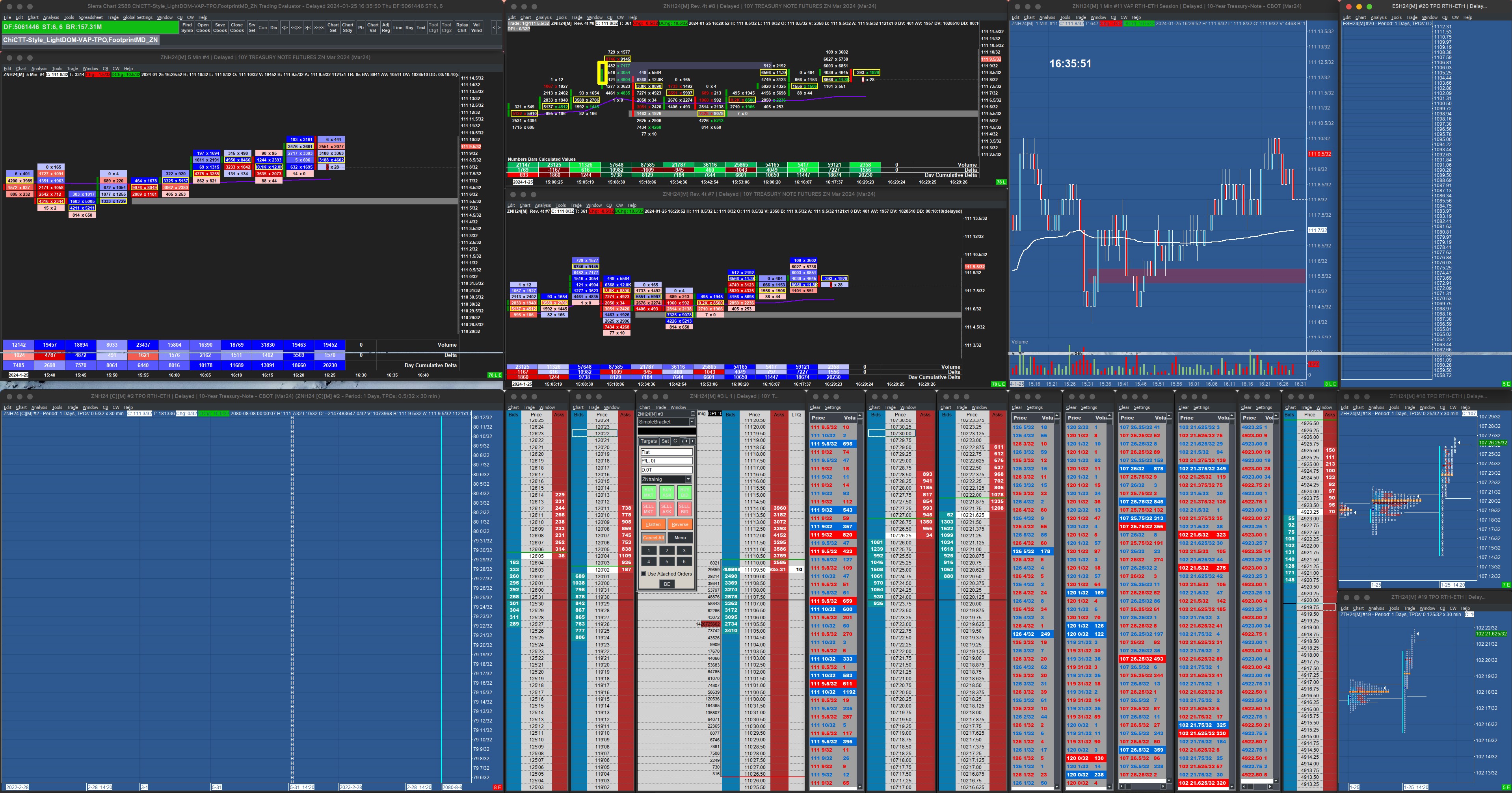

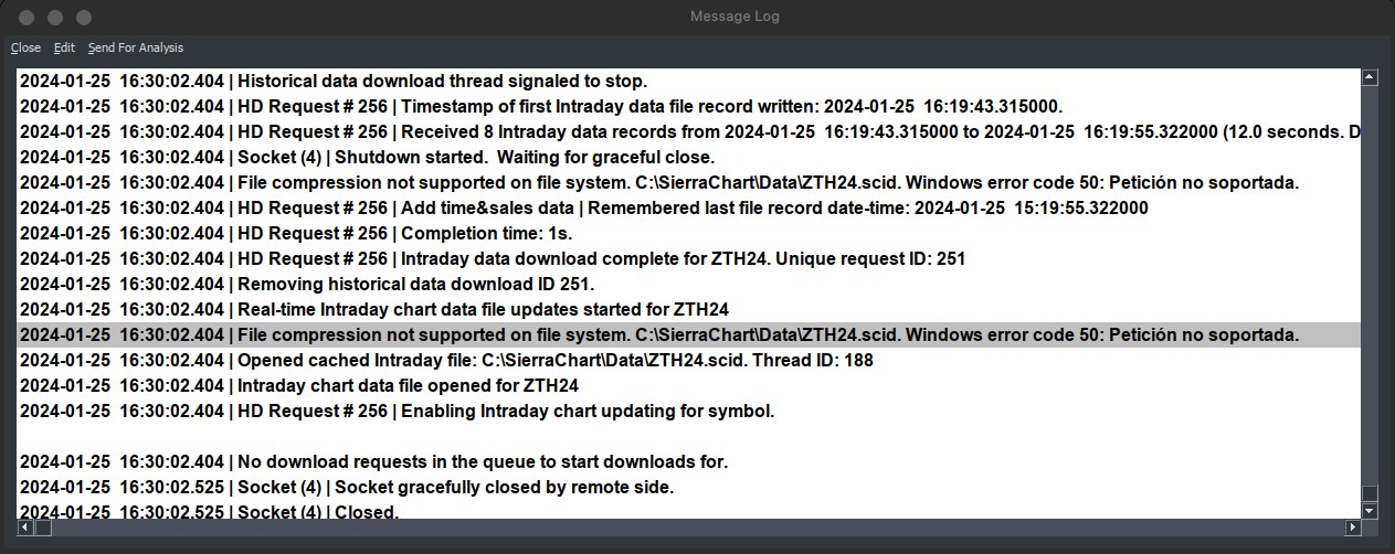

[2024-01-24 16:07:07]
Good afternoon,
I always start the platform without graphics, and once it connects to the data feed, I load the graphics, the problem is that it takes 8 minutes, but now after updating with the zip installer gives me this error, and does not load the platform (image attached).
Hardware:
Lenovo LEGION5 Y540-15IRH
25 GB RAM
2 TB SSD
Software:
Kubuntu 22.04
Plasma 5.27.10
kernel 5.15.0-91-generic (64bits)
Translated with DeepL.com (free version)

[2024-01-25 15:45:05]
Good morning / good afternoon,
thanks for the answer, I have finally started the platform in its latest version 2588, but I have a problem with a chartbook that I made in September 23 (attached chartbook), connected to the server Trading Evalluator - Delayed, the ZN TPO chart does not plot well the European and American sessions (I live in Europe), nor the price scale, before if it did, the TPO charts of ZF and ZT do well, the ES TPO chart either, nor the price, nor the TPO.
The Volume by Prices of the candlestick charts and numbers bars, does not draw them, only a bar, in the DOM chart also, and the price scale does not match the development of the bars.
There is a message line in the Message Log that indicates:
2024-01-25 16:30:02.404 | File compression not supported on file system. C:\SierraChartDataZTH24.scid. Windows error code 50: Request not supported (attached screenshot) Thanks.
imageChartbookFailed1_0124.jpg / V - Attached On 2024-01-25 15:39:50 UTC - Size: 215.04 KB - 295 views
imageChartbookFailed2_0124.jpg / V - Attached On 2024-01-25 15:40:00 UTC - Size: 1.77 MB - 245 views
attachmentChartbookInFailure_ZN.Cht - Attached On 2024-01-25 15:44:40 UTC - Size: 87.05 KB - 372 views
[2024-01-25 17:24:09]
You can ignore the "File Compression" errors. These occur because you are using an emulator.
For the other issues, refer to the following:
