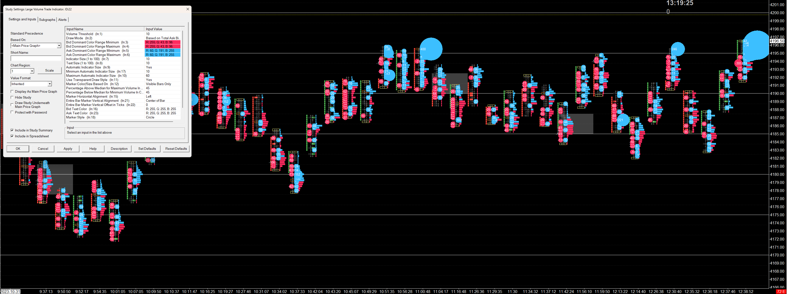

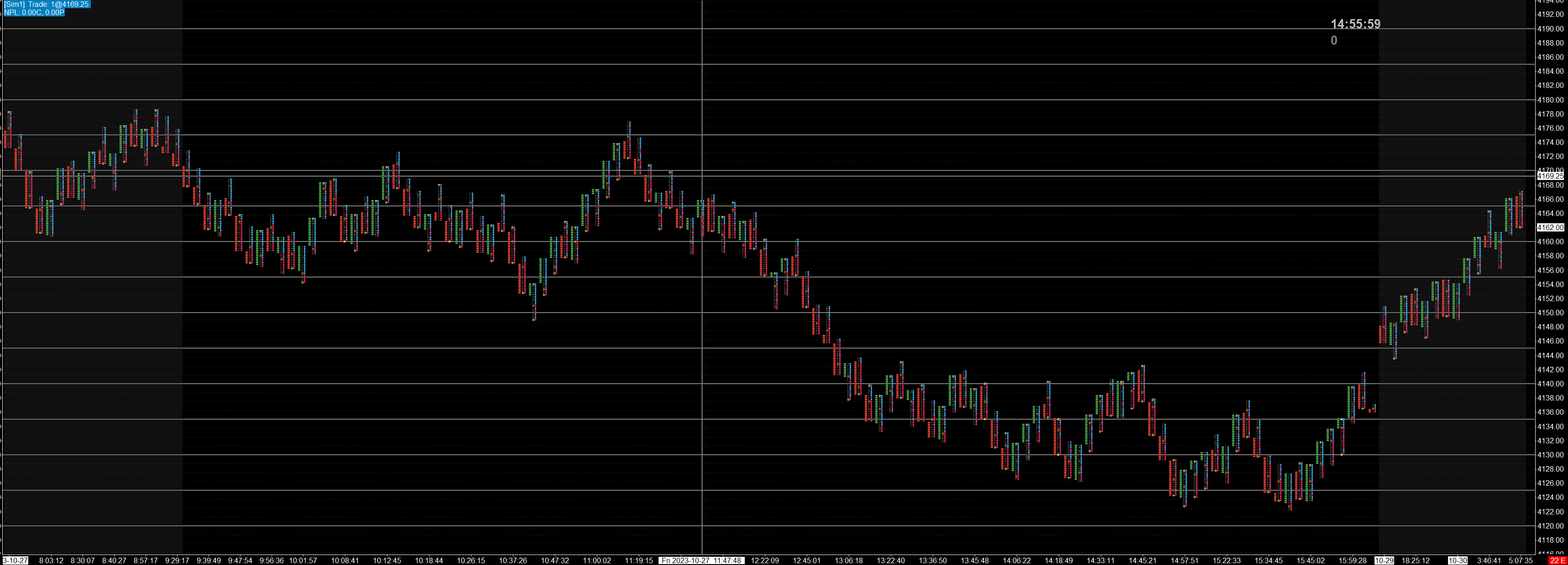

The Large Volume Trade Indicator was working, but then stopped. I've done a fresh install of the study and now nothing publishes historically and after a new bar is published, the previous value disappears. I have check to make sure the Intraday Data Storage Time Unit is set to 1 Tick and deleted and downloaded ESZ3.CME data several time and it will still not work. Please let me know what information is needed for help. I am at a lost. Thanks.

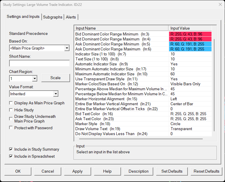

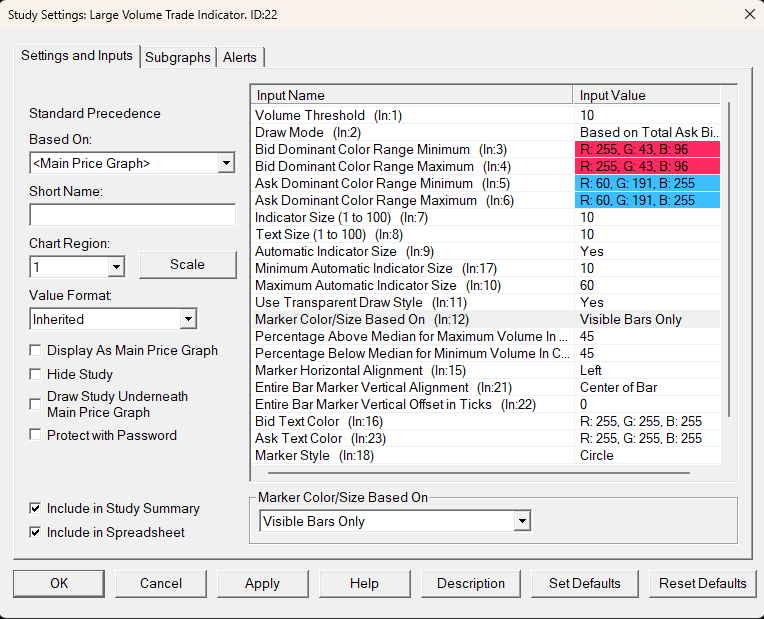

Please set the Input for "Draw Volume Text" to "Transparent" and see if the data is really still displayed or not. We wonder if the Input for "Marker Color/Size Based On" being set to "Visible Bars" is causing the circles to be too small.
[2023-10-31 17:28:21]
moe1up - Posts: 37
I've tried with all my same setting from yesterday and has seemed to have helped with data from today. My chart has been up all day, so more Tick by Tick data has loaded. I still don't have any publishes from before yesterday, but I am going to delete and download data again to see if historic information will publish. Does the study require the chart to remain open in order to publish? I thought it worked for historic information as well.
