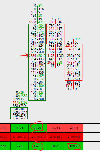

What settings do I need to change for the numbers to be like *k format..as an example instead of 10000 -- simply 10k
Both in cancde volume and at bottom Delta, CD, Volume numbers. Please see attached for the reference.
imageScreenshot 2023-08-28 104554.png / V - Attached On 2023-08-28 17:53:07 UTC - Size: 28.28 KB - 235 views
[2023-08-28 18:09:03]
In the Numbers Bars study there is an Input for "Use Large Volume Number Formatting". Refer to the following:
Numbers Bars: Use Large Volume Number Formatting
For the Numbers Bars Calculated Values, set the "Value Format" to "Large Integer with Suffix". Refer to the following:
Chart Studies: Settings and Inputs Tab >> Value Format
As noted in the above, the shorthand only kicks in with values of 10,000 and above (or -10,000 and below).

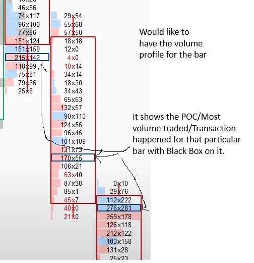

1. What setting should I make to have the volume profile for the bar (Number Bars study)
2. For that particular candle, it shows the POC/Most transaction happened with the black box highlighted.
imagepaint-1.jpg / V - Attached On 2023-08-29 18:04:03 UTC - Size: 70.49 KB - 238 views

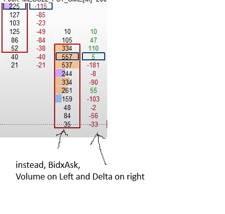

Instead of simply Bid and Ask, I can have total volume on left and Delta on right (Please refer attached pic)
Total number of volume traded at these levels (either Buy or to sell) on Left
Total delta on Right
imagepaint-1.jpg / V - Attached On 2023-08-29 18:12:42 UTC - Size: 33.22 KB - 255 views

1. The profile is a combination of the "Numbers Bars Background Type" and "Numbers Bars Background Coloring". For a standard volume profile (total volume), you would set the following:
- Numbers Bars Background Type: Volume Profile
- Numbers Bars Background Coloring: Based on Volume Percentage
Refer to the information starting here:
Numbers Bars: Numbers Bars Background Types
2. Refer to the following:
Numbers Bars: Highlight Point Of Control In
3. That uses two columns. The first column is set to display the Volume and the second column has the Delta.
When you are on the Settings page for the Numbers Bars you will notice that there are 4 total columns for which you can setup information - 3 "standard" columns and 1 pullback column.
