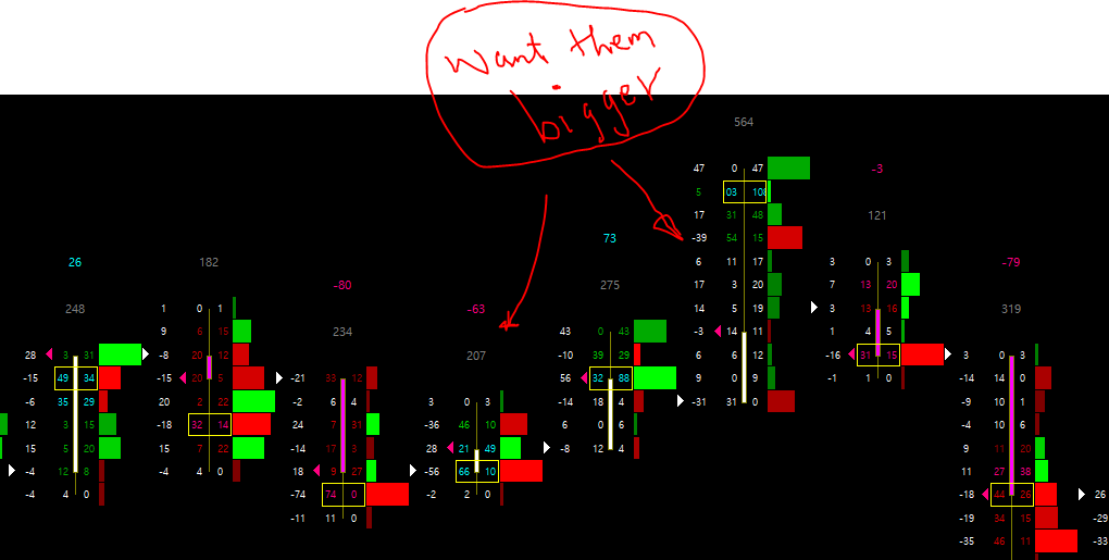

Hi, how can I change the font of the footprint data? Also, I want to increase the font size as they are very small.
imagefont size.PNG / V - Attached On 2023-09-25 22:50:56 UTC - Size: 36.15 KB - 411 views
[2023-09-26 14:33:48]
John - SC Support - Posts: 48658
The actual font that is used (Calibri, Tahoma, etc.) is not changeable just for the Numbers Bars study, you would have to change the Global Text Font that is used to make a change to font for all chart text. Refer to the following:
Graphics Settings: Chart Text
In terms of the size, you can change this with the following Inputs on the Numbers Bars study:
Numbers Bars: Font Size Mode

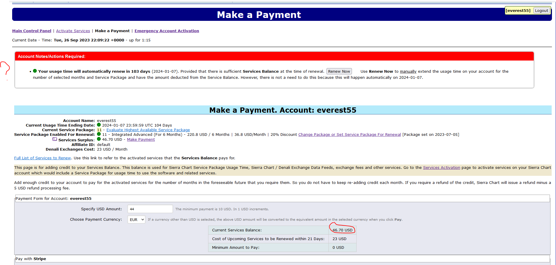

I have enough money to pay for next month and another month but still there is a warning message. I only access to CME currency future and COMEX (GC) which cost 11.5 X 2 = 23 dollor per month and I have more than 46 dollor and still getting warning message. Could you check it out?
Attached screenshot.
imagepayment sierra.PNG / V - Attached On 2023-09-26 22:19:33 UTC - Size: 85.12 KB - 349 views
[2023-09-27 14:19:34]
That is just telling you that you do not have enough funds to renew your package when that time comes (as you are setup for package 11 for 6 months, so the renewal cost is $220.80). But you are 103 days away from needing to renew, so you are fine and you can ignore that message.
