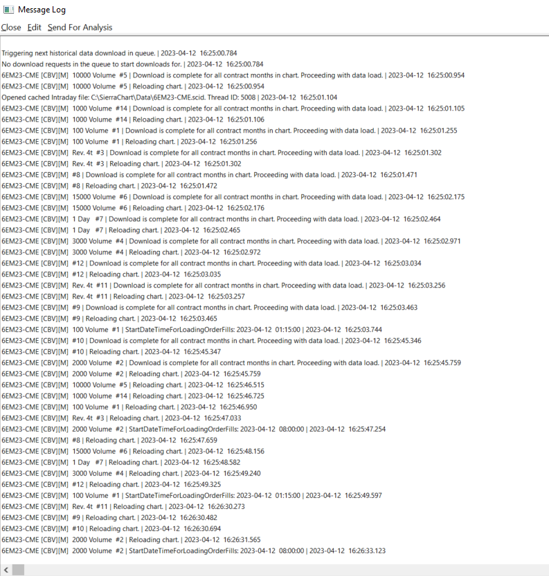

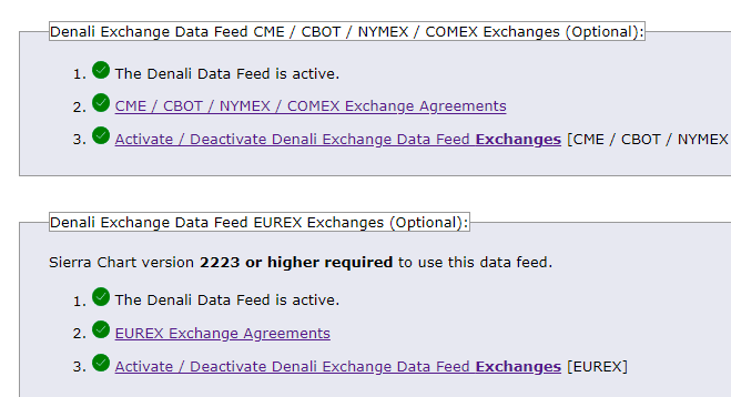

I had all going on my account and suddenly I lost realtime data on CME only. I send attached a view of message log and activated service if needed. EUREX still working.
Thanks in advance for help
Julien
imageACTSERV.png / V - Attached On 2023-04-12 14:32:14 UTC - Size: 27.83 KB - 194 views
imageMESSAGELOG.png / V - Attached On 2023-04-12 14:32:17 UTC - Size: 462.1 KB - 206 views

I have made a connexion with my CQG credentials from my broker. now when I go to Activate Services --> Denali Exchange Data Feed CME / CBOT / NYMEX / COMEX Exchanges (Optional)--> Activate / Deactivate Denali Exchange Data Feed Exchanges [CME / CBOT / NYMEX / COMEX]
And the status of the account under Verify Trading Account is :
Verified Till: 2023-05-13
This thing changed and it solved my delay!
