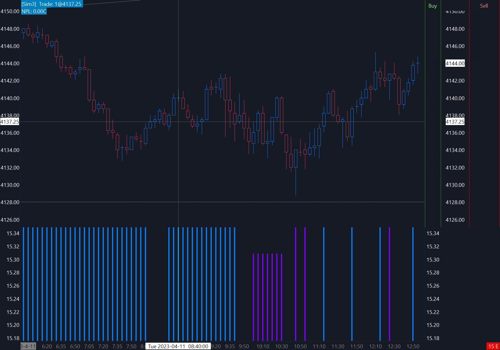

| Techotomy - Posts: 104 |
They are the same values, verified by the both the Tool Values Window and zooming into the tick panel to the hundredth decimal precision (https://www.sierrachart.com/image.php?Image=1681234486128.png). The internals don't match the price action. I've been looking at the SPY almost exclusively every day for about a year. Something is wrong. I've also included an image showing the underlying values for the tick calculation. Those underlying values don't match the graphed calculation (see https://www.sierrachart.com/image.php?Image=1681235555805.png) |
| [2023-04-11 20:49:16] |
| John - SC Support - Posts: 48527 |
That is the overnight session, for which the Market Statistics do not have any information. Since you are putting this on a chart that does have data, it looks like it is extrapolating the information from the close to the next open in order to show bars during that time.

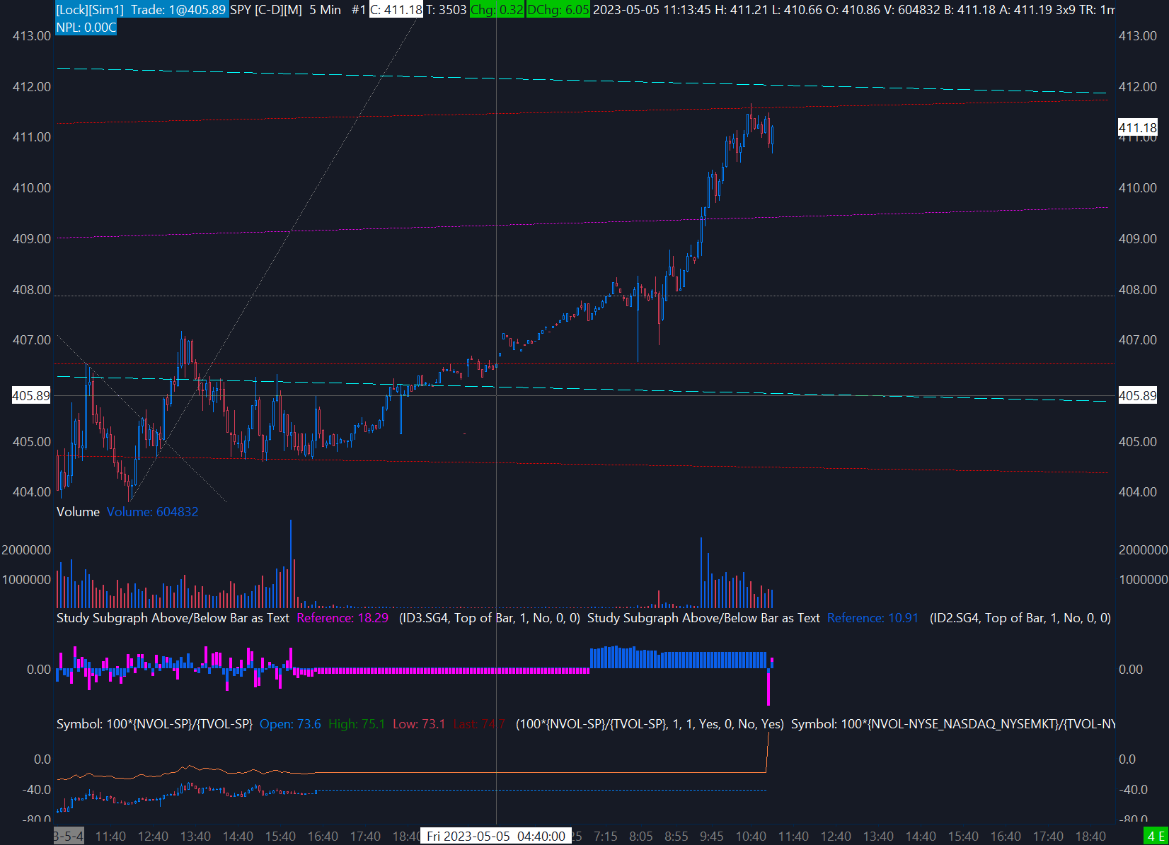

I upgraded another instance of SC from the old version to 2497 revision 45800 and the same flat lining is happening to the data (see https://www.sierrachart.com/image.php?Image=1683299627346.png) whereas it didn't happen before in the older version. The upgrade also changed my settings, such that the Download Historical for Formula Symbol was changed from Yes to No. I would be surprised if this is not reproducible on your side it has been reproducible on my side.
| [2023-05-08 19:44:08] |
| Sierra_Chart Engineering - Posts: 25424 |
Yes this is definitely going to be the case: The upgrade also changed my settings, such that the Download Historical for Formula Symbol was changed from Yes to No.

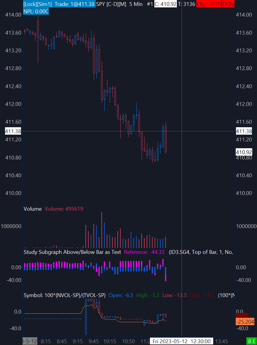

Here is some more flat lined data that occurred today (see https://www.sierrachart.com/image.php?Image=1683907410883.png). I deleted all data and downloaded, then reloaded and recalculated, but it is still there. I believe the flat lining occurred when my computer was sleeping. How do I fix this?
| [2023-05-12 16:59:21] |
No, this is not relevant: Did you implement the algorithm in Version 2417 Revision 42894 and then update to 2491 Revision 45597?
This is not relevant and we have run it an entire day without an issue: Also, you are looking at a different time frame and at a different time with different symbols. I
Why should it definitely be the case. Shouldn't the update retain my prior settings? Yes, and 99.9999% of the time this is the case. This particular setting among thousands and thousands of settings in Sierra Chart, had the default changed because of the downloading of historical data for custom symbols is very time-consuming and by default this has been turned off. Due to how Symbol Settings are saved, since the default changed, it may very well have changed the state of this particular setting for existing custom formula symbols.No, this is not the case at all: If this is case, then I'd need to redo my entire setup every time there is an update because it will have been compromised.
This is a very isolated specific one time case, to ensure less issues with custom calculated symbols.We have not been able to reproduce the problem. I believe the flat lining occurred when my computer was sleeping Therefore this is the problem. We will make sure there is no historical data downloading problem upon a reconnect to the data feed.
